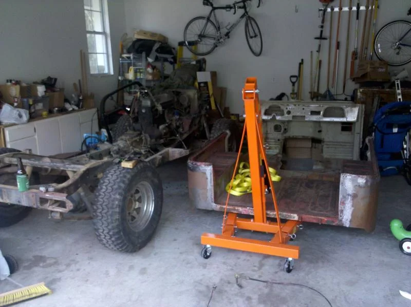

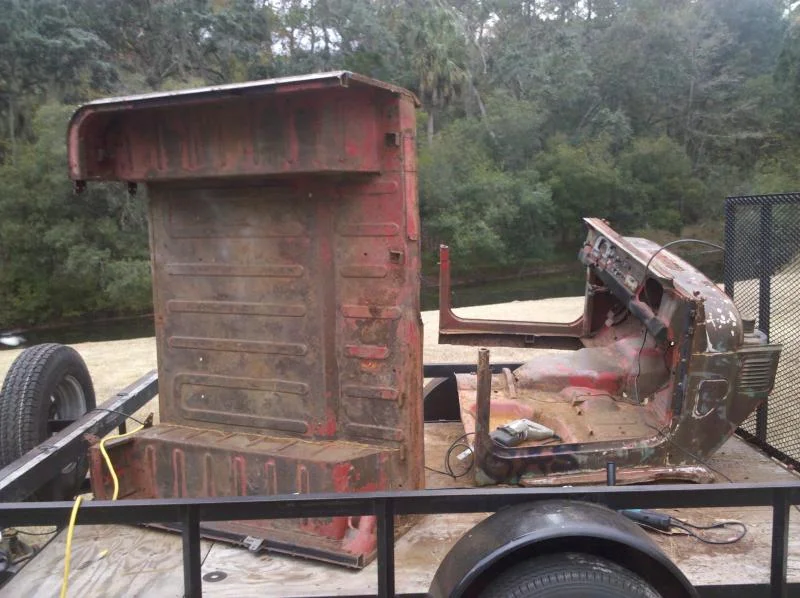

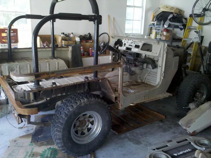

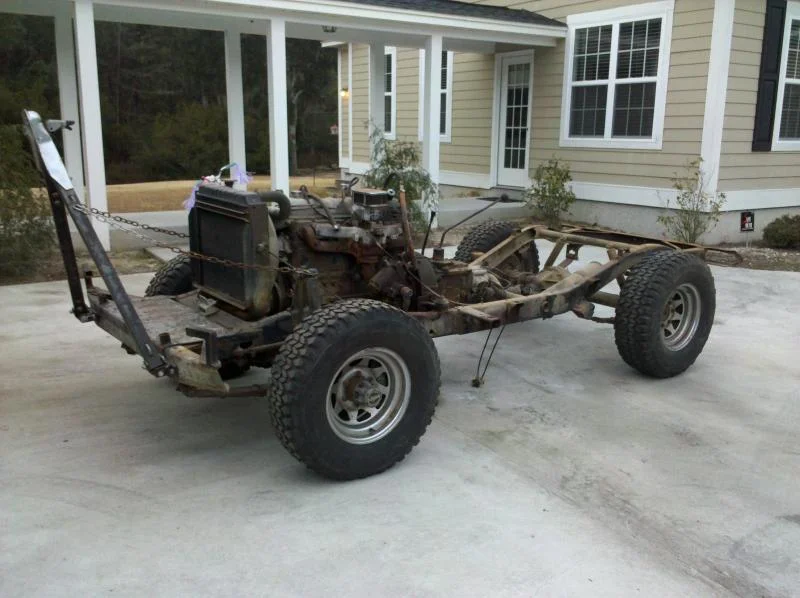

I've finally gotten my priorities straight and started on the 40 I bought this summer. I'm starting with an all original '76 with 80k miles and all ancillary pieces (top, doors, seats, gauges, etc.). The PO started the resto and had to abort, so I picked it up cheap. Here's what I'm starting with:
The good thing is he had just purchased all new sheet metal from CCOT - floor, quarters and sill. Bad news is he didn't brace anything before tearing into the rear tub. I wasn't sure how to tackle this and considered buying a new 1/2 tub but couldn't justify the expense. So when this '70 appeared in a junk yard, I drove 5 hours, spent another 5 pulling it off the frame and drove it home :)
Dusted off the sawzall and got to work:

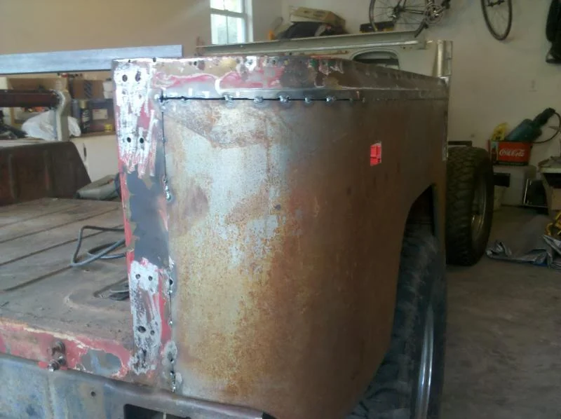

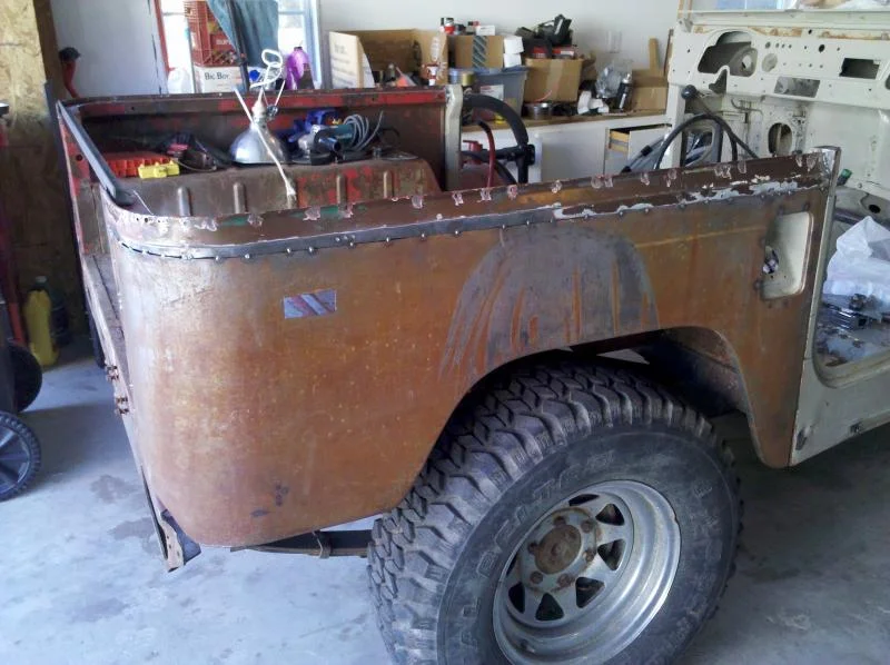

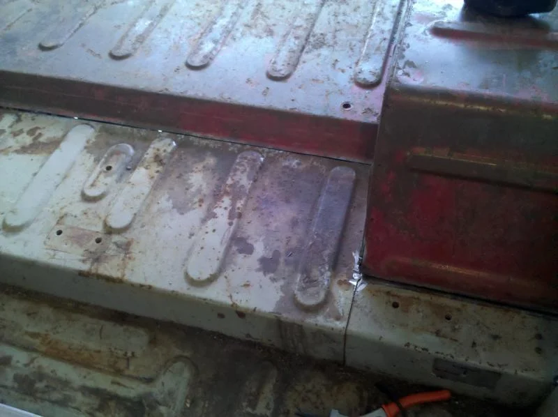

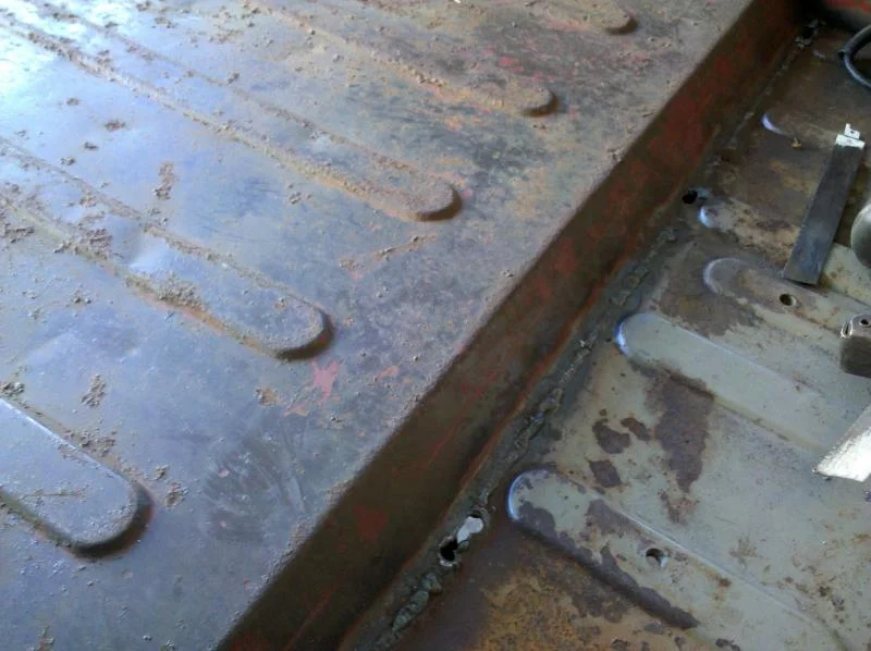

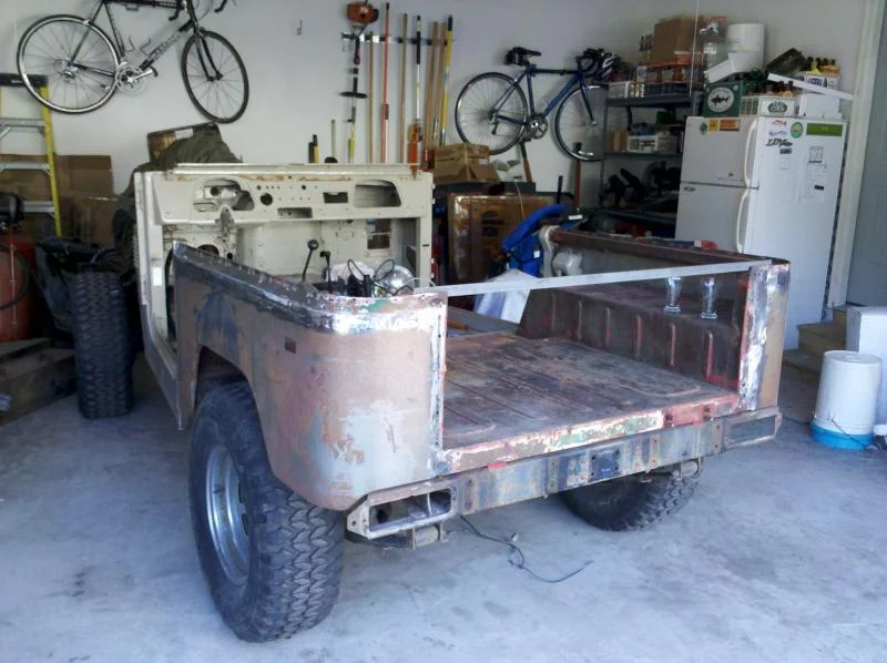

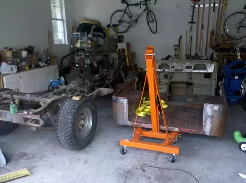

The main support tube on the '70 tub was rusted through, and since I wanted to keep the correct nutserts for the later seats, I decided to separate the tub at the wheel well seams and cut right before the sloping section of the floor:
Like Buttah!
I'm thrilled with how much time/money I saved by swapping out the rear :bounce: Right now I'm working on replacing the rear quarters. I've got the pass side cut out and am working on putting in the wheel well support channels. I'm trying to do this on the cheap, which is hard to do after seeing all the great looking rigs on here. This is all new ground for me - I've never worked with metal or welded, but man is it fun! I'm on the fence right now - either do a full frame off, or just pull the body, fix and paint and then throw it back together. The frame is in good shape, but could definitely use a blast and repaint. :hmm:

Take your time welding them back together. To much heat will warp the panels. That is a killer deal you got that body and you making them together looks awesome. Looks like it will turn out great.

How are you going to weld the two back together?? I have a idea! Let me know if you are interested?

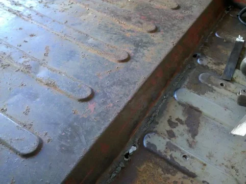

Well, I did some of the welding already, but I'm all ears! I welded the corners of the wheel wells to the floor like the factory did to stabalize everything, then I butt welded the floor seam.
No doubt! Definitely a learning curve. I layed down a series of spot welds before I did any continuous welding to cut down on warping. I just subscribed to your build up thread - almost exactly what I want to do with mine. :cheers:

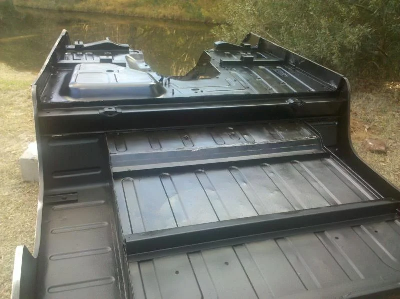

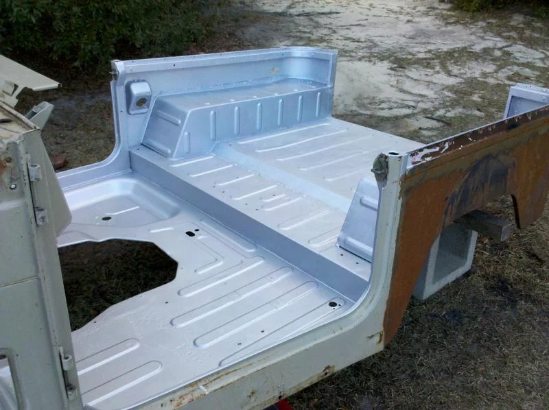

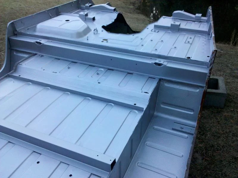

Got the underbody painted. A few hours with the wire wheel and a quick degrease before applying 2 coats of MasterSeries silver. Cjgoode used it with good results on his build https://forum.ih8mud.com/40-55-series-tech/354516-cjs-1962-fj40-build.html , so I gave it a shot. Reasonably priced and coated really well. It cures via exposure to moisture, so it took a few hours for each coat to dry since it wasn't humid (for once). Underbody 1.jpg

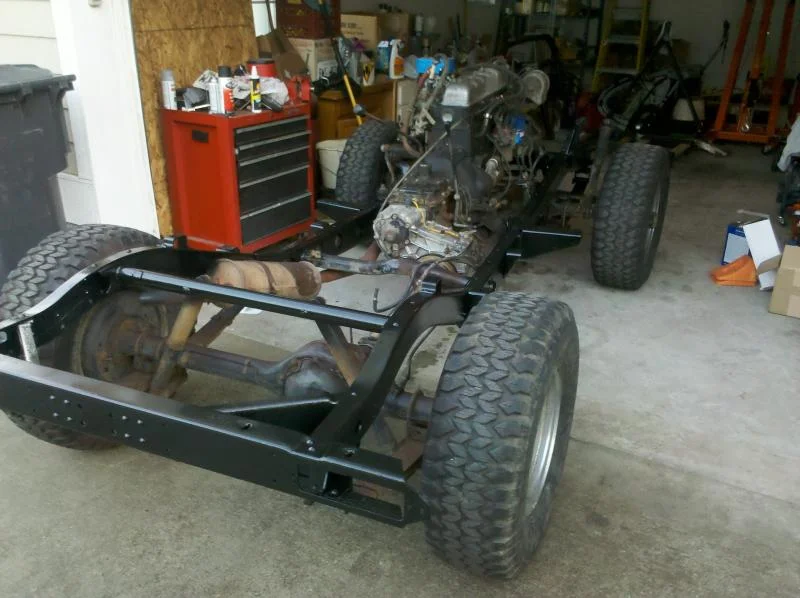

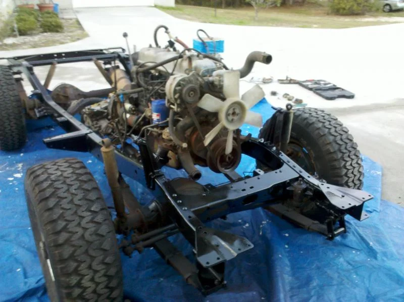

I sprayed the underbody with Rustoleum underbody rubberized paint (rattle can) -not too impressed, but it was cheap and it's paintable if I want to paint it the same color as the body. Also spent some time pressure washing and wire wheeling the frame. I sprayed Rustoleum primer and Rustoleum Professional gloss black (again, rattle can). Very happy with the results. I'm trying to get this thing on the road ASAP without spending much money, so I couldn't justify pulling the frame off. Maybe in a few years when I have time/money. All in all, a productive weekend. :)

looks awesome keep it up! i personally love rustoleom professional black.. it holds up extremely well. the red rustoleom primer holds up just as well - though they both seem to take a week or two to cure.

thanks man- you're right about the cure time. going on a week now and it's a much harder finish. pretty cool stuff for the money.

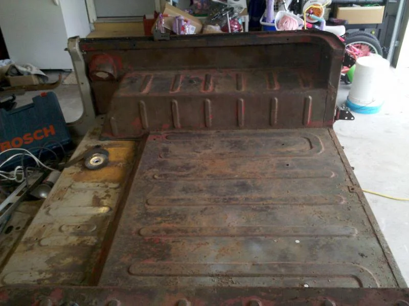

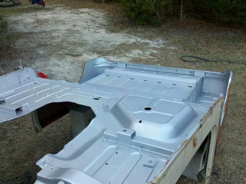

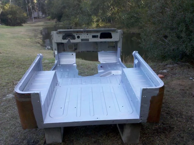

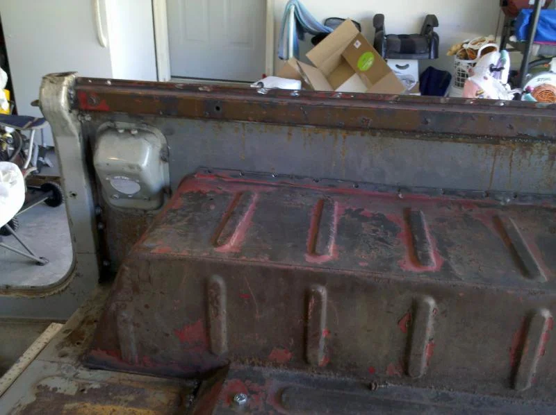

thanks mattcamp - getting a little burned out, but trying to get this thing wrapped up. More progress today on the tub:
