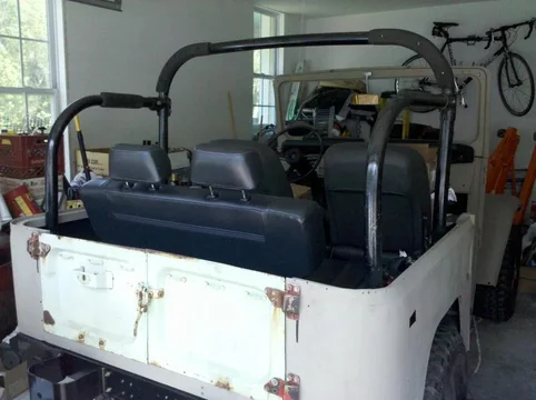

rear bench installed
got the CCOT rear bench/seatbelts and roll bar installed. the jump seats definitely looked better, but the bench seat will be much better for the kids. still need to get the front seatbelts mounted, refinish the barn doors, install the hood, headlights and tailights and then I'm ready for the road!

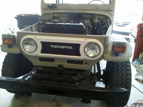

got front bib, lights and tailights installed/working. maybe people will stop calling this a Jeep now...
It just isn't gonna happen. No more than consumers are going to stop calling facial tissues "Kleenex." Jeep has become the generic term for off road vehicles. From CRV's to Samurai's I've heard them all called Jeeps. I still enjoy having fun with my friends and even my kids by pointing out that Jeep is a "four letter word."
