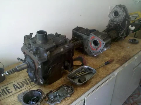

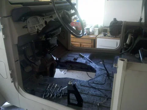

Thanks John. I hadn't posted for a while since my transfer case blew up ( https://forum.ih8mud.com/40-55-series-tech/507788-cracked-t-case-fail.html ). Bodean was kind enough to ship me his old t-case and t-case saver since he upgraded to an Orion. I tried getting the old transfer out from under the vehicle, but I couldn't get it out that way (and if I had, there's no way I would have gotten it back on without buggering up the new gasket). So, I took out the freshly installed interior, gas tank and tranny hump. :doh:
The donor case was from a '78, so most of the external parts swapped right over. The only real differences I saw were the additional reinforcing ribs stamped into the newer case (presumably to make it stronger?) and the front output shaft is fine spline on the newer cases and course on the older ones. After sourcing a newer output flange, I replaced all seals/gaskets for the transfer case. I did the same for the transmission since it was out.
I used an engine hoist to support the tranny/transfer assembly. I fought with it the better part of an afternoon trying to get it to mate up the last 1/2" or so. I finally went and bought longer bolts to get it closer and then installed the stock bolts. What a pain.
I'm happy to report that the 40 is driving better than ever. Maybe the best part is having a parking brake again. Now I don't need to carry wheel chocks with me! :cheers:

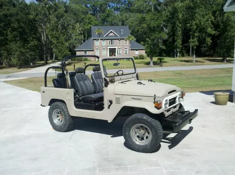

It's been a while since I've posted any updates, so here goes:
Finally got the rear drums working. All four cylinders and adjusters were frozen, so I pulled them all, polished up the pistons and put anti-seize on the adjuster threads - brakes work like a charm! I was considering rear discs, but free is better ;).
My starter was on the way out, so I replaced it with a GR starter from a local auto parts store. I'm very happy with the upgrade - much lighter, smaller and it was cheap to boot.

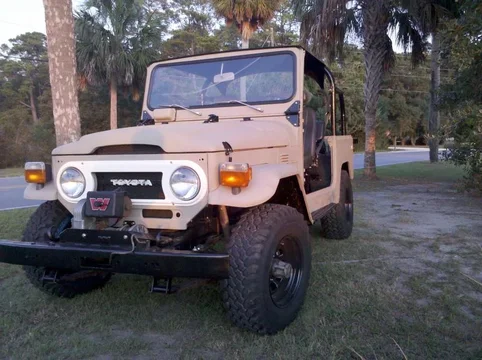

Got the running boards on. Was considering sliders, but those will have to wait for now.
Last but not least, I installed the Warn 8274 I just bought. It's by far the coolest thing on the cruiser, and it's kind of the icing on the cake for me. The wire rope is shot, so I'll be replacing with Amsteel courtesy of Southeast Overland.
EDIT: Forgot to mention the OCD canvas top - very happy with it, although I am one of the random lucky ones who got mine 2 months after paying...
And, since this thread is worthless without pics....

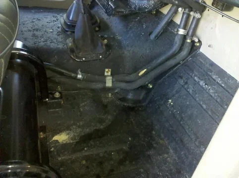

Rear Heater
With the temperature finally starting to drop, I figured I'd recondition my rear heater. Took it apart and painted to match the rest of the interior. I was able to reuse most of the hard line - only had to replace a small crimped section with heater hose. Works great, although with the top down, it's not all that effective!
rear heater cont...
The heater is so close to the stock center console that the heater hose doesn't have a smooth transition. It doesn't seem to be affecting performance, just doesn't look right. Is that normal? Can you run a rear heater with a tuffy console?
I only had access to an old crappy picture of my rear heater. But, you can see how the core is oriented in the housing. If you can rotate yours slighlty, it should keep the hoses from kinking so much.
