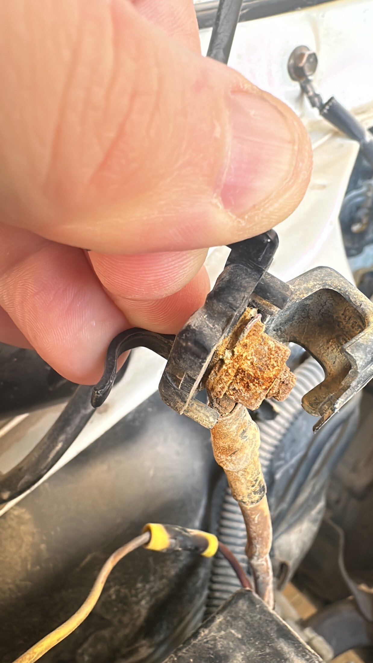

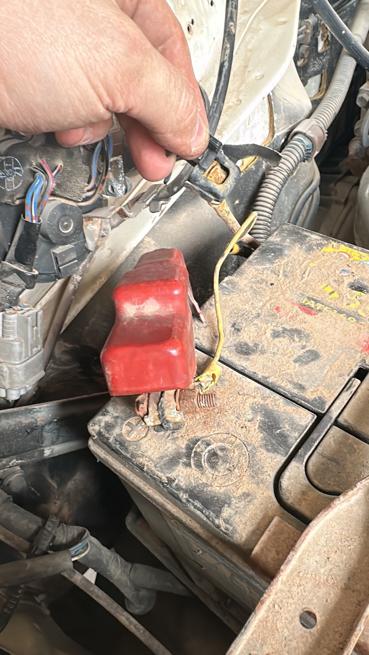

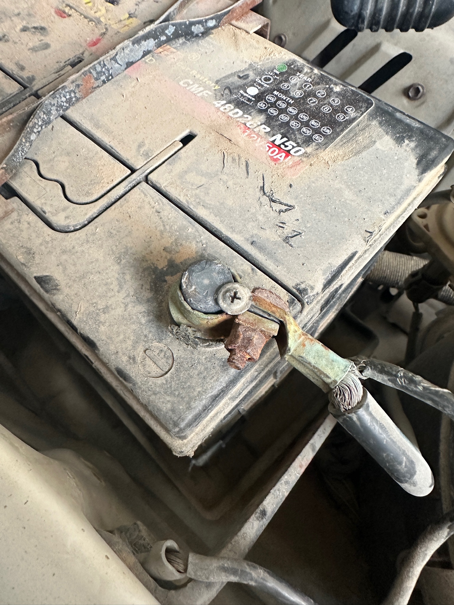

Folks, I am in search of a photo, and possibly wiring description of installed fusible link PN 82627-60070. I’m not super smart on these, but am confident that I can follow directions.
I am nearly certain the PO hacked out and replaced the fusible link on my FZJ70 with a piece of wire only, and I would like to resolve this if my supposition is correct, with a replacement from @ToyotaMatt.
I’m just not sure how much was hacked away, if i need to replace a an OEM plug, or what. The thicker wire was originally attached to the positive terminal with a corroded ring that snapped off and I replaced, just to get it running again.
Here is what I’m working with, with bonus shot of OEM ground retention screw.
Yes, new battery, terminals, etc. are on the way…
That odd black plastic housing was what I had on mine.
I believe it to be Factory.

That plastic box is factory. There should also be a connector on the wiring harness.
The OEM fusible link (the replaceable part) has several links in it. One has a ring terminal that connects to that plastic box (which should have a cover on it and a lot less rust inside) as well as a mating connector to plug into wiring harness.

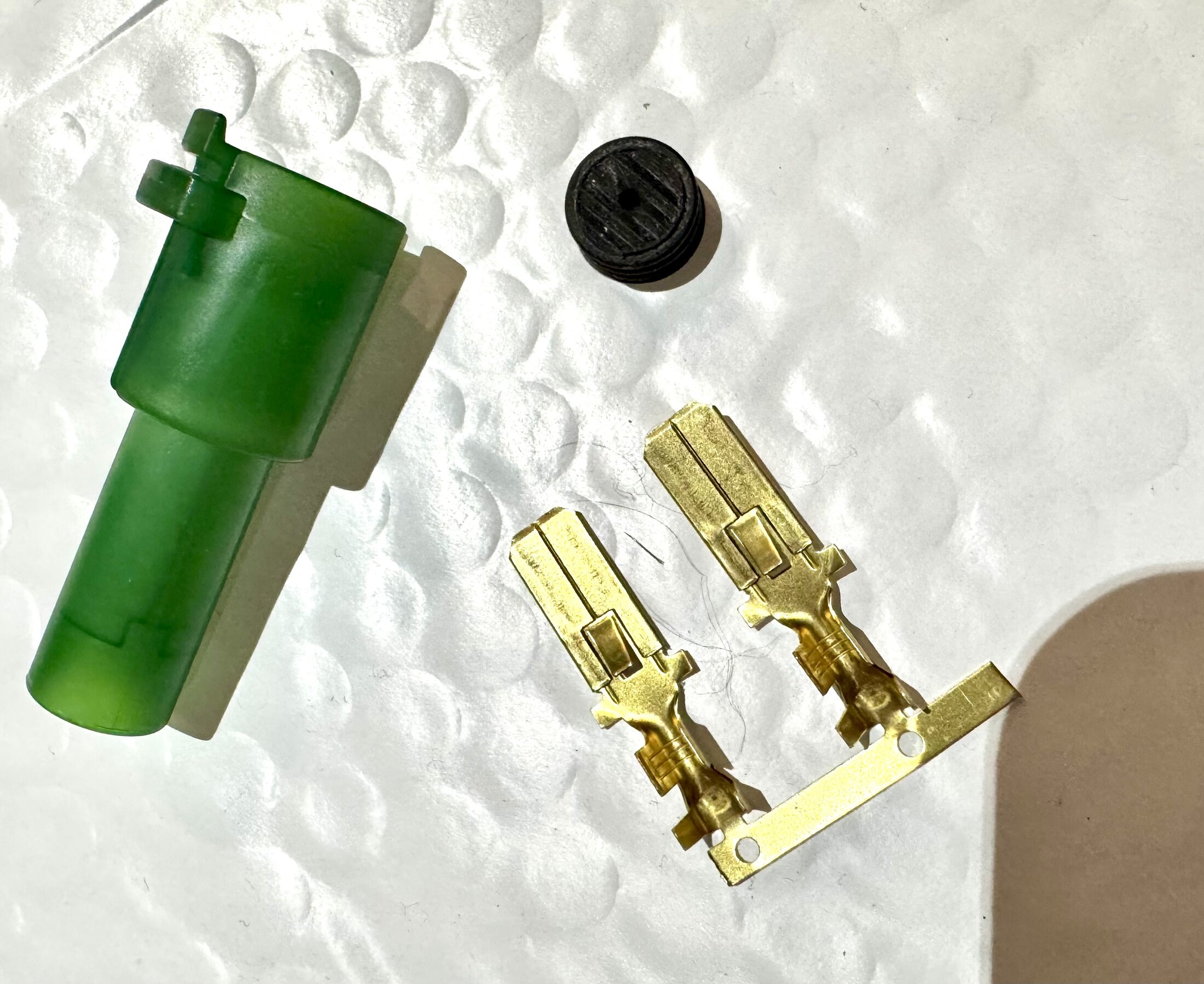

as of the new year , most of fusible links kits will now include the OEM Japan Spec. Toyota Harness side connector plugs , and extra brass / tin-plated terminals
i have NOT had the time to update ALL store photos yet and the text description / words of the fusible links kits revised updated added kit contents
but , in the case of the
82627-60070 , the added additional harness side electrical parts apply ...
see below pics ...
also ,
i now offer a solution for the now disc. / NLA black box w/ 1 stud
this is a OEM YAZAKI japan spec. part that will now take the place of it ....

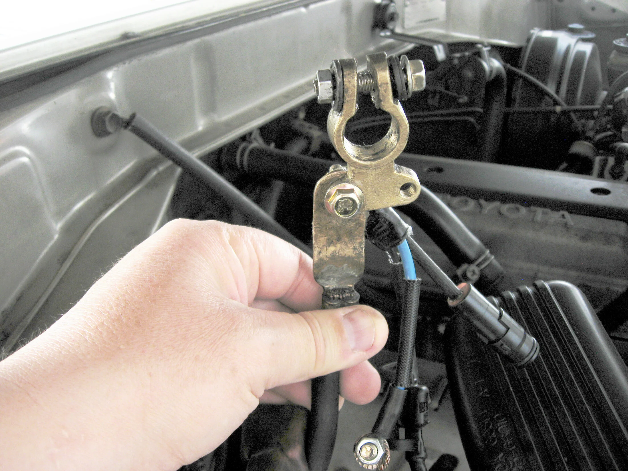

Hello,
Apparently, POs have a thing when it comes to getting rid of fusible links.
1FZ engine fusible links are long gone. As you already know, Matt / @ToyotaMatt makes a replacement.
The box you have is OEM.
This is how installed fusible links look in a 70 Series truck with a 1FZ engine.
You may also want to replace the positive battery terminal, as well as the negative. The latter is available as a terminal/ground cable assembly.
Juan

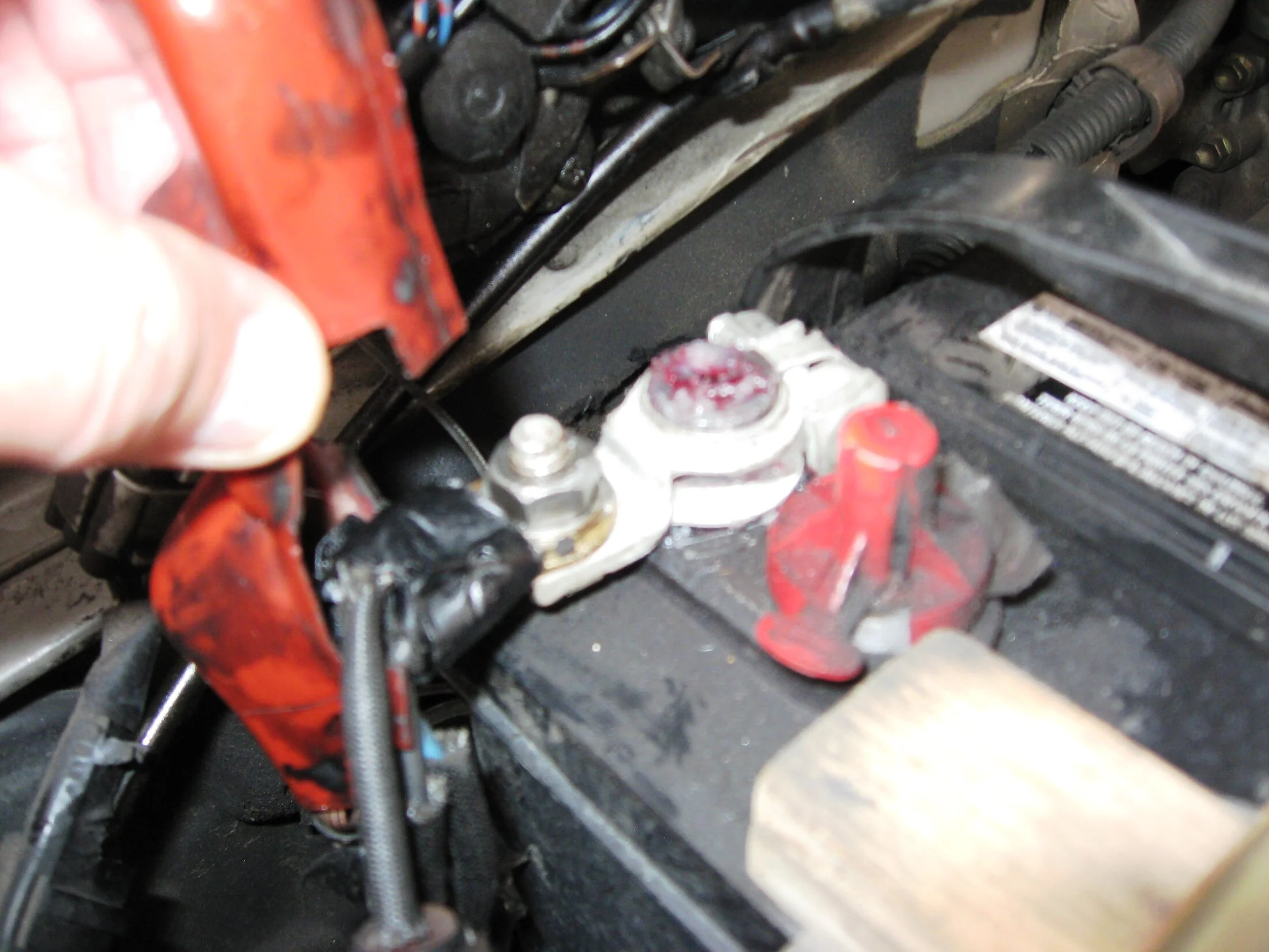

Hello,
The negative terminal looks OEM but from a different vehicle.
I only have a picture of the positive terminal. By the way, this terminal is OEM.
Hope this helps.
Juan

Thanks for all this! I do believe @ToyotaMatt has the right fusible links, as well as the harness side female connectors, and replacements for the black junction box, so I should be good to go on parts, thankfully.
My remaining challenge is trying to figure out where the female, harness side plug is supposed to be wired in on my truck, because I think the PO cut it out. If anyone has clear pics of the connection points, would love to see them.
This will be among my first tasks when I get my truck back from the shop in couple weeks.
Thanks all!
Per the FSM it is a red wire, for the headlights. Probably a 16g wire. It'll be part of the bundle coming down the fender from the firewall. The PO may have spliced a different color onto it so you might have to follow the harness back a bit to find it.
