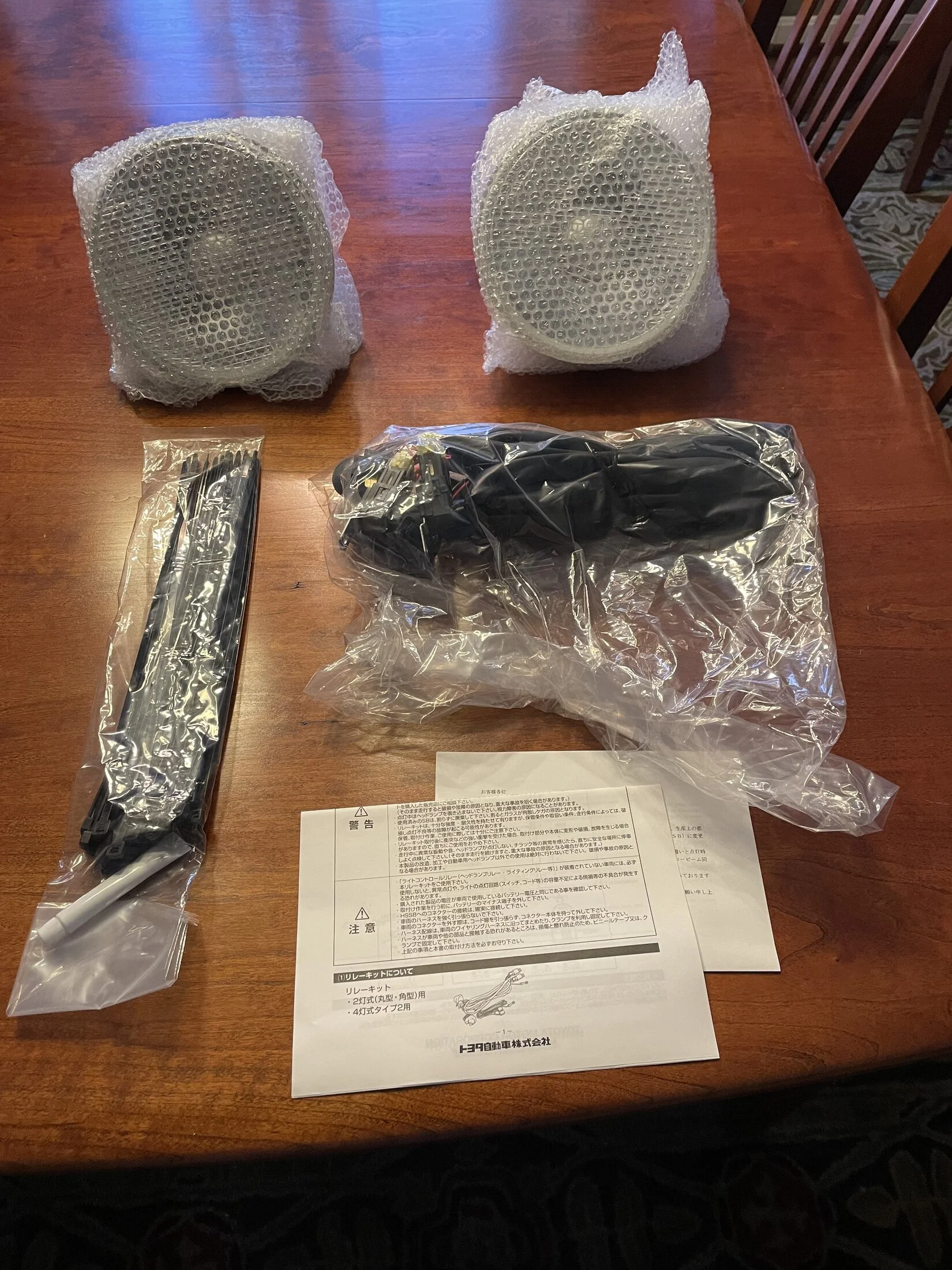

This is Toyota’s conversion kit including glass housings, 12V halogen bulbs, relays, wiring harness, and zip ties for the low, low price of ~$20. I'm going to switch to 24V bulbs and use this on the BJ. The parts guy at Warrenton Toyota couldn't believe the price on this kit.
Crazy! It’s like someone forgot to add a zero in there.
UPDATE - I went to install the new lights today only to find the halogen conversion had already been done on the BJ. I can bring this kit to the Fall Crawl if anyone is interested - $18, otherwise it will go bak to Toyota.

So in that part number box it comes with two lights?
Good to know, I just ordered a few sets.
Was wondering if these would perform better than Round Eye halogen 55/60w H4's I am running. I am just started to look for brighten headlights.
The kit includes 70/75w bulbs.
