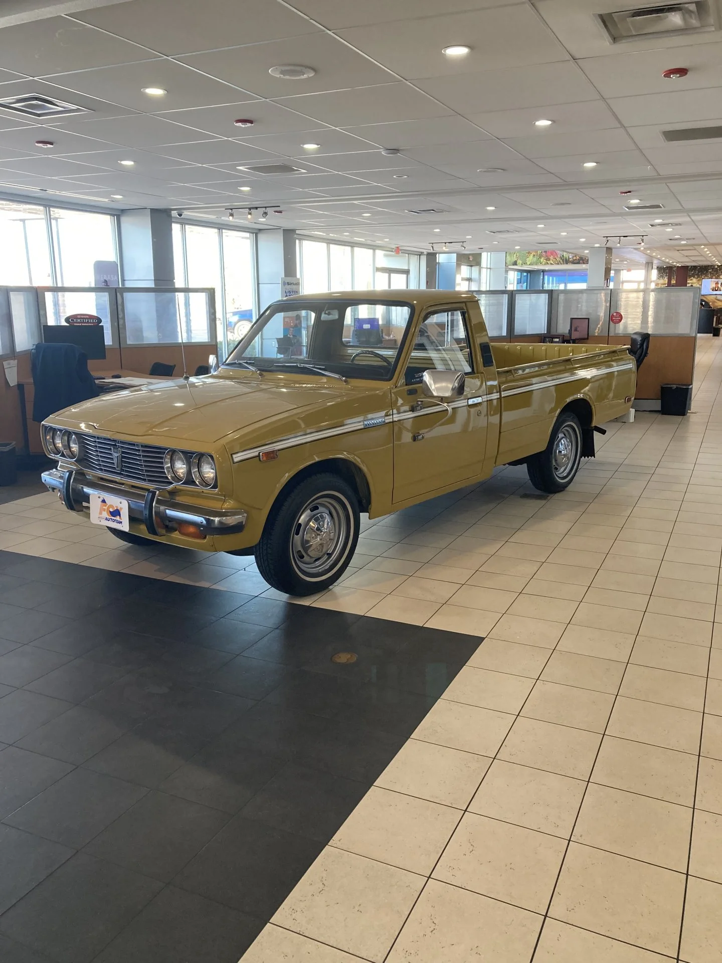

Time for another build :D Introducing my new 1978 Toyota Hilux I just picked up!
attachFull706828
It is a quality unit with no engine, or bed... For real though, it was $300, has very little rust (mainly some surface rust on the frame) and came with a title. Dude had to hack off the middle of the bed for another truck he had, so good chance I can get the bedsides later. The lack of engine actually makes my life easier.
Story time and plans: I've been looking for an old (pre-80s) Japanese car or truck for awhile and haven't found anything at a reasonable price. I've never built (or even owned) what I would call a "street vehicle". Everything has been oriented and capable of offroading, and since I've started building engines for my buggy I wanted to get a little car or truck and put gobs of power into it. I think (and hope) this should be a lot easier than the buggy build. I can drop an engine in, tweak on stuff here and there, upgrade it and have it running and driving most of the journey. Building off of anything is much easier than the ground up!
I found the Hilux on Saturday, bought it Sunday (yesterday).

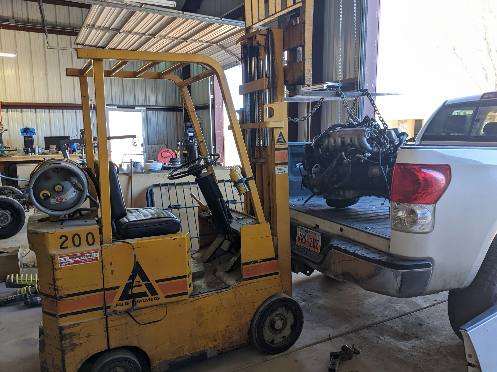

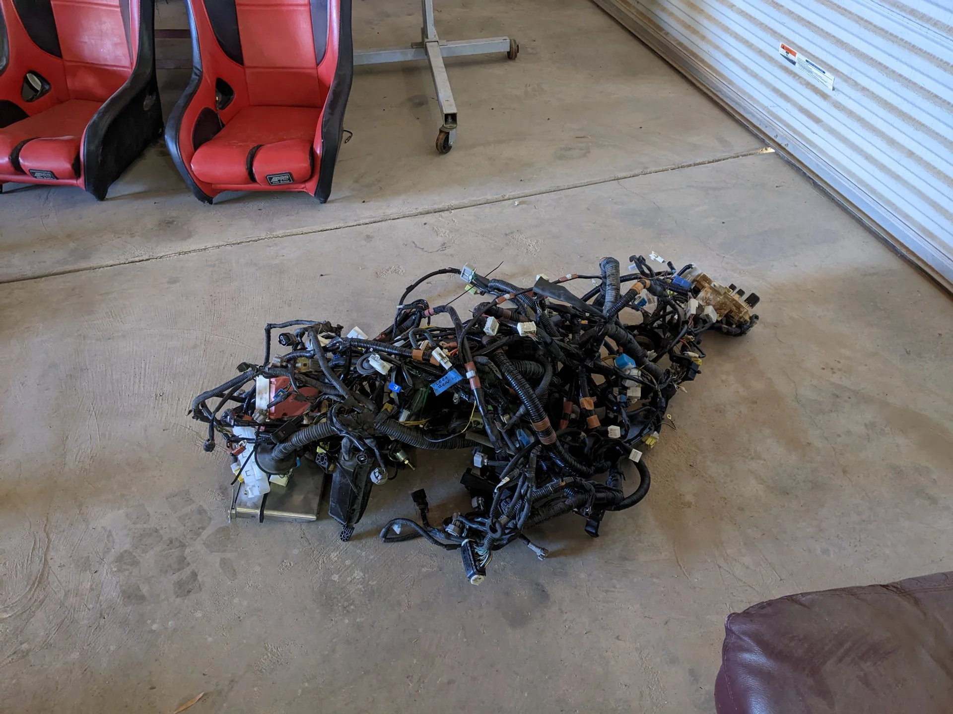

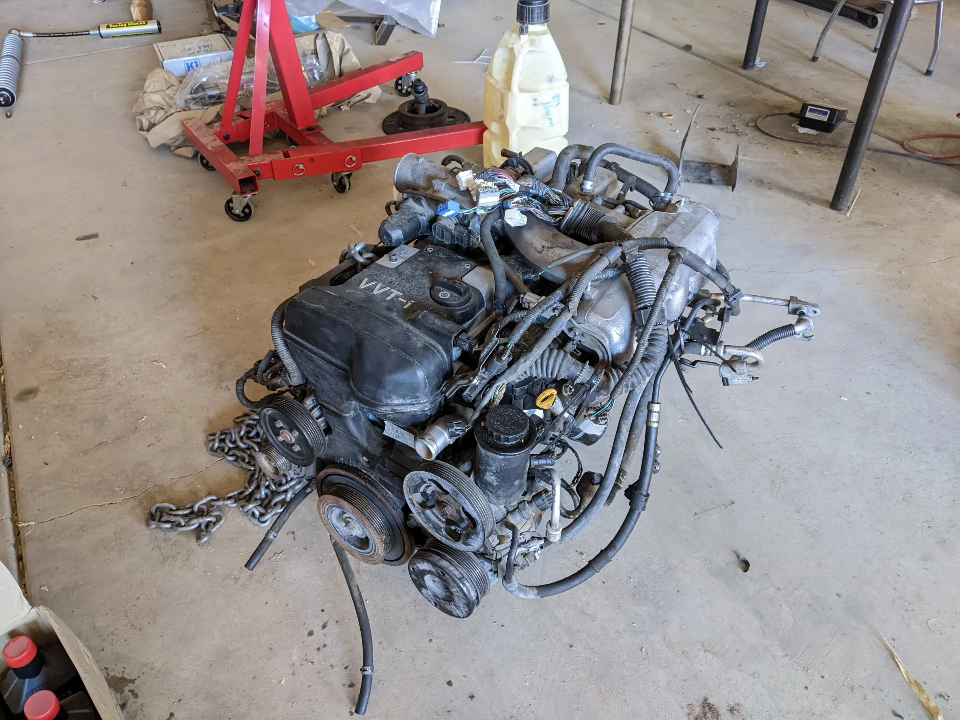

Picked it up this morning! $1000! 2JZ out of an IS300, with full harness and a bell housing :D
This is a naturally aspirated VVTI model, so a few minor changes between it and a turbo model, biggest being a 10:1 compression vs 8.5:1 so I'll have to swap out the rods and pistons, otherwise it'll make 1000hp! I also bought a CD009 off of eBay which is a Nissan 350Z 6 speed manual trans and with an adapter plate will work with the 2JZ.

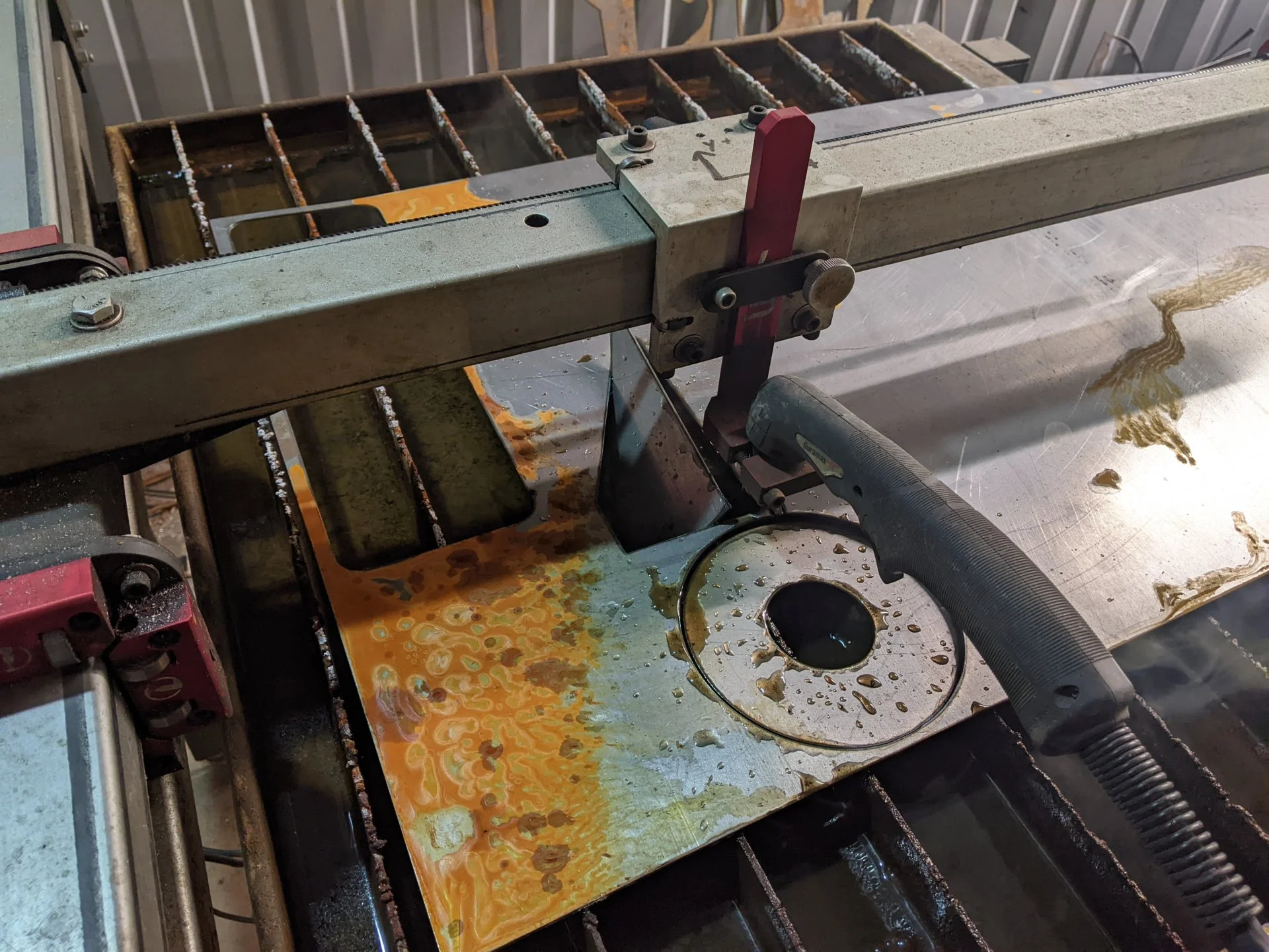

And out with the plasma!
attachFull723480
attachFull723484

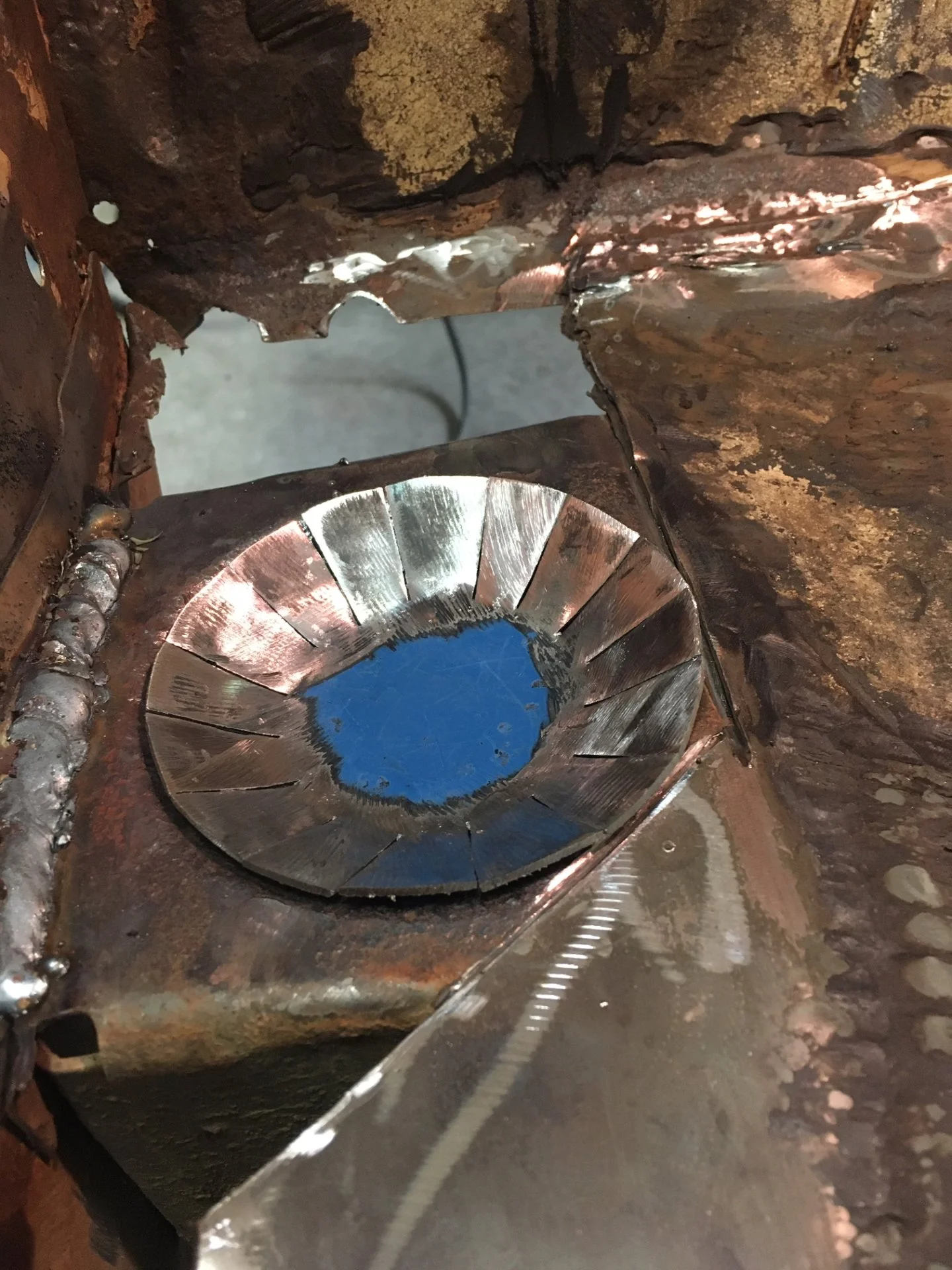

I have some random sheet of steel in the corner, maybe 16ga? My plan is to cut out overlays and place them on the inside, with the primary intent to weld the sheet metal from the bottom of the truck to the overlay so there's no gap for water to get in. If there's the option to weld on the inside of the cab great, but not a big deal. As for that circular part where the body mount is, I'm debating what to do, sitting here I'm thinking cut out an overlay with a hole and dimple die it, and if there's more depth needed than the dimple provides then weld a little tube section in that will be welded to the rusted part.
All I got around to was starting on the big section. Measured everything, drew up in CAD, cut on the table, and a little hammer work later:
attachFull723481
I decided to weld the top side since it's easier to access and afterwards will go to the bottom and weld the body to the bottom of the overlay plate. Old plate vs starting to weld the overlay in:
attachFull723483

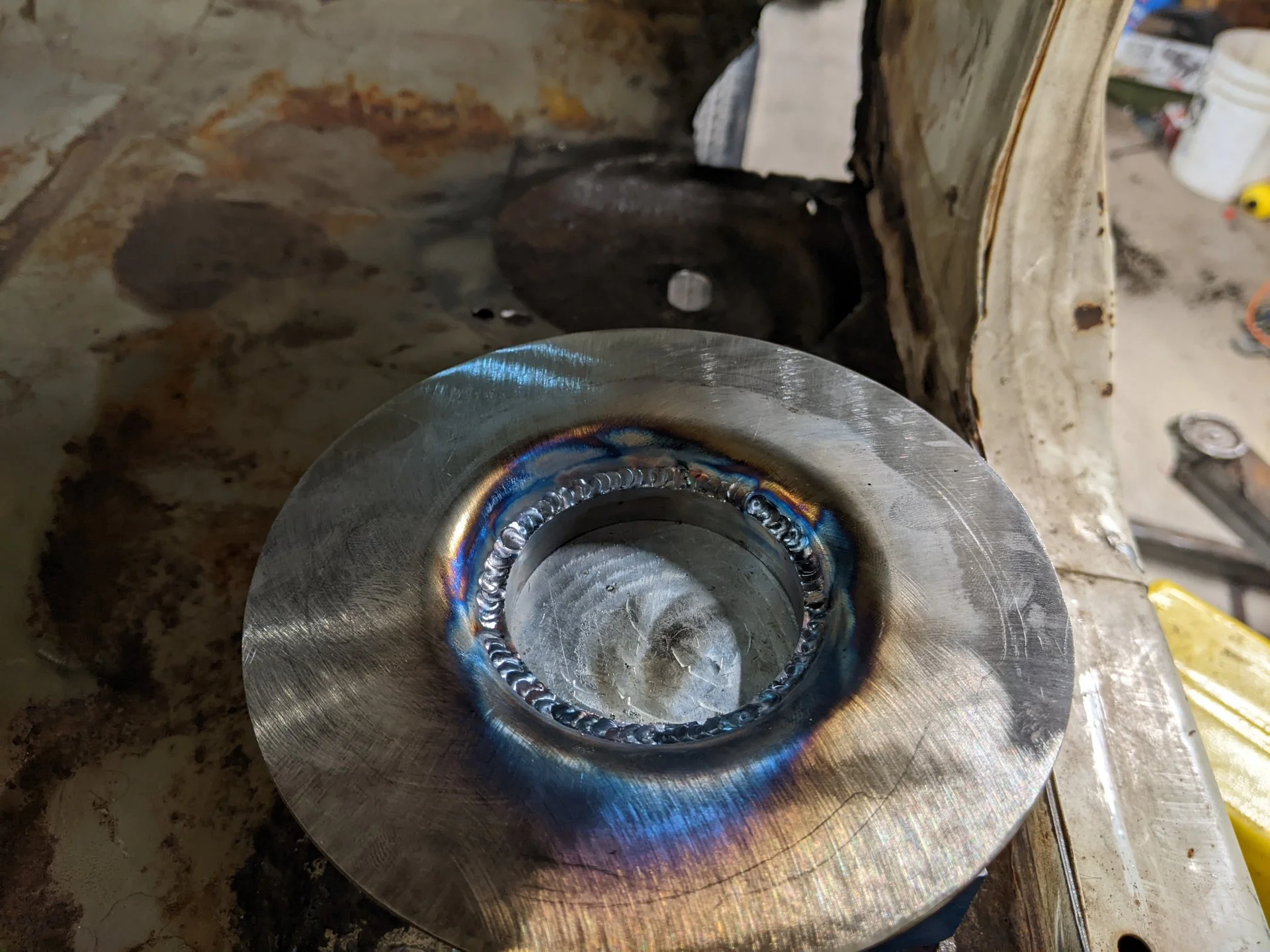

And an awesome picture of a weld, I still need practice to get a consistent puddle. I remember in college tubbing the firewall on my 4Runner and trying to do it with the MIG I had, the TIG is always amazingly nicer to weld sheet metal!
attachFull723482
And that is the extent of "updates" :D I have everything on order for the engine and trans to work together so the only drivetrain components I'm really missing is a fuel system and radiator. I'm also looking at running a Bosch electronic booster, superfastmatt on youtube has a good video on it; they can be found on a lot of newer vehicles and only need 12V to create boost and looks the same size or smaller than the stock booster. I'm thinking there's a good chance of the truck driving with the stock 2JZ in May, and then it'll be time to start modifying things!

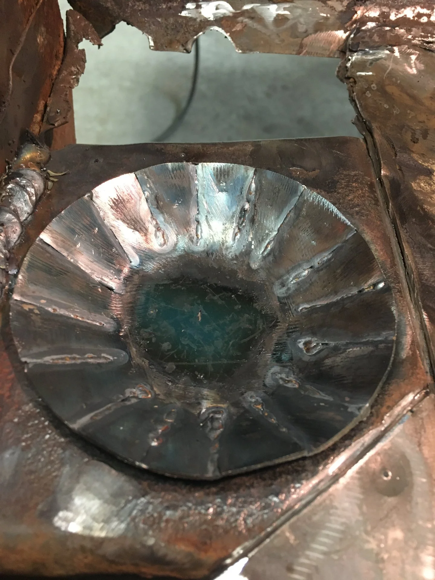

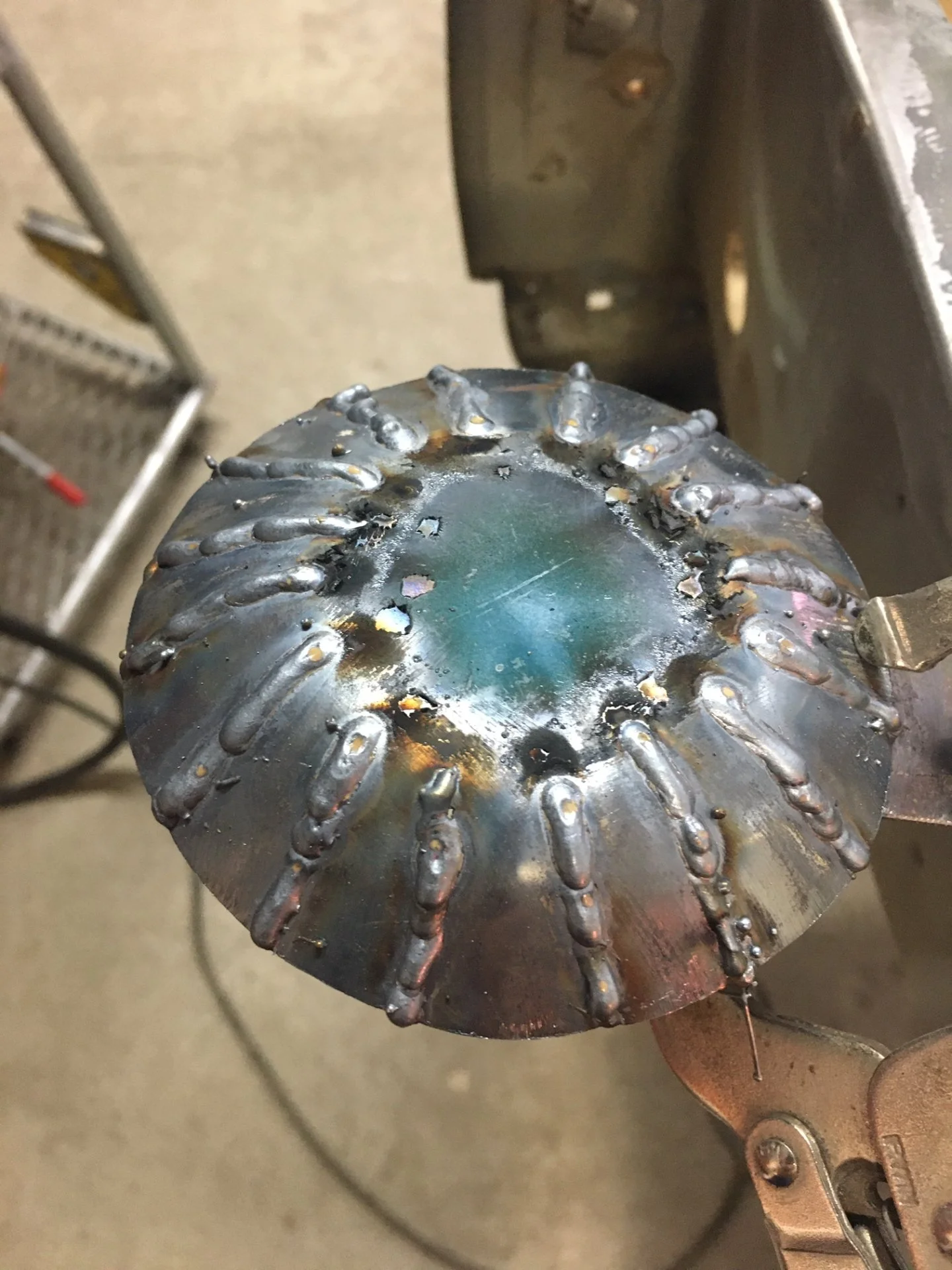

If your depth is low and the diameter is large enough you can form shapes like that using a thick piece of rubber for the 'female' die (backed by a healthy piece of plate) and a handy whatever for the male die with a hydraulic press. The closer the depth gets to equalling the diameter, the less well it works. I've done it a couple of times and always been amazed at how well it works.

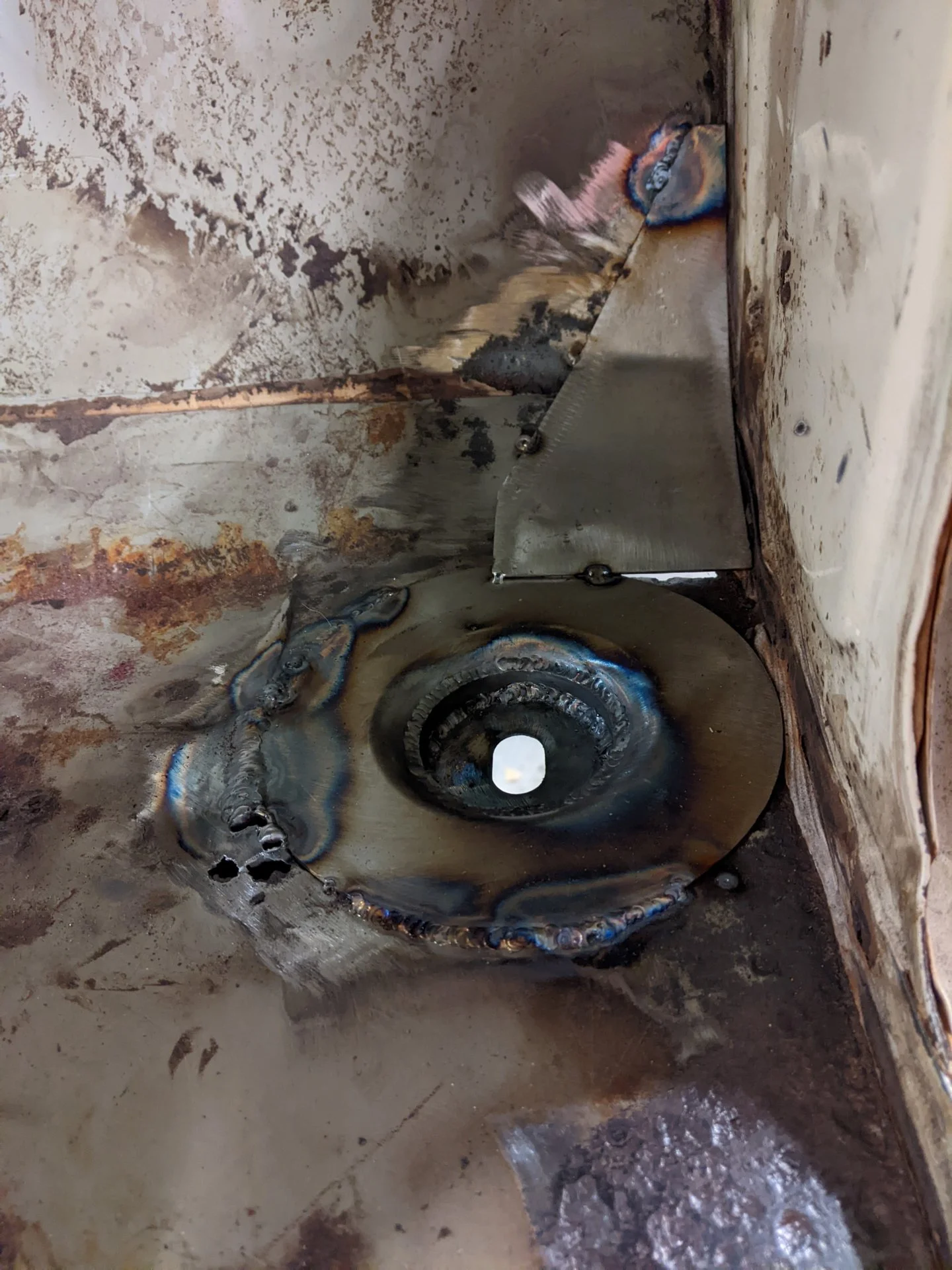

Little progress on the passenger side floorboard. Dimple die didn't go as far as I thought so welded a 3/8" tube extension to the bottom, I think it turned out great! Started tacking up the triangular area. Will have to cut out some little overlays for the remaining holes but getting there! I wanted to weld the body back together on the outside too, but starting to debate that considering how much of a pain it is to weld the sheet metal, especially since it's hard to get a tight fit. I might just tack it up and lay some RTV in, which I'm already gonna have to do on the top since the whole door seam area has factory RTV that I don't want to spend the time cleaning out enough to weld. I think weld just one side, and RTV the other side, and then probably LineX the bottom anyways and the top will get sound deadening and carpet over it.

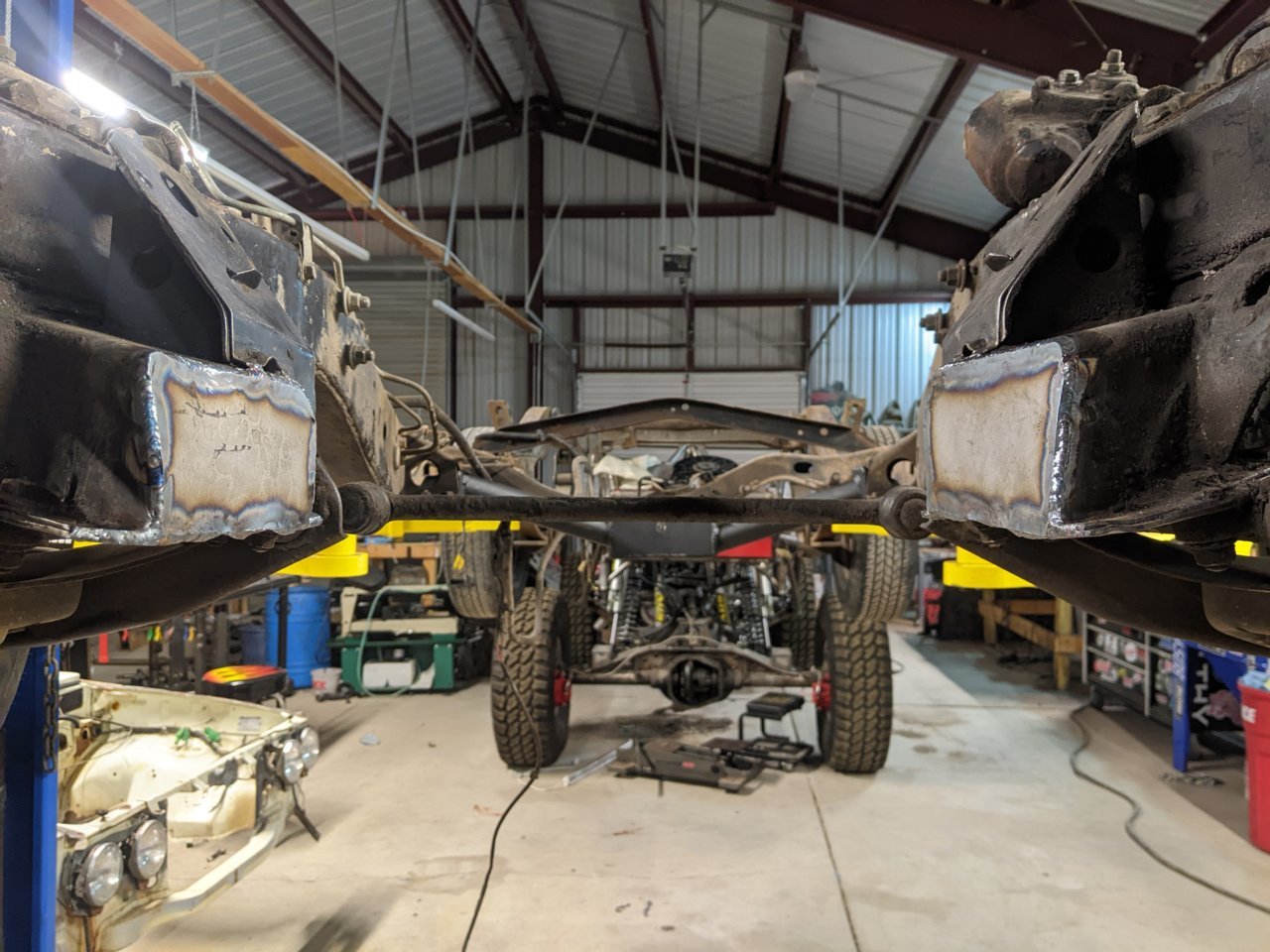

Since I'll have parts starting to show up soon, today I decided to fix the front cross member while the engine is still easy to pull. There's only about an inch left of it.
I decided to fully cut it out, plate it, and run a tube between the two sides similar to the trans cross member. Onto the lift the chassis goes!
I first plasma cut the remains out and then a grinder to smooth the edges, followed by a wire wheel to try and get a somewhat clean area near the welds. Before welding I then hit everything with a flappy disk and cleaned it with acetone.
I took some measurements and cut two plates out on the plasma table, and using a combination of a scissor jack and hammer got the plates formed into place.
I then TIG welded everything with .045" wire. Not the greatest welds, even with the lift it can be annoying to get into position but surprisingly everything welded really nice! I thought I'd have issues not being clean since it is a 44 year old frame caked in oil but it worked great!
I then measured, cut, ground, and sand blasted a 2.0x.120 tube. With it tacked in I quickly reinstalled the engine, made sure the oil pan cleared and the motor mounts still lined up to confirm the chassis hadn't moved and then welded it in with the MIG.
Quick coat of paint and the engine bay is done with the heavy fabrication! (For the time being
