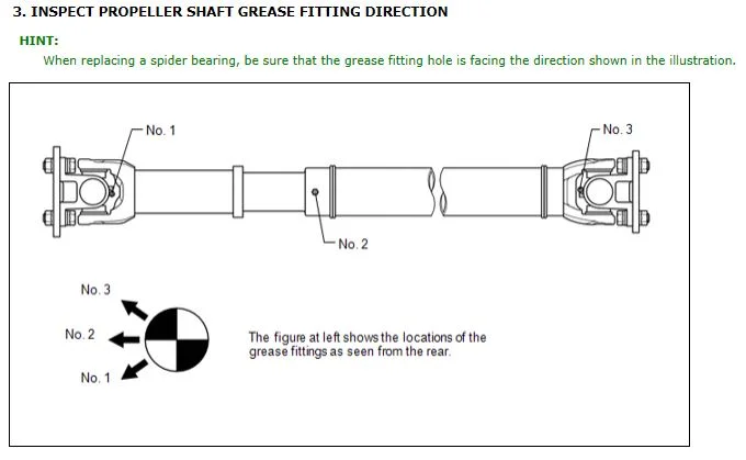

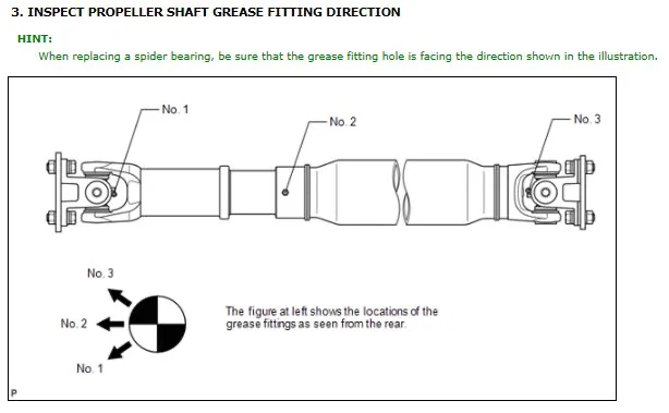

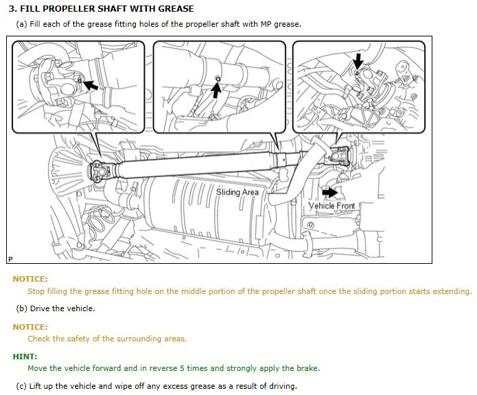

UCAs have oilers? 100 series doesn't..
And what about driveshafts, I didn't know they lubed..
No offroading, just some actual use (like getting to fishing/hunting spot) so not much.
And maybe 3000 miles of light towing uhaul trailer with motorcycle(s)
If your stock, then no on UCA's. I run SPC UCA's.
Good thread here on driveshaft.
Front;
Rear Propeller Shaft
