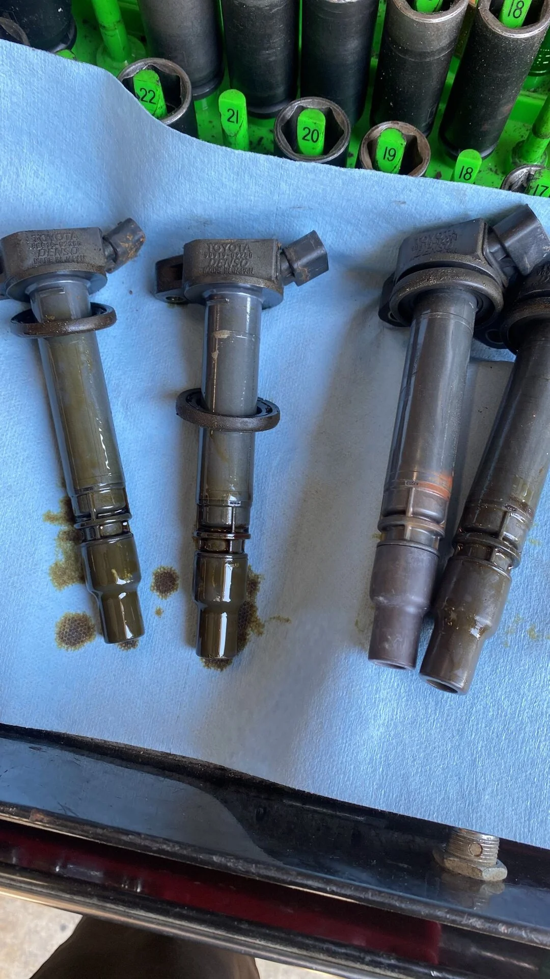

Remove all 8 coil packs. If any ot them have oil on them, that means the spark plug tube seal has gotten tired and isn't able to keep engine oil from getting past it. People usually discover this when they are replacing spark plugs as preventative maintenance.
<- This is how I discovered mine were leaking. In my case was about 190k-ish miles.

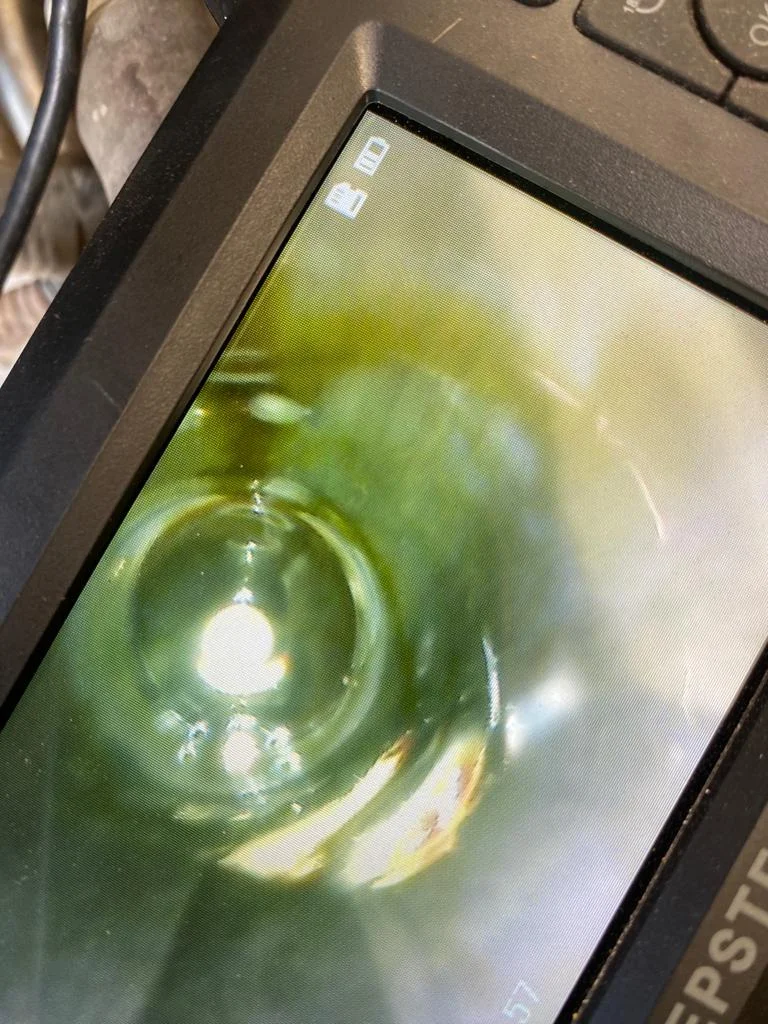

Oil within the tubes often isn’t the valve cover gasket, it’s where the tube is sealed into the head. @Taco2Cruiser has written about this in the past.
So you're saying that oil intrusion into the spark tube well is due to the the connection of the spark plug tube with the head and not a faiied spark plug tube gasket? That is interesting and I find it difficult to believe. I thought the spark plug tubes are installed into the head with a sleeve sealant. I guess the proof would be that after replacing the spark plug tube seals, oil is still filling the spark plug tube wells.
Yes. And don’t take my word for it, this guy has worked on hundreds of 200s.
