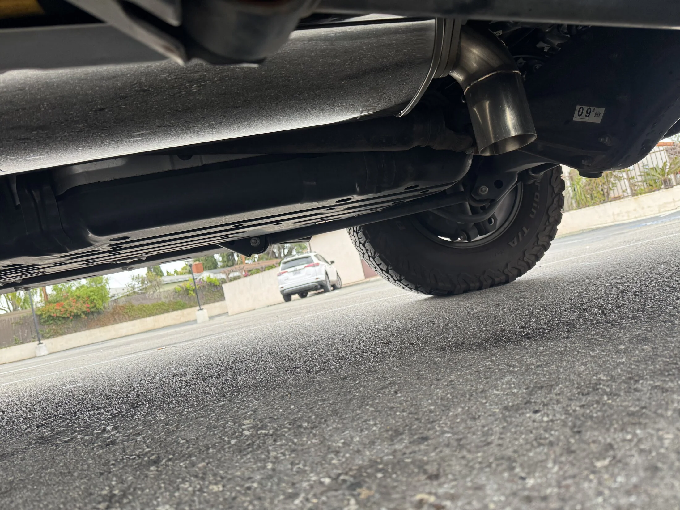

I am anxious to hear more from @sreyes1103
He installed one of these.
I think that tip is awful. Curious to hear how it sounds though.
It doesn’t drone at least to me, just louder than stock but makes you hear fast but feel slower from the sound lol.
Regarding the tip, it’s just limp and in the end you can’t even see it lol and I think I am getting worse gas.
