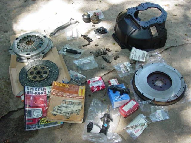

I just did the conversion on my 71. I got all my parts from a 12/74 fj40. The
12/74 has the 4 speed and 3 speed "transition" transfer. (lower gears) I
swapped over the d-shafts, bell housing, & flywheel. My 71 d-shafts are
smaller you may not need to swap those. Since I swapped d-shafts, I had to
swap the flanges on the 3rd members.While doing the conversion I replaced the
following with new components:
Clutch and pressure plate (asain jto best price)
Clutch Master
Clutch Slave
Clutch slave rod
rear main seal
pilot bearing
throw out bearing
clutch fork
fork boot
forkpins
clutch release spring
flywheel bolts
clutch bolts
clutch ball
I get my parts from the local toyoya dealer. Most are in stock or shipped in
overnite no charge.I introduced myself to the dealer GM. He was stoked when
I told him about my project. He once owned a freeborne red fj40. I now get
jobber (cost) prcing at the parts counter.Installation is pretty straight forward.

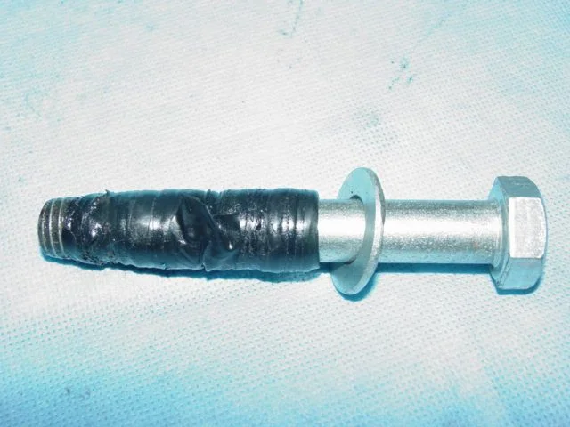

I had a few hurdles including one MAJOR mistake. After using several bearing
pullers w/o sucess, I made a tool to remove the pilot bearing. It was ez to
make and got the job done in minutes. I will send it to you if you like. I also
rebuilt the parking brake and had the flywheel and brake drum turned. Let
me know if you need any help.

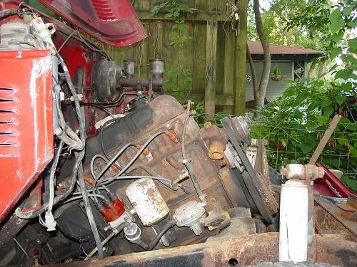

MY MAJOR MISTAKE:
I didnt support the engine when removing the bellhousing from the donor fj40.
The front motor mounts snapped and the motor fell to the groung almost
crushing me. Make sure you support the rear of the motor when removing the
bellhousing.
