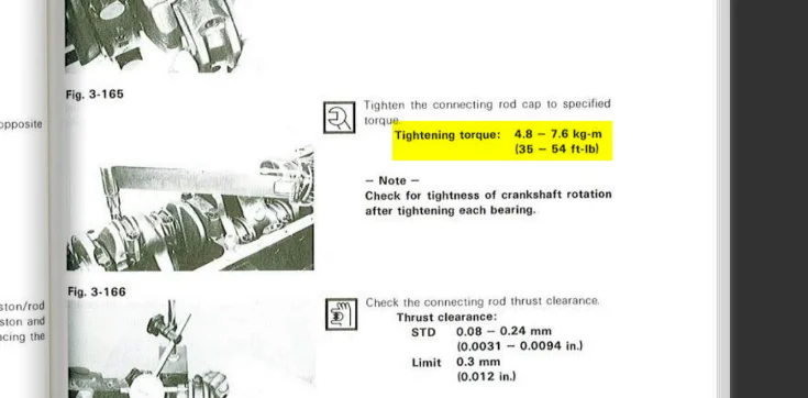

My goodness, are you sure? 130lbs? Where are you reading that? I couldn't believe it when I torqued it up to 100... Here's the page out of the fsm... and i'm not claiming any kind of authority, just wondering where 130-160 came from is all... please

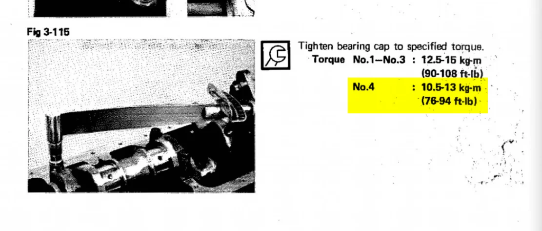

sorry, wrong picture - the bearing cap - here's the right picture, with cap4 at 96 lb-ft. I can believe that.
