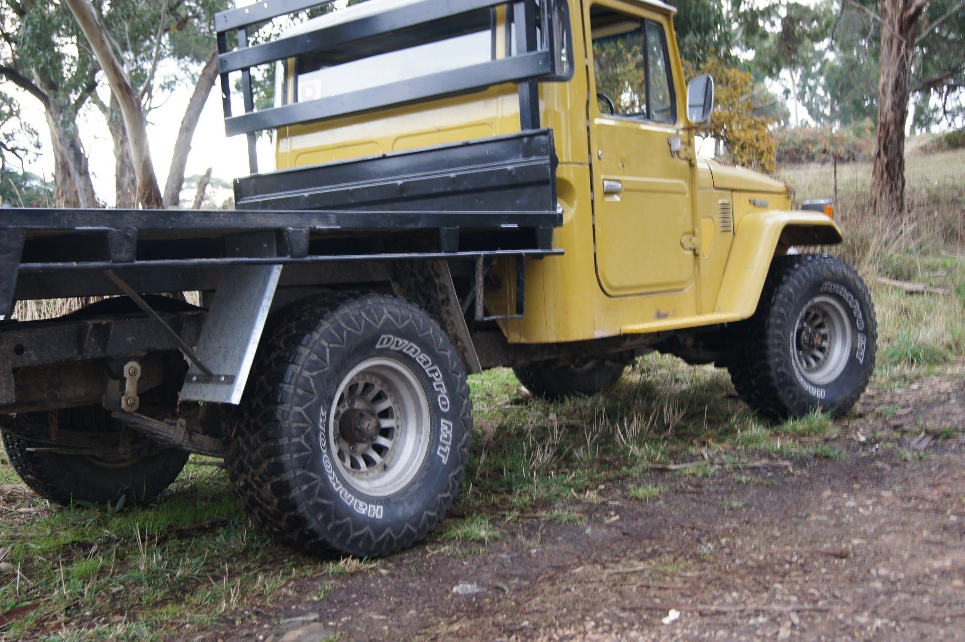

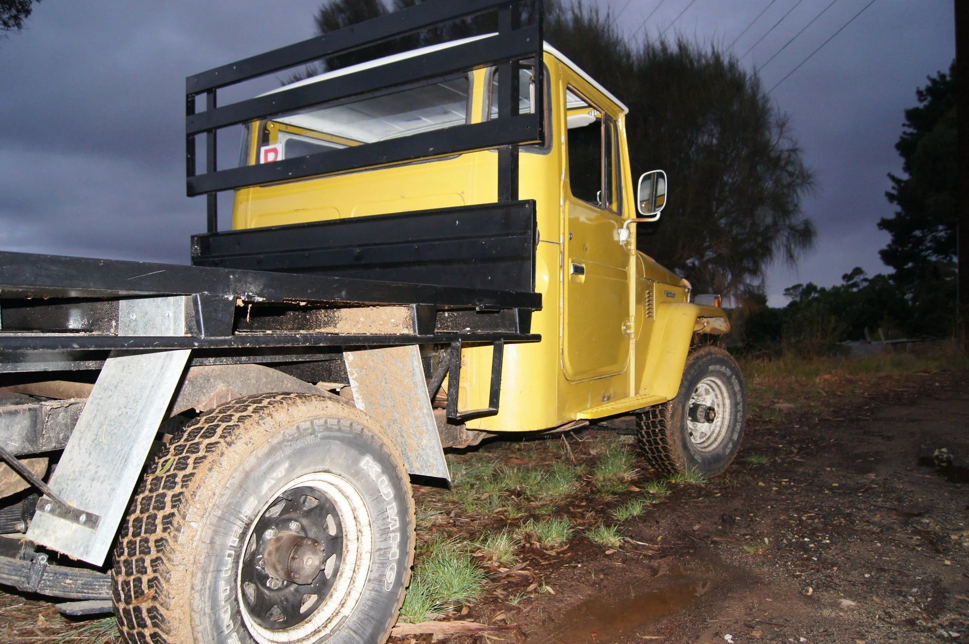

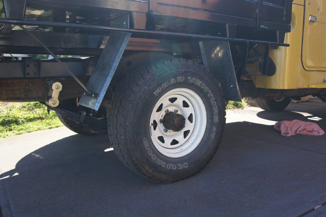

ok, wow time moves fast! have got a bit done. firstly got some wheel guards on, looks okay and will do for now.

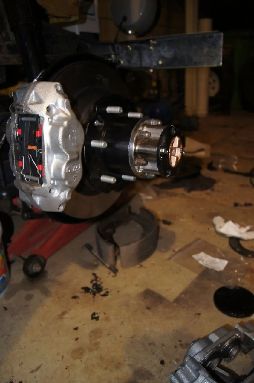

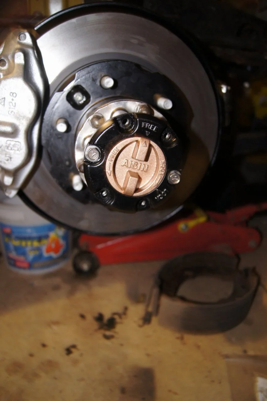

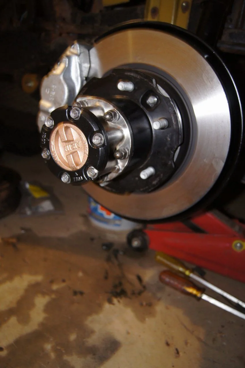

painted up my other caliper today as well. got complete rebuild kits coming for em as well. genuine yoda of course.

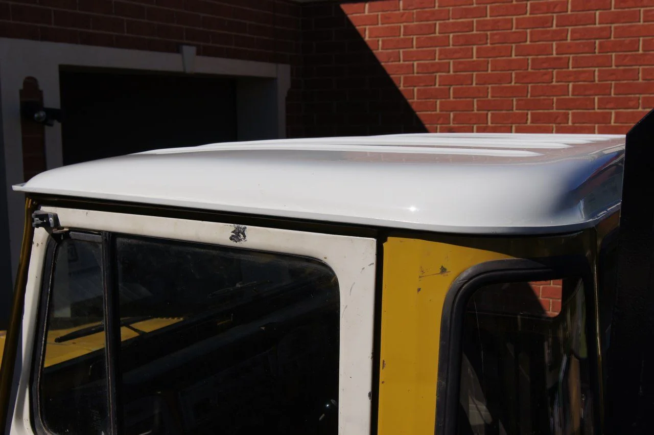

also got my roof and besel back from my painters. terrible pics but they have a nice layer of T12 2-pac on them. slowly getting the body work painted, will probably signal the bulbar as the next major thing to do. thinking about rego soon, body still looks shot though. it's a slow and expensive occupation so bear with me as I get it done in bits and pieces.

on a side note, 31" tyres are really small. but I can't afford new rubber at the moment.

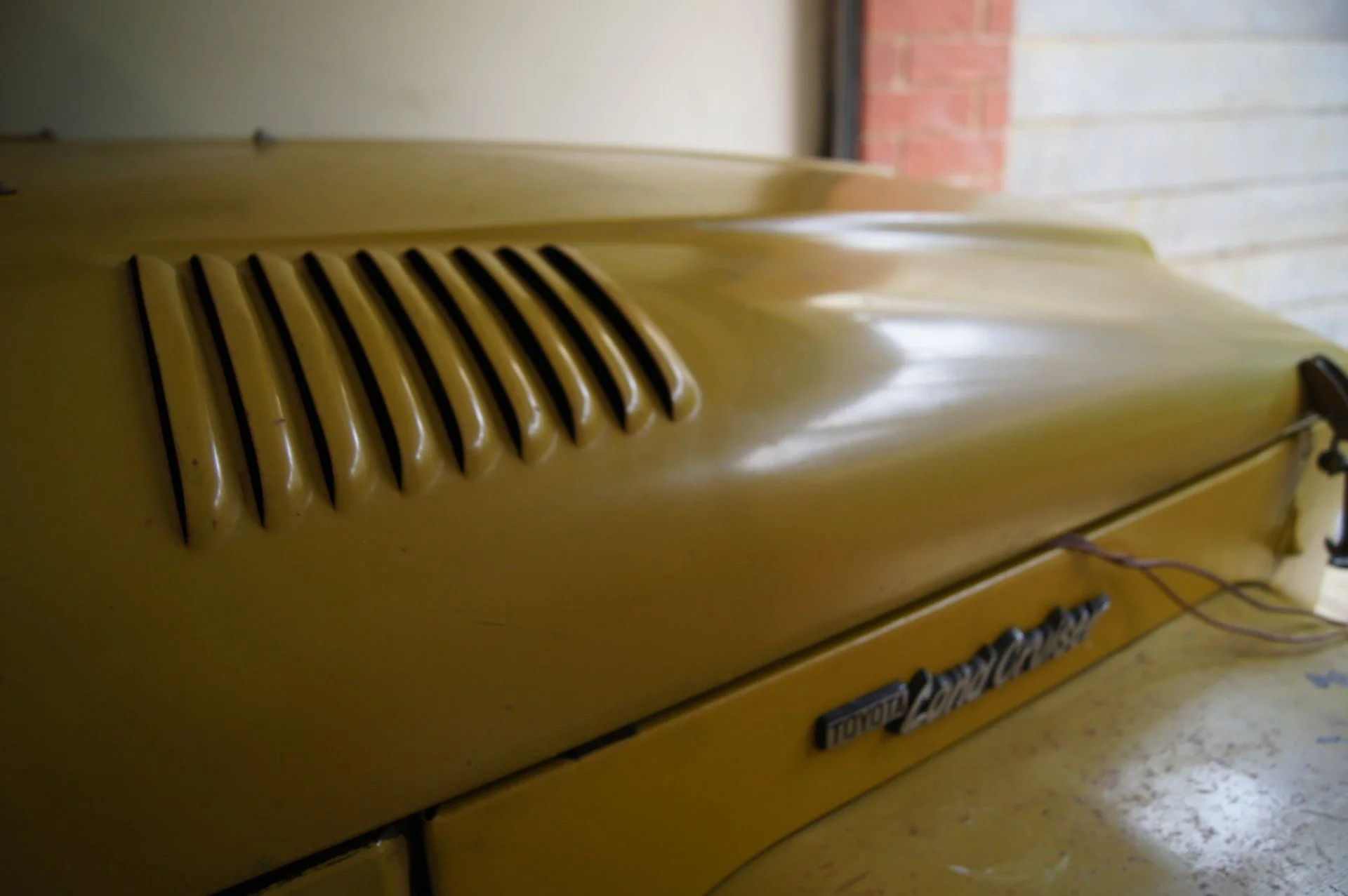

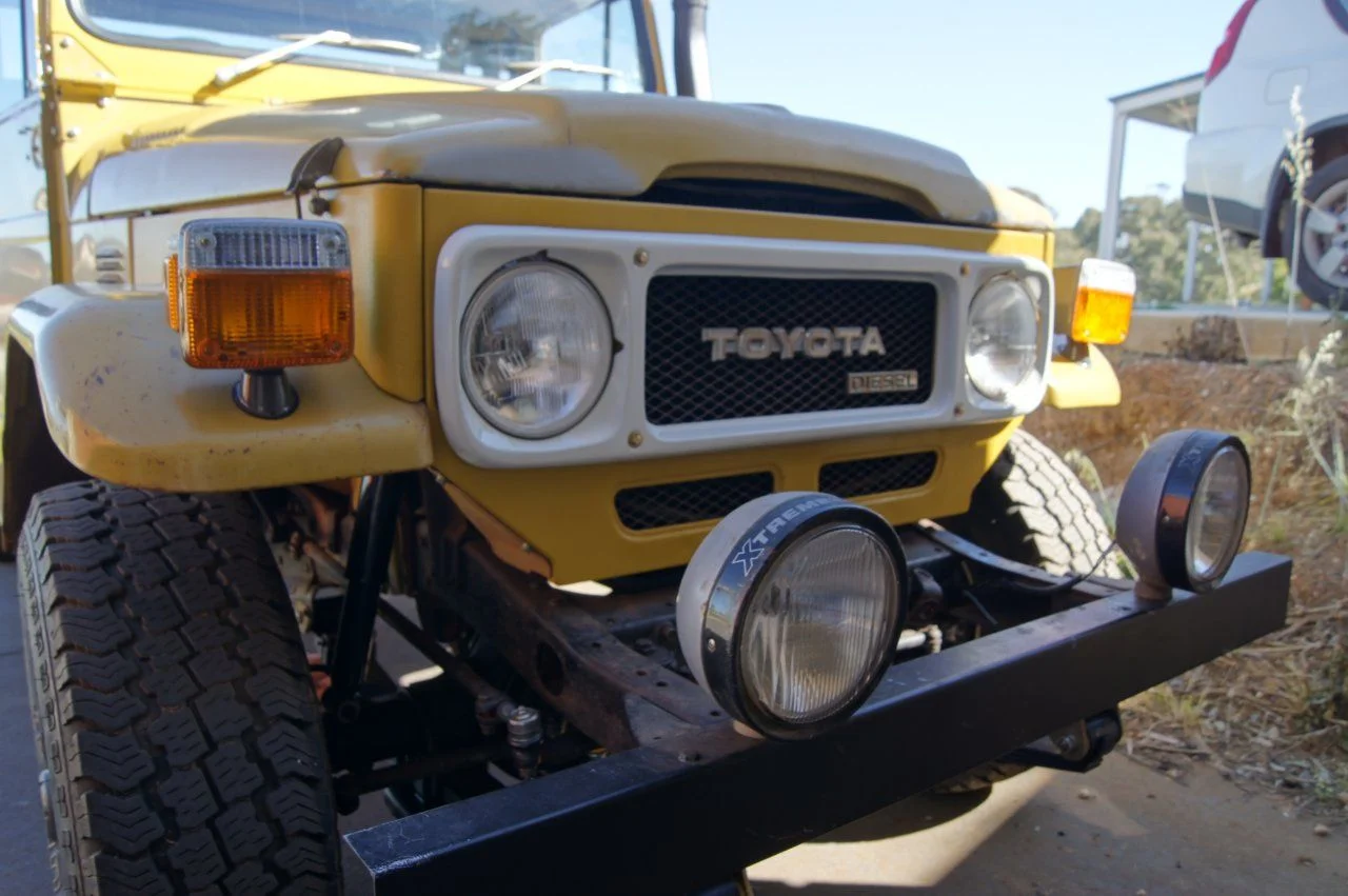

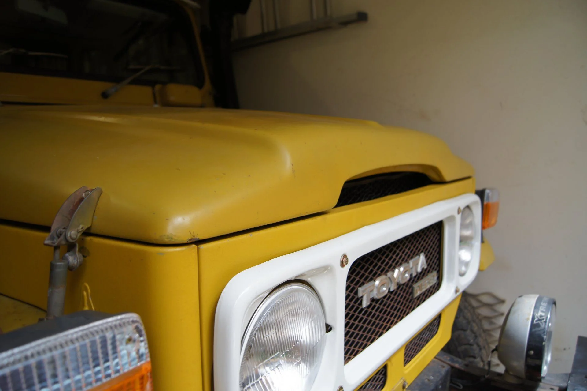

did a few things, fixed up the bonnet with some colour match till i get it done in 2 pac. the second pic is crap but it shows the front.

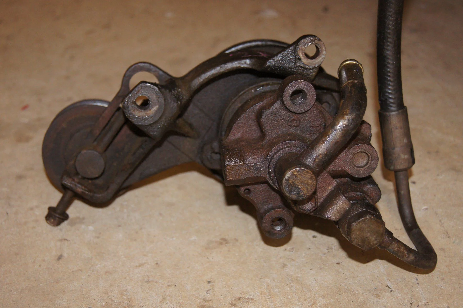

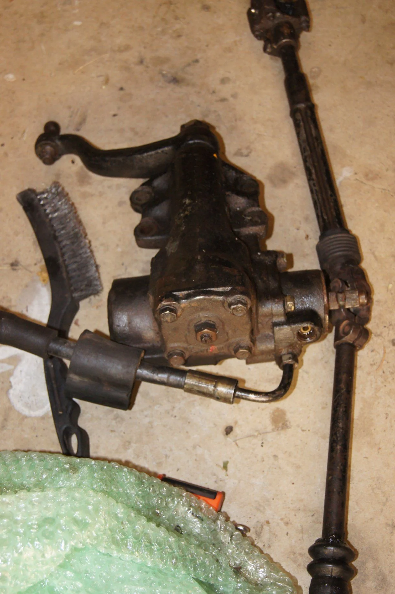

no prizes for guessing what this stuff is.
early 2h pump (six bolt pattern) and 60 series power steering box.
just need and early 2h vane pump bracket if anyone can help me out.

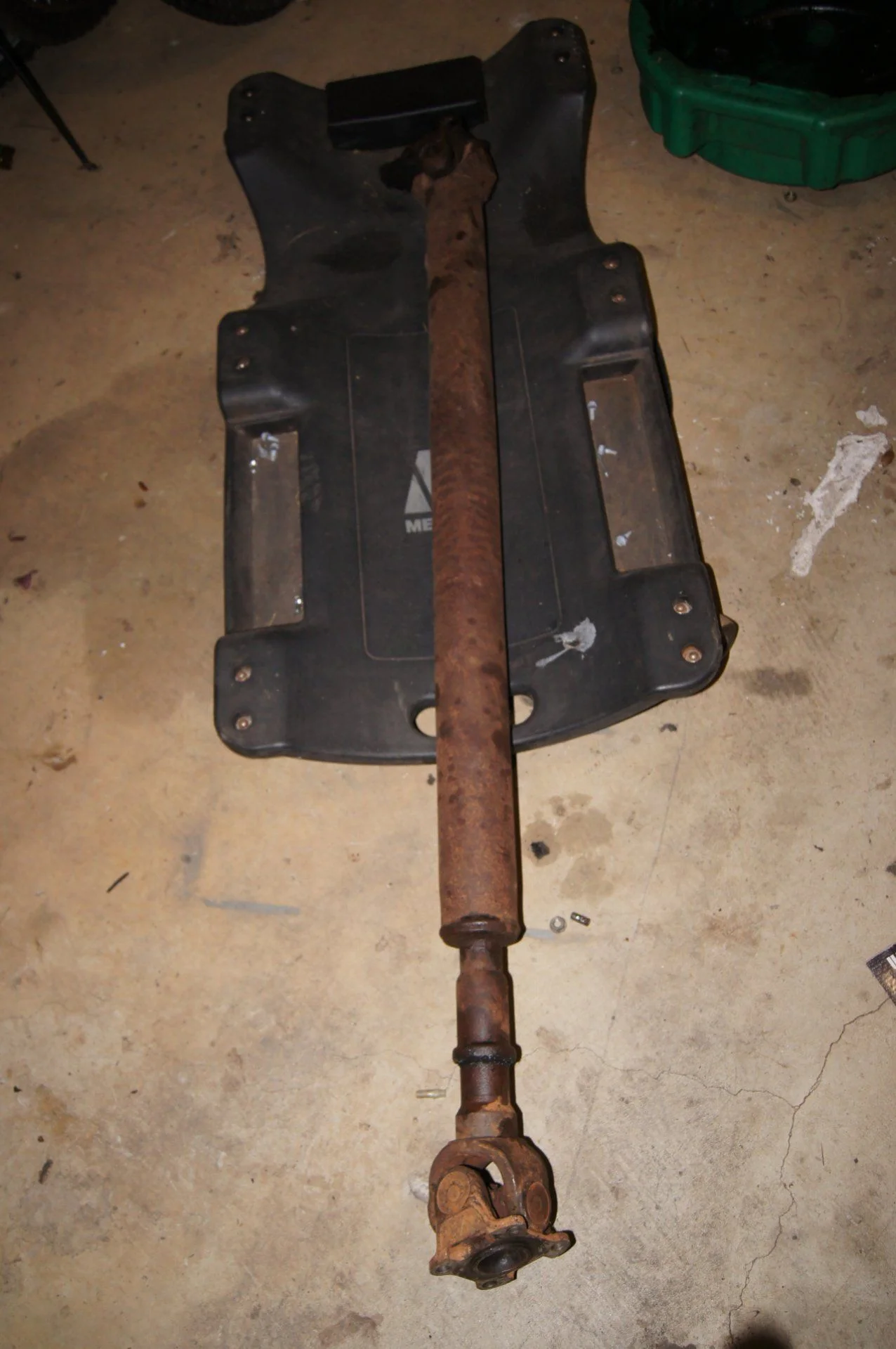

1. real bad driveline vibrations. i mean, 80km/h and it was shaking it like crazy. so put a new (used) tail shaft in her and it helped a-lot. it can now do highway speeds but still has a reasonable vibration. i reckon i'll get the tail shaft balanced and work form there. uni's are good.

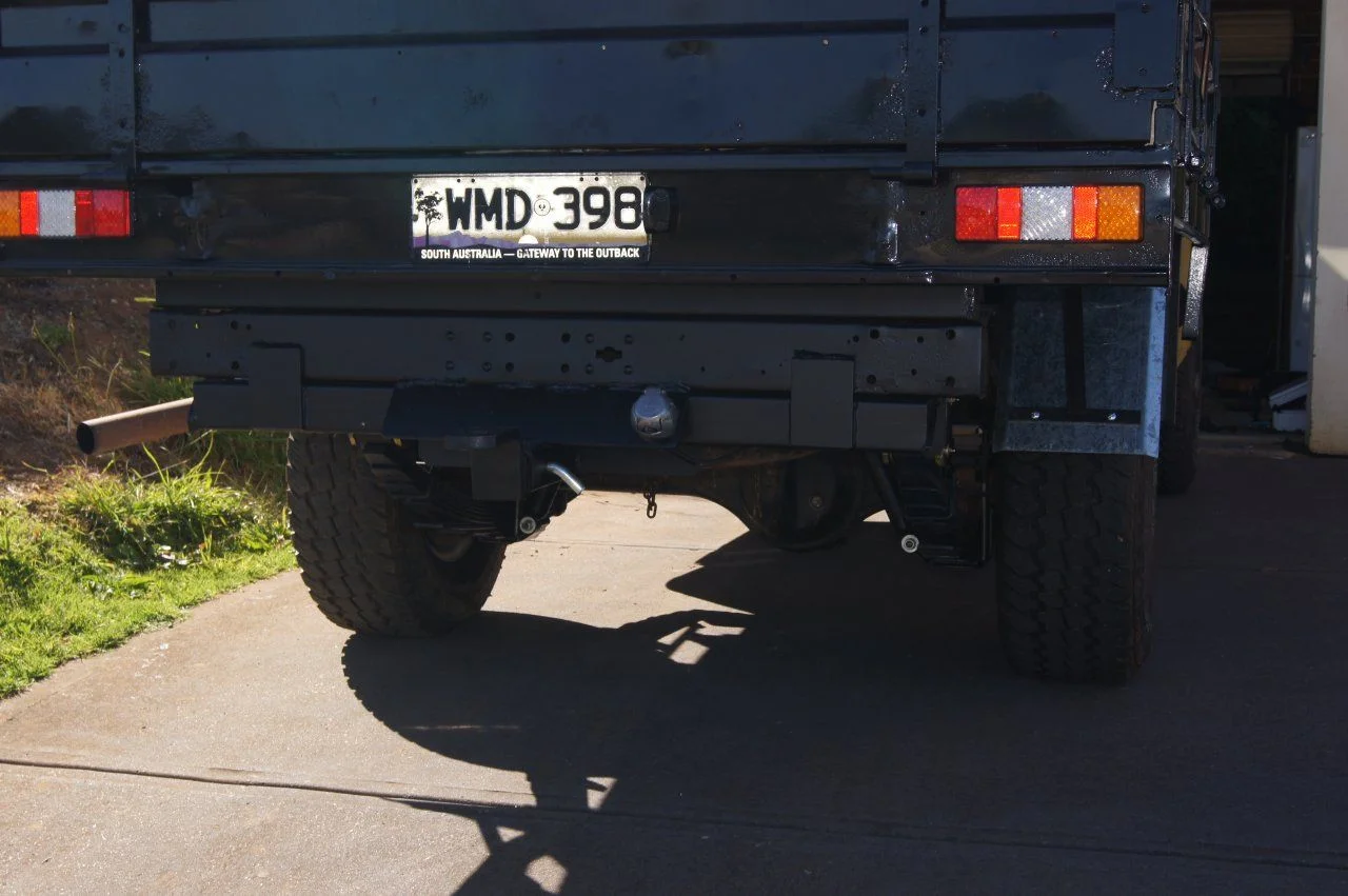

7. got the Exhaust done. dumps underneath the cab. sounds way louder (how i like it) but is also a really nice sound and not too loud at highway speeds. but it made a weird bark. looked today and found that the exhaust blokes forget to tighten the nuts on the exhaust manifold. stupid little things like that.

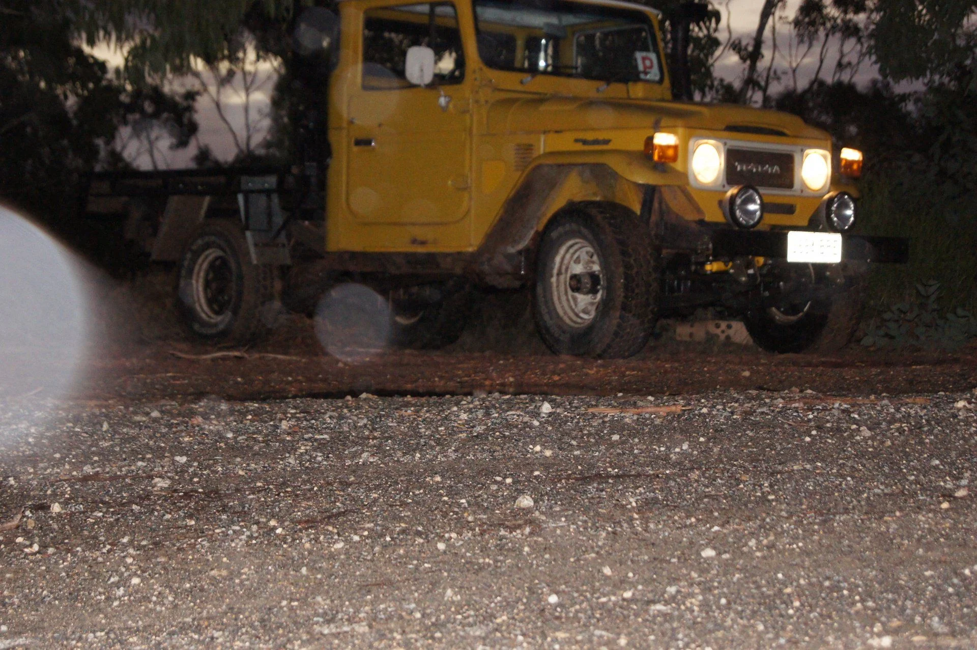

And he's registereddd!!! Feels good hey?
You know the rules........pictures mate or it didn't happen! ;)
okay okay, coming up.....
it feels awesome. hey i found out a whole lot more stuff that she needs since I've been driving it, but you know what, they are so unique and cool, i now belong with those few guys get thumbs up form Kenworth drivers. it's a great feeling. also the respect you generate as a 17 year old doing it is damn special. really surprising and it's great to speak to 50-60 year old diesel mechanics like you do everyday. i probably do.
hard to see but my buggered tail shaft.....

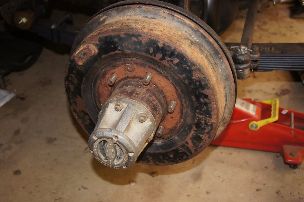

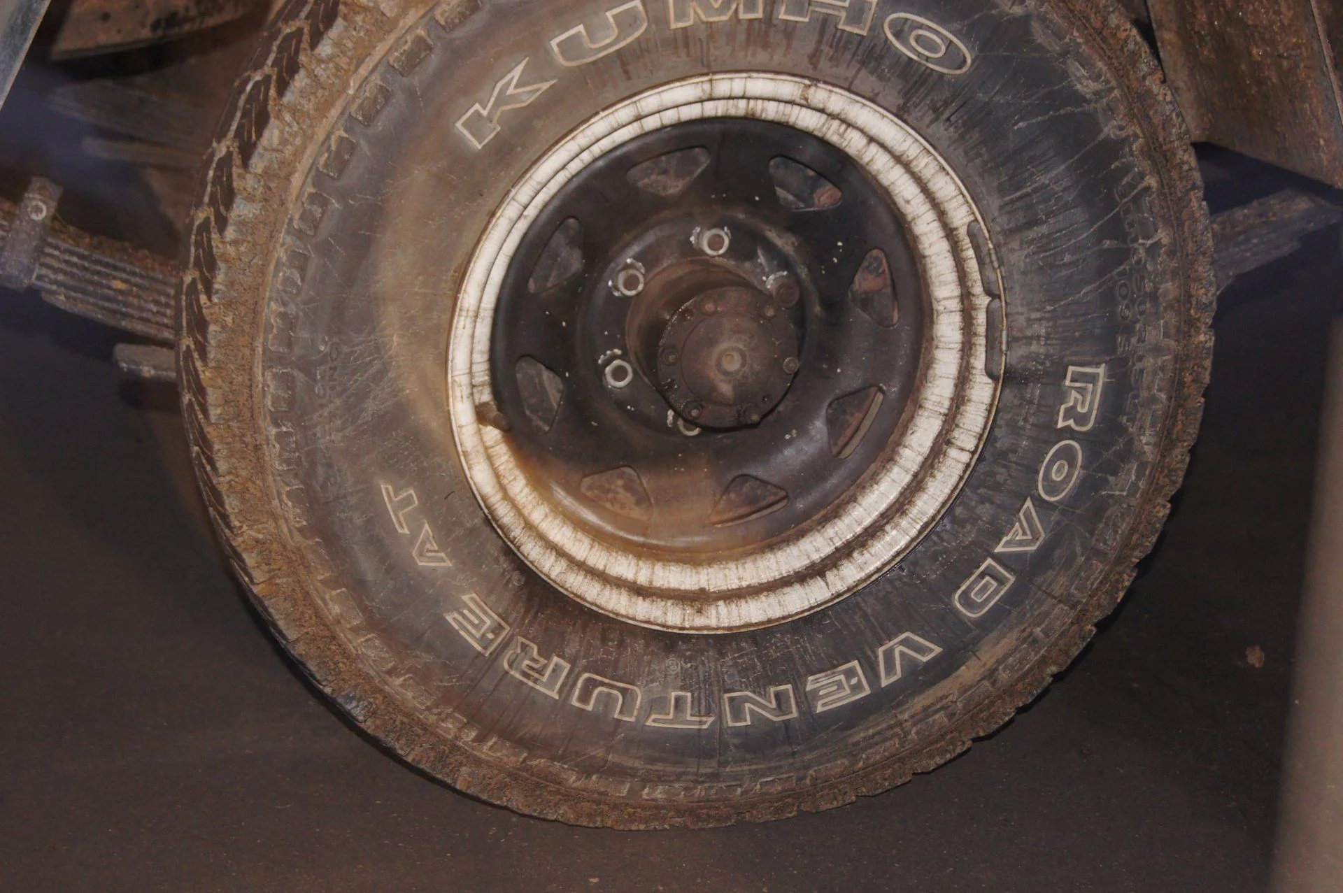

and the axle seal: if you can see it, the grease on the rim. it's worse than it looks in the pics. and NO, i did not paint the inner part of the rim black, it came like that.

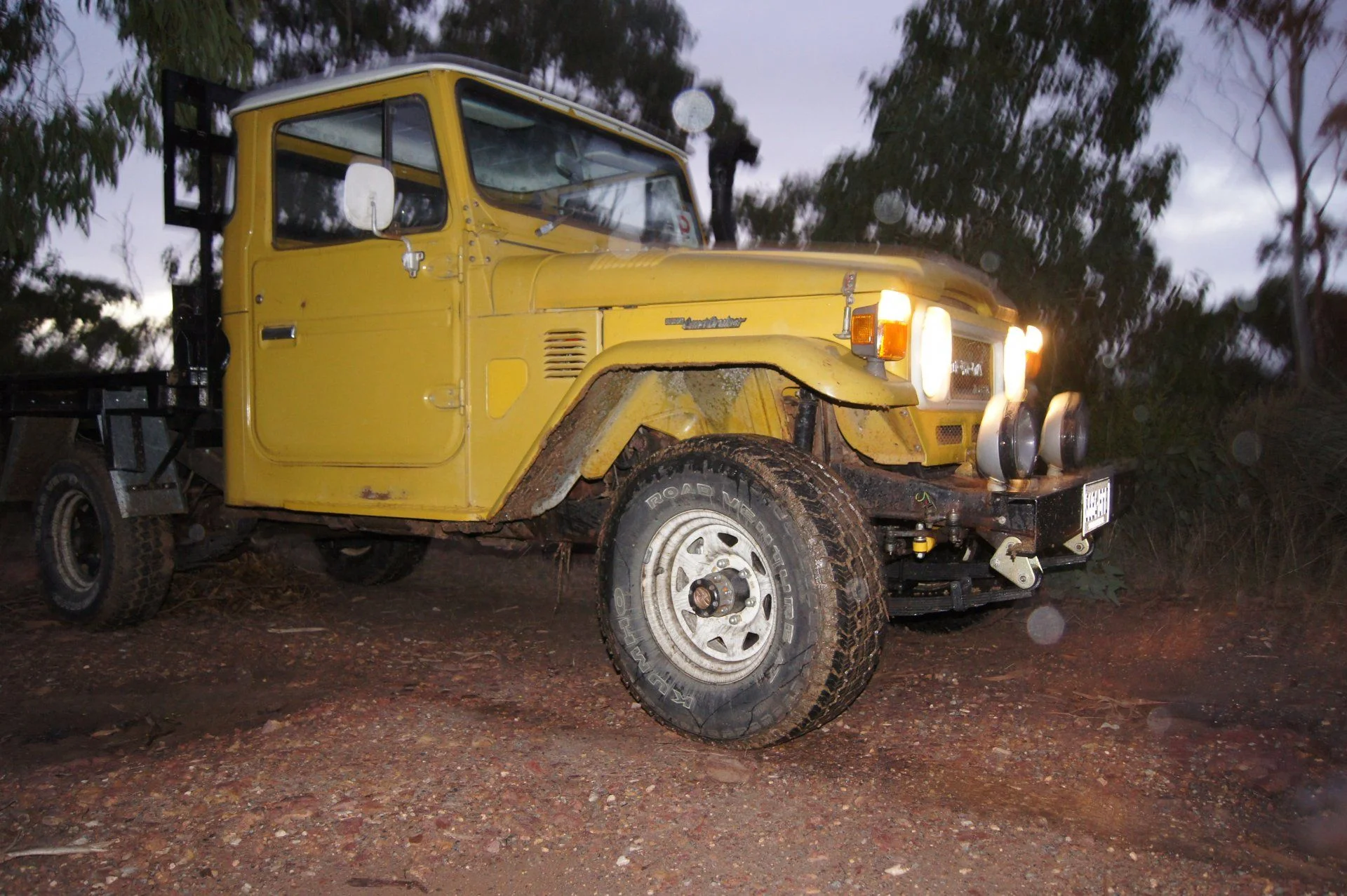

@cult45 i don't know what this photography is like? 33 inch 60 series wheels and tires.
i think that the offset may be to big on the front though.
She looks good mate! Are you going for something special with your pics? I always clean the phone lens and run a quick eye over whatever else is in the photo before snapping, and then check again before uploading, but that's me just being an artist :D
haha yeah, i should do that. sometimes i don't have time though. also in the previous pics it started to rain just as i was taking them. i figured that some pics were better than none.
