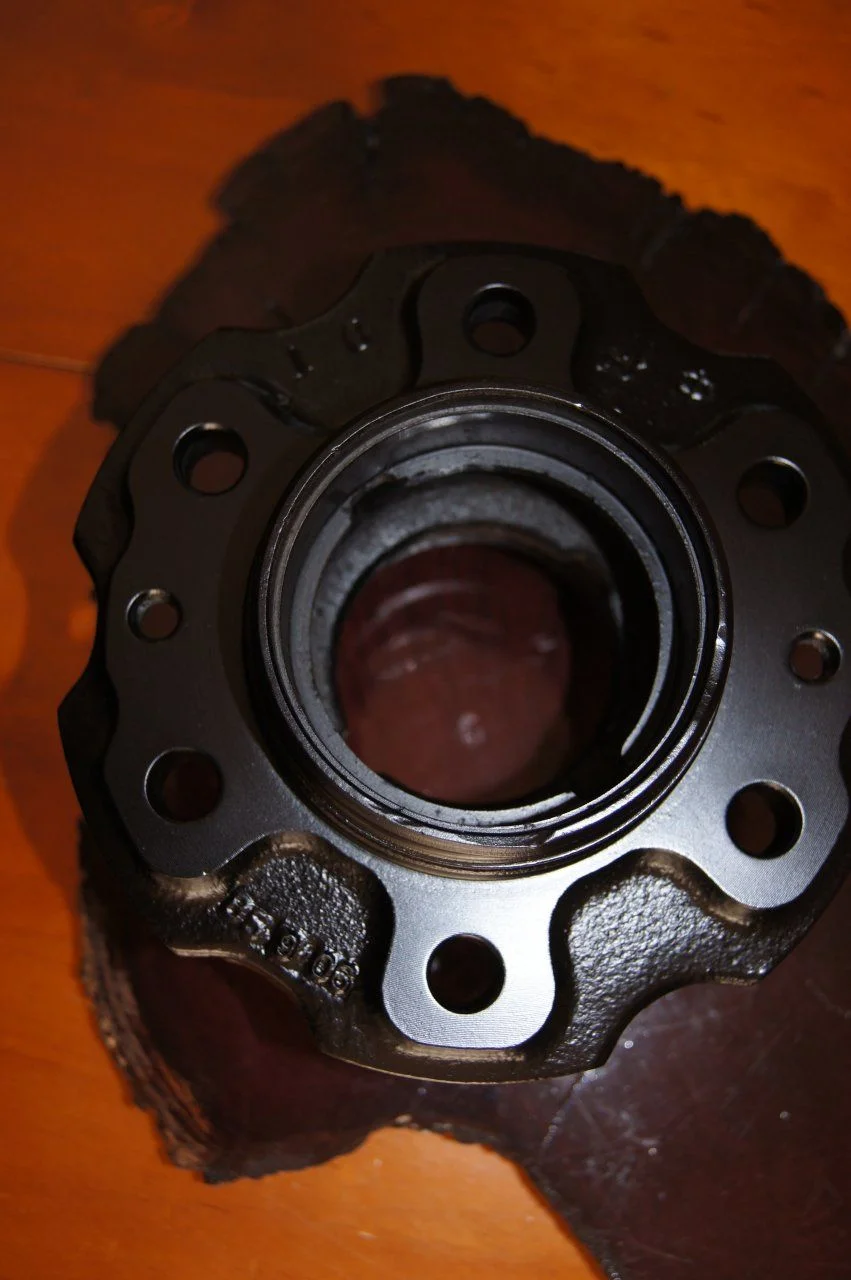

I few impurities above but good enough. also painted up some other parts, but the photos are coming out so bad, I didn't bother to take pics of all of them. just enough to get a rough idea. came up good I reckon.

also got some new bearings into the hub. I'll post up some pics later, also will need some opinions as to whether the calipers are usable.
