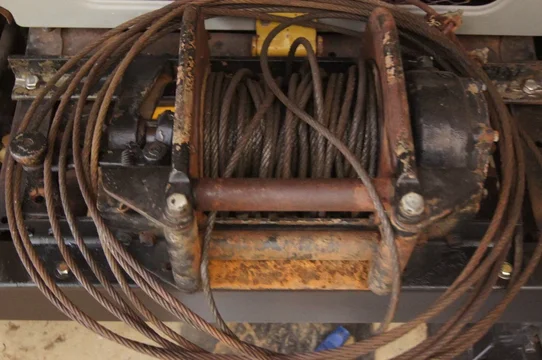

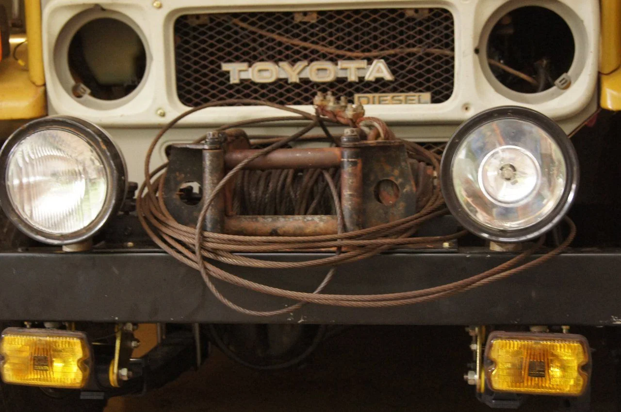

Lookin good! Winch cable ready to go!

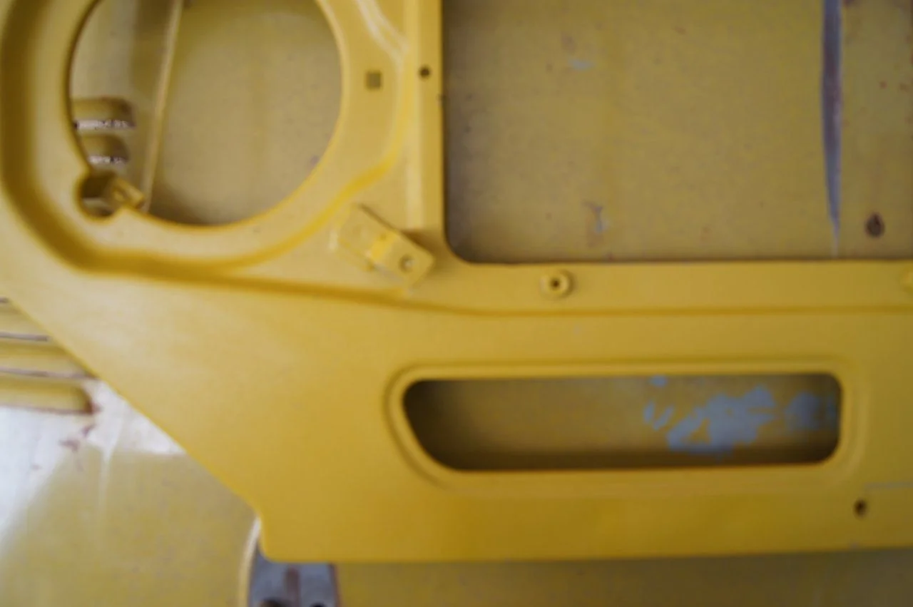

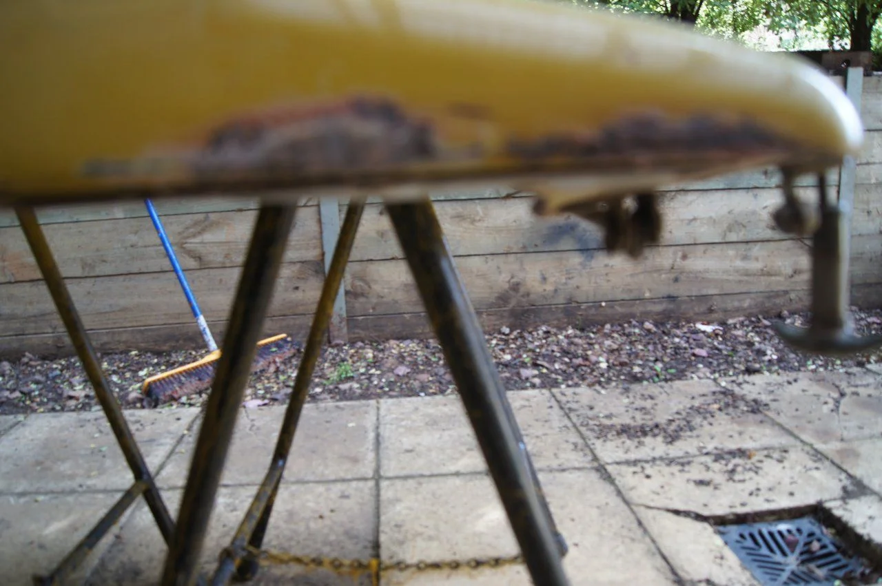

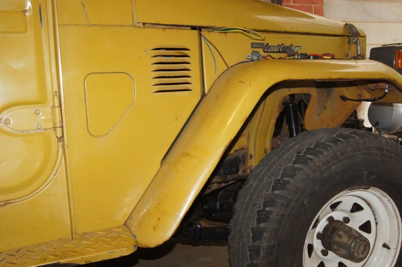

okay so a while since I've updated everyone being going slowly cos of the y11 workload, it entirely s****, but anyway have the bonnet off to fix up the rust, also painted up the front bib in the final colour, really happy with it. its not the final coat but just a very thin teaser one. hopefully get it done some time this week. and with the body work, I have decided to repaint the whole outside of it because the original paint has worn so thin (see first pic of post 273).

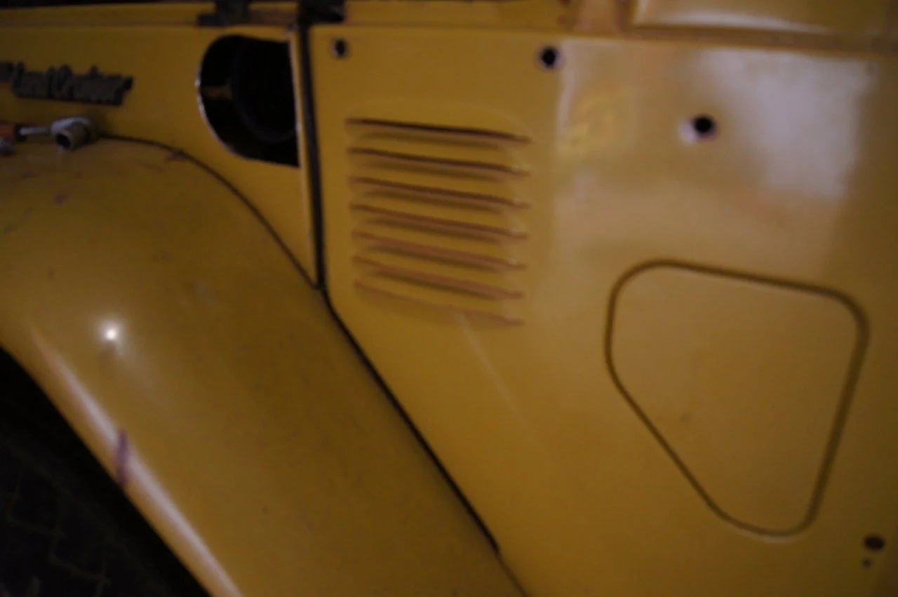

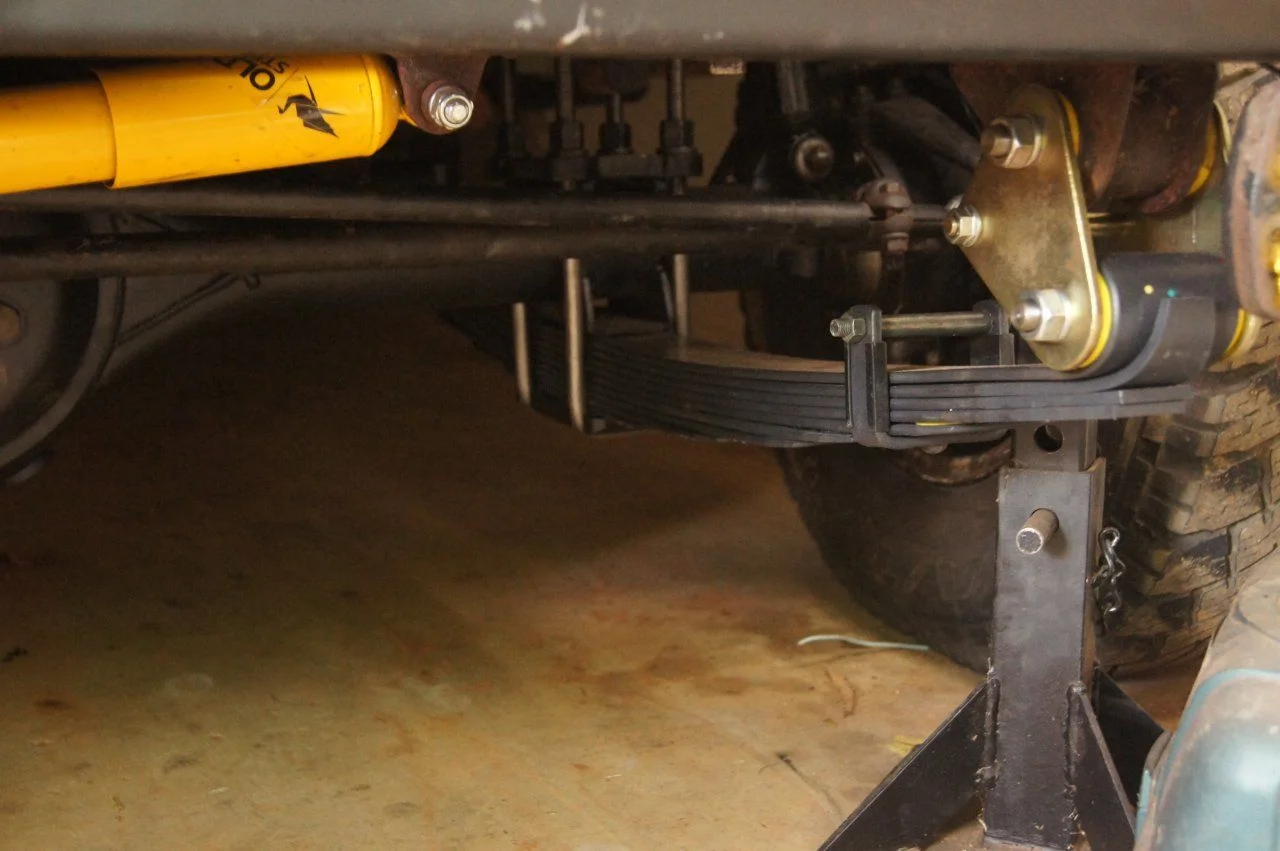

sorry about the terrible pics but enough to get the idea? I also received my rear greaseable shackles so I put on the rear springs finally. the second pic is the holes for the snorkel which I've taken off for painting (the body that is).
pics are soooo bad but this is why I need a new exhaust, thinking that I will get someone to make me up a custom one, can't buy any of the shelf these days.
also went down to brad at early landcruiser spares for a few parts, and ended up walking out of there with some nice new tyres to get me through rego, so she's running the same tread all around now.
