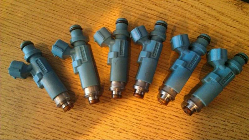

Option #1: I've read previous threads about LC owners with turbo rigs upgrading their fuel injectors to achieve higher flow rates with the Subaru WRX "blue" 400cc injectors. Here's an example...
http://www.ebay.com/itm/NEW-400cc-B...arts_Vehicles_CarParts_SM&hash=item5895b40920

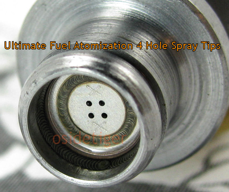

Option #2: Osidetiger's 4-hole Bosch DRI (Deposit Resistant Injector) fuel injectors
http://www.ebay.com/itm/ws/eBayISAP...00971117252&item=200971117252&vectorid=229466
These have definitely sparked my interest! Here are the specs:

Here's a link to their video about the product, that shows the dispersion pattern of the 4-hole design.
http://www.youtube.com/watch?feature=player_embedded&v=9P4YtNVPtjM
I believe they're still flowing the same volume of fuel as the OEM/Denso spec (312cc/hr), so no adjustment is required like the WRX injectors need.

It's important that when evaluating injector flow that they are rated at the same fuel pressure. With some research you'll find that the same injector will be rated with different flow ratings. This is do to the fuel rail pressure supplied.
For the most part flow ratings are with a fuel rail pressure of 3bar. At three bar our stock injectors are rated at 304 CC/min, the WRX blues, 3920 are rated at 425 cc/min.
Some sites are now offering flow ratings at various fuel pressures as some people will raise/lower the fuel pressure on the rail to deliver more/less fuel as a tuning choice.
The WRX 3920s have 12 holes which help with better atomization and with it's smaller solenoid mass will allow better control during the low duty cycles that idling requires from a larger flowing injector.
While these are a drop in electrically they aren't that way physically. They are around 9mm shorter than the stock injectors so the rail spacer needs to be shorter. I've found one that is shorter than the stock spacer from another Toyota but it still falls short of what we need to drop these in without a spacer of sorts added to the injector itself.

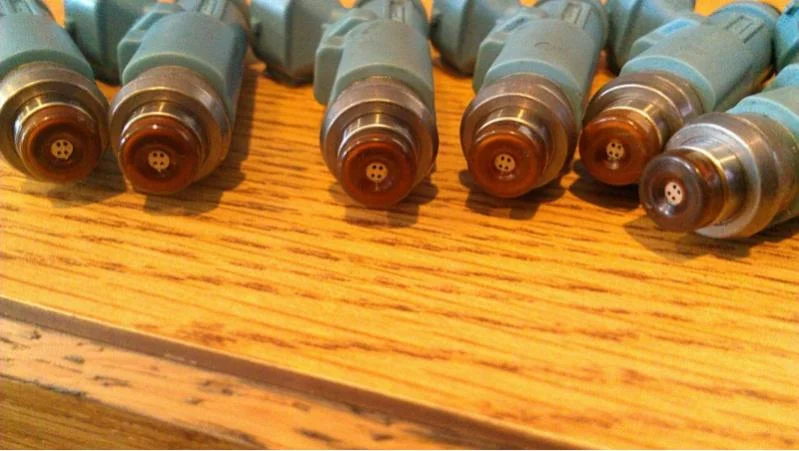

My stock take outs were 4 hole.... hmmmm.
Huh - they were definitely ORIGINAL??
I purchased our 80 new - and the stock Denso injectors are definitely 2 hole...
george.

If you guys haven't done so, I'd recommend takin a moment to watch Osidetiger's video (at the bottom of my OP). It was illuminating in terms of understanding how variations in the injector's fuel stream can impact effective atomization.
I believe these Bosch DRI 4-hole injectors are able to deliver better performance results in atomizing the fuel at the same OEM rate of flow, rather that just throwing larger amounts into the chamber.
