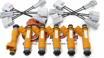

4-hole Bosch DRI fuel injectors from OsideTiger - Upgrade option?

Have you guys watched the video showing the difference in the Bosch DRI's atomization? that kinda speaks volumes to me.
So, someone try these, and then let us know. Also, please do before/after dyno pulls. kthxbye.
If you guys haven't done so, I'd recommend takin a moment to watch Osidetiger's video (at the bottom of my OP). It was illuminating in terms of understanding how variations in the injector's fuel stream can impact effective atomization.
I believe these Bosch DRI 4-hole injectors are able to deliver better performance results in atomizing the fuel at the same OEM rate of flow, rather that just throwing larger amounts into the chamber.
Frankly, for the potential they stand to offer at the this price point...I'm surprised these haven't made their way thru the LC ih8mud community more.
I'm thinking I'm gonna give 'em a go.
Curious if you ever gave the bosch injectors a go - I'm either getting the stock ones cleaned or getting the bosch.

Fixing to do a head job here in the coming weeks and am considering these as a replacement for stock, but only if no mods needed.So were these Osidetiger 12 hole injectors truly plug-n-play? No fuel rail spacer differences, wiring, etc?
How have this held up over the last two years?
Plug and play as they provide wiring adapters. Used them on my 3FE rebuild. Seemed to work just fine. Would probably swap them in on the 80 if I ever had the intake removed.
Thanks Jared, hope you're doing well! I saw they included the wiring adapter, but others had commented that some non-original factory injectors (ie Denso 23209-74080) could be slightly different in terms of length and require different fuel bar spacers when bolting it down... Given the 3FE cast iron 12 valve design vs the 1FZ aluminum 24 valve differences I'd imagine there might be fuel bar mounting differences between the 3FE and 1FZ...
