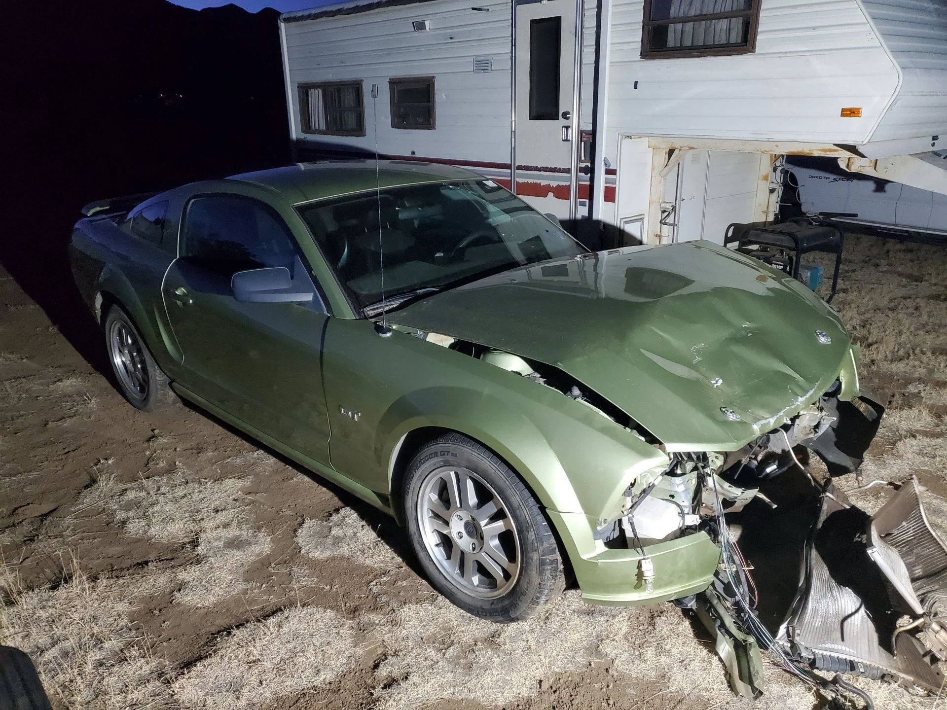

Donor car (sorry for bad picture):

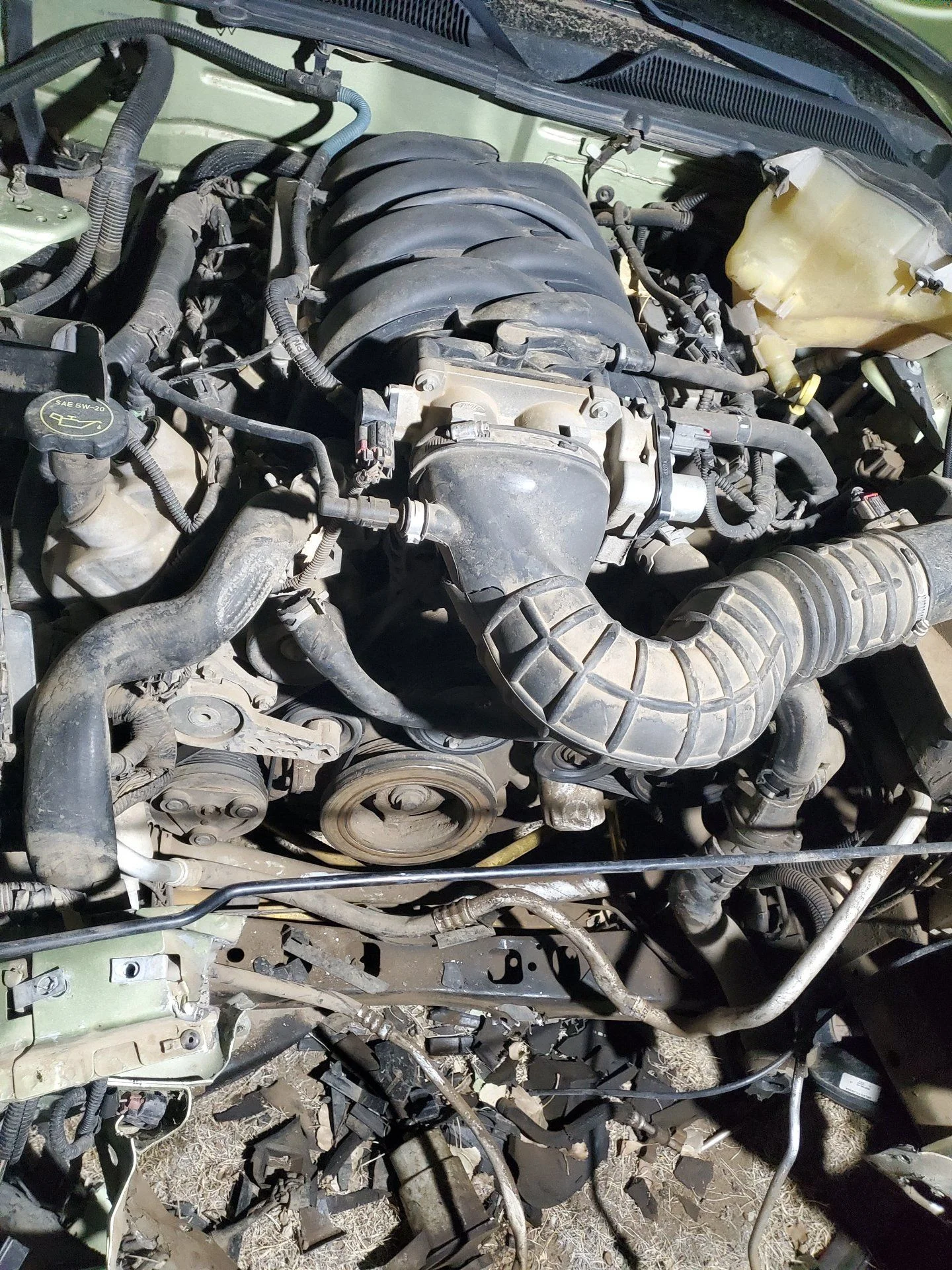

Pulled everything back. Only a cam position sensor was hurt in the accident. It's at mechanic friends house. He replaced sensor, pulled other stuff back and verified that the engine is good to go.
