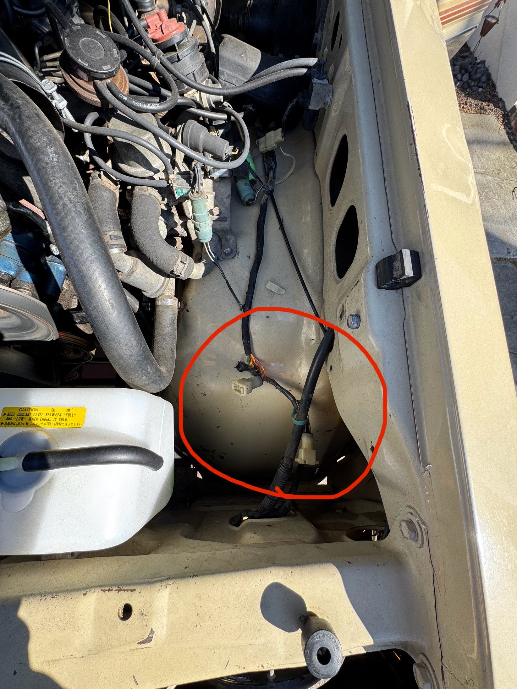

New to the 60 and just got my first one....I noticed there are two unused/unconnected connections in my engine bay on the drivers side (see photos). Can anyone assist what these are for? This is a 1984.

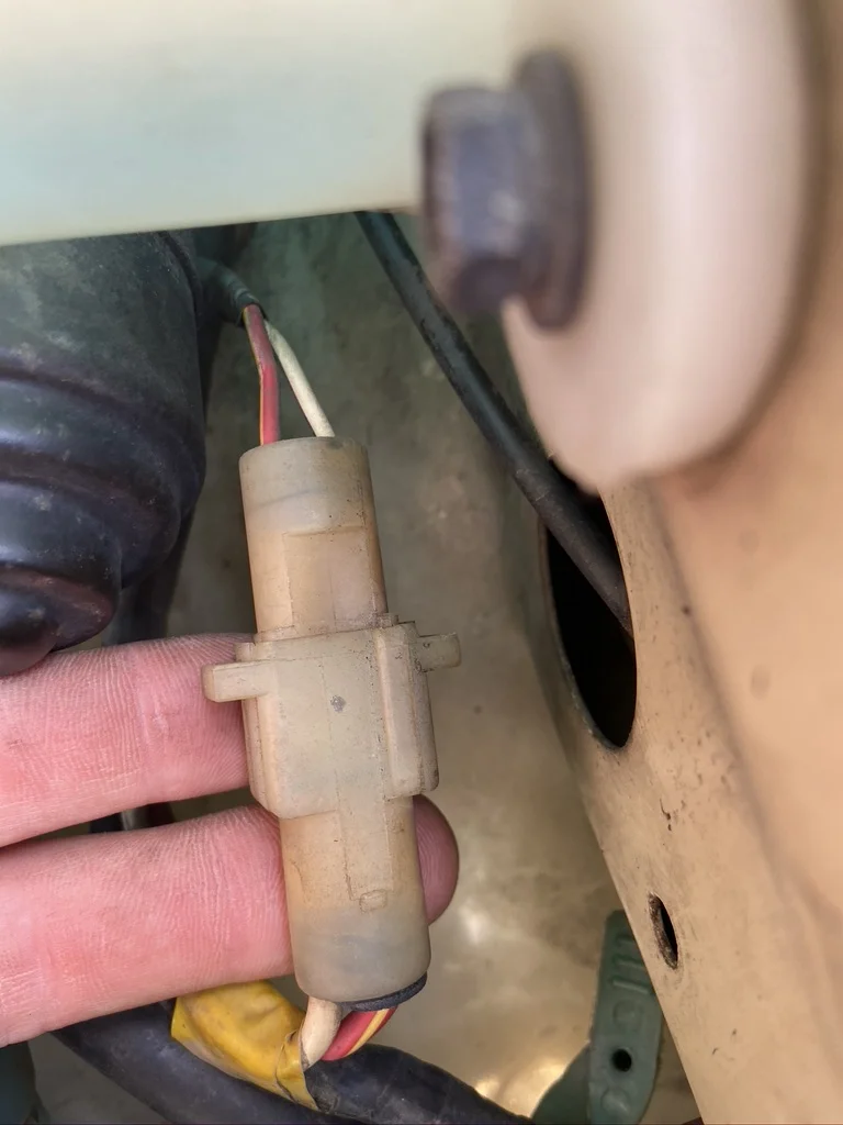

I don’t know much beyond that those look like the connections. It actually looks like they should plug into each other.
Found this on the googles
TIAView attachment 3844132View attachment 3844133

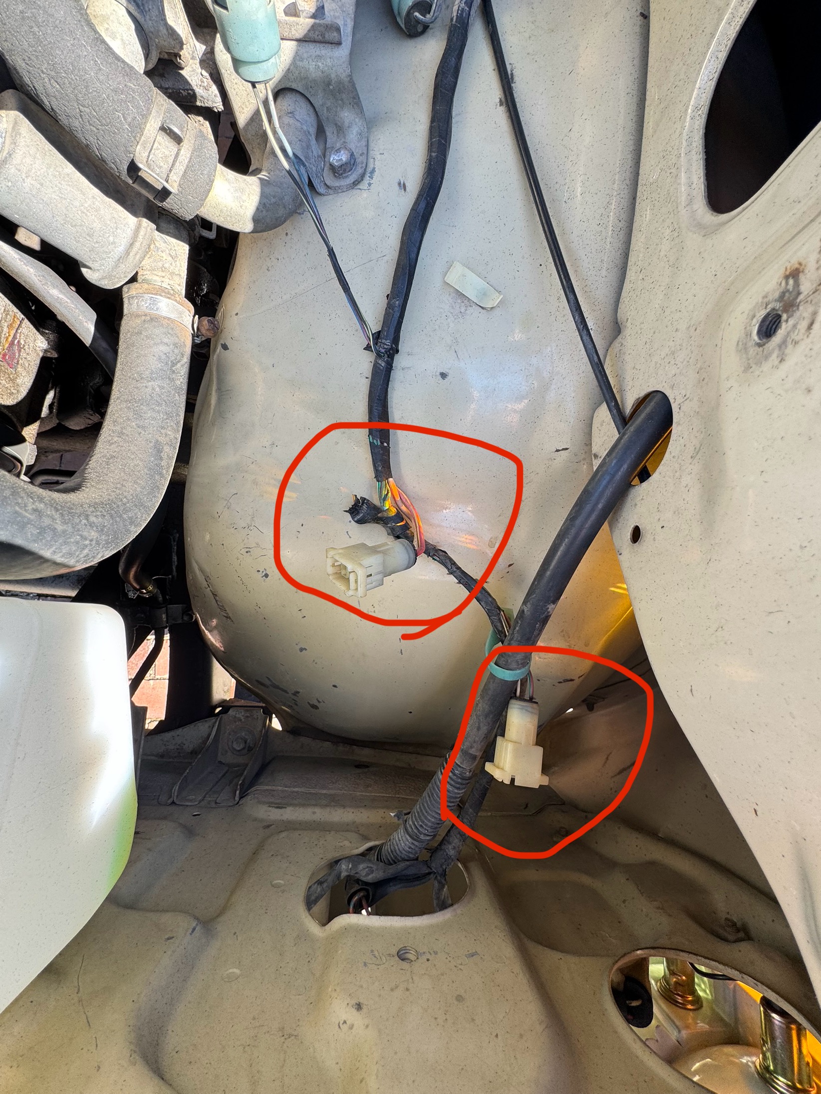

the top connector has a RED wire w/ Yellow tracer stripe and a white wire w/ black tracer stipe
please reply back the Color code tracer stripes of BOTH wires in the lower / bottom connector with the TEAL zip tie

The wires for the bottom connector are White with Black tracer and Red with Green tracer.

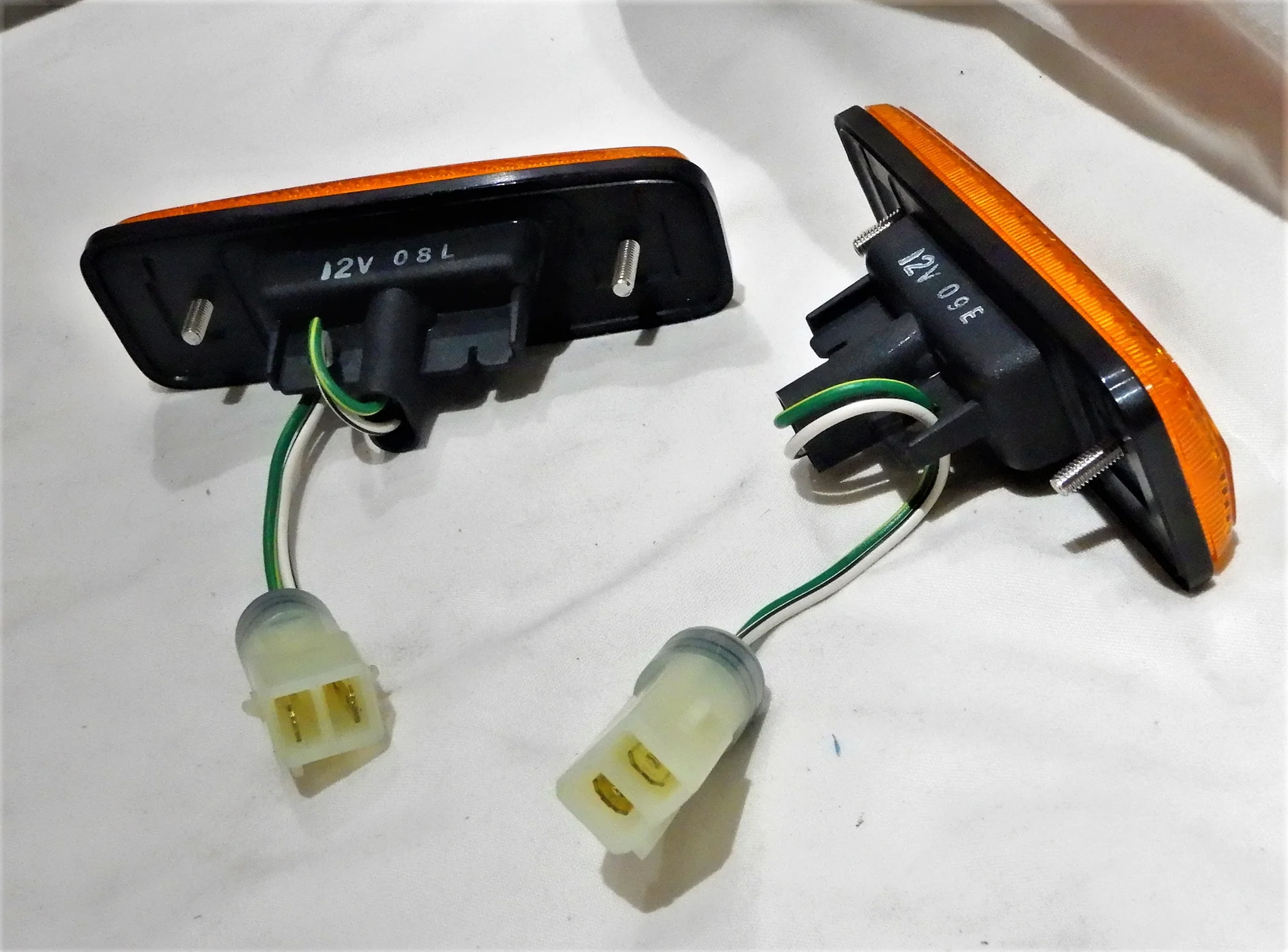

that 2pin natural color YAZAKI splash-proof female connector plug with the red w/ green tracer and ground white / w black tracer plugs directly into and feed your AMBER side marker light assy.
how come its not plugged into your passenger side

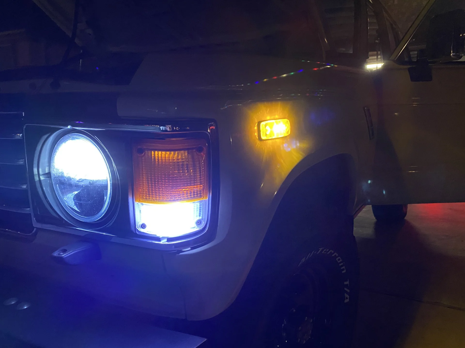

Well.....this is starting to make a lot more sense. I'm new to the 60 world (see here) and took my first night drive in the truck last night and thought to myself, hmm, I thought those front amber marker lights lit up and weren't just reflectors.

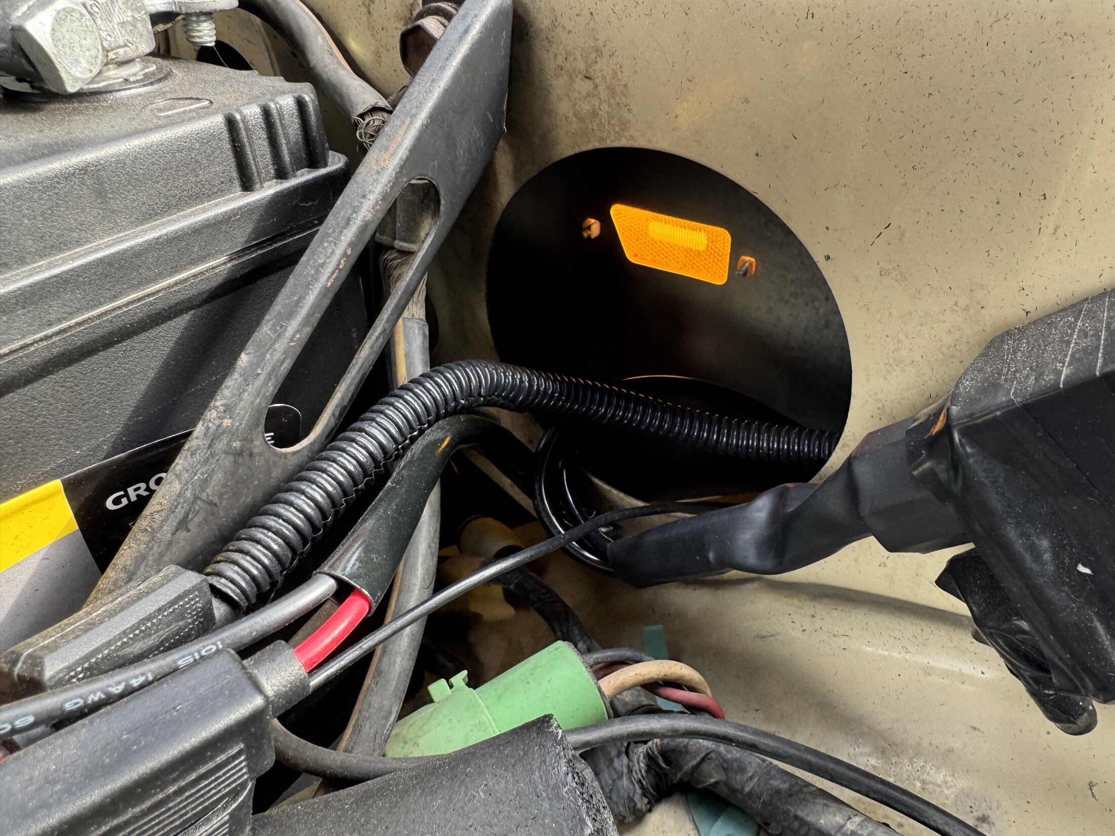

Then, today I had the hood up adjusting my idle speed and looked at the fenders and noticed that there was nothing on the back side of those lights (see photos) which I thought was a little odd.
So, @ToyotaMatt you've solved (most of) the riddle for me🙏; the questions now are: 1) Do you sell these and if not, do you have a part # (for driver and passenger side) - it looks like you do, but are they plug and play? and 2) What is the other plug for then (the one with the Red wire with Yellow tracer and a White wire with black tracer)?
So, @ToyotaMatt you've solved (most of) the riddle for me🙏; the questions now are: 1) Do you sell these and if not, do you have a part # (for driver and passenger side) and 2) What is the other plug for then (the one with the Red wire with Yellow tracer and a White wire with black tracer)?

other plug RED w/ yellow tracer is head lamp washer pump motor hook up
your bottle and pump are AWOL ,
just tape over and tape cap that plug for now

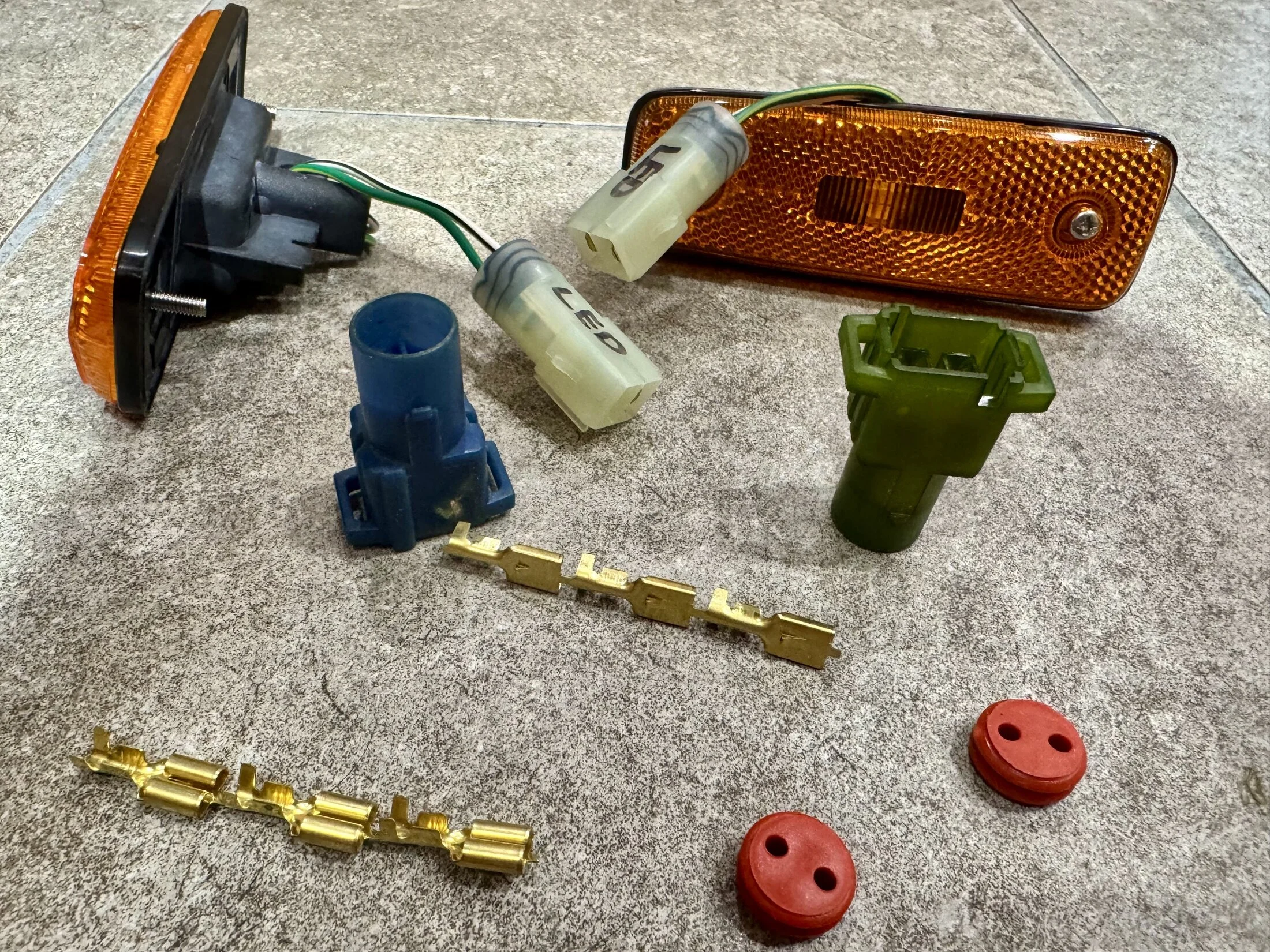

View attachment 3844929View attachment 3844930
I included new OEM harness side connector plugs , seal plugs and extra terminals
Use these !
Refresh your crimped connections and UV hurt Harness side plugs / housings ..
Those ones are YELLOW from age time and
the fact the Earth 🌎 has less Ozone due to Global Science Facts Warming to protect our Precious Vintage YAZAKI JIS nylon …..
Poor YAZAKI UV sadness ….,
But your set up for success now
Thanks !
