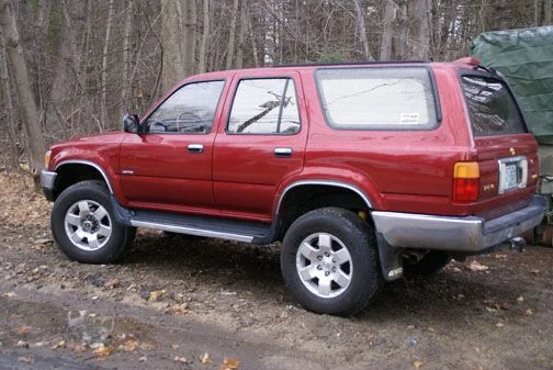

In my experience, I needed spacers but not much... I had the rims pictured in post #1 but can't remember if they were the 15's or 16's. And I had a 1993 IFS 4wd 4Runner at the time. And no, they would not "bolt on".

The tardy update is that the 16x7 Taco wheels work just fine. Center caps pop right out, as you can see from my manual hubs. I went with some relatively small tires for the time being because the price was right.
