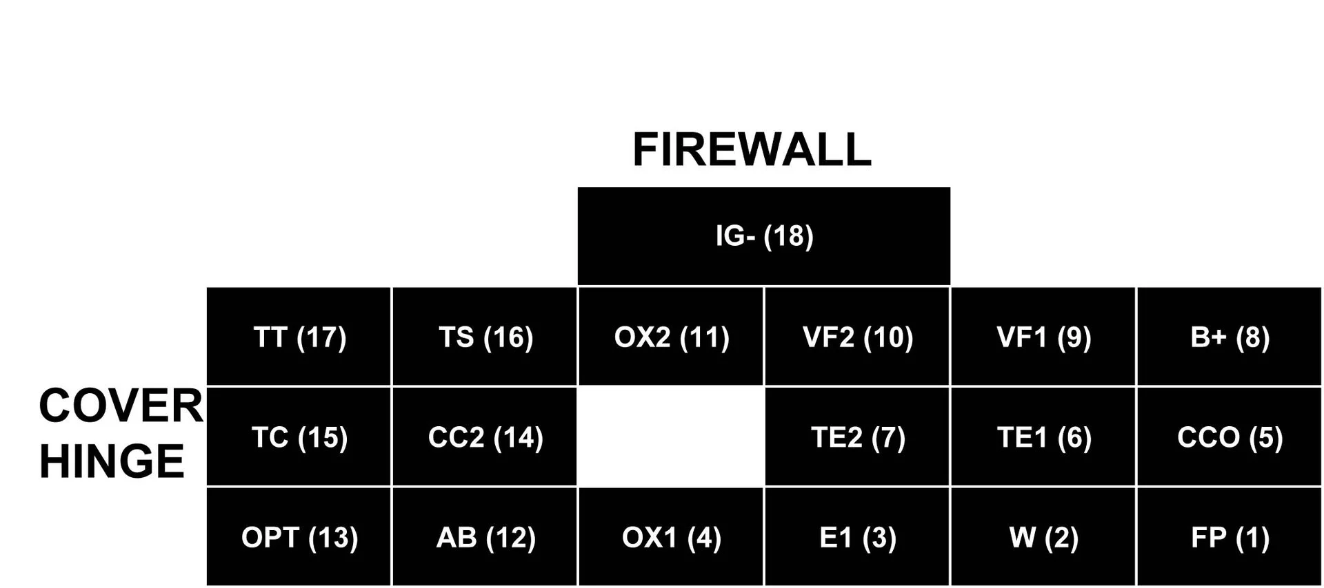

Jump terminals 1-8 on the diagnostic connector on the firewall and turn the ignition key to the ON/RUN position. Assuming all the fuel pump wiring is intact and you're getting a CHECK ENGINE light on the dash with the key in the ON position, that will fire the fuel pump without cranking the engine.
