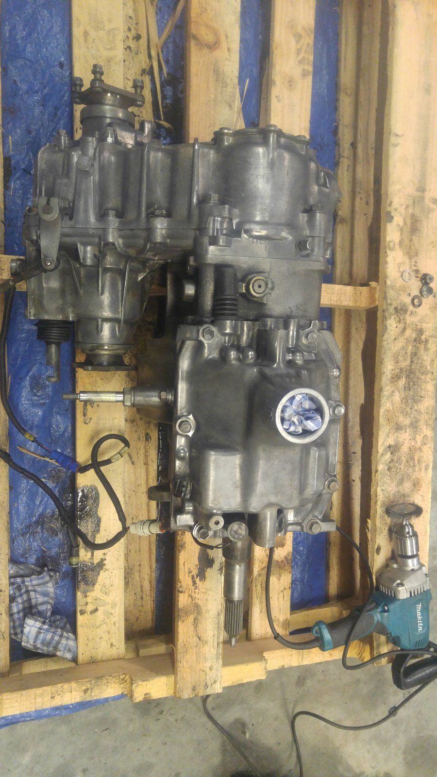

Was successful at cutting the engine mounts out lf the bj60. The driver side is will need be replaced. Got the h55f soaking in some fresh gear oil. Hoping for zero leaks in the AM.
Topo of the h55f cleaned and ready for install. The one that came original in the wifes Canukee had all kinds of issues and the one i got to replace it in Merritt BC wont shift into 5th gear so ill swap this one out for that one and have it fixed. Pretty sure its nothing serious as the tranny works proper otherwise.
This 5 speed shifts nicely. Need to get a clutch on order from sor and get the flywheel machined as well for the conversion. Canukee juat got the full package a couple months ago.
