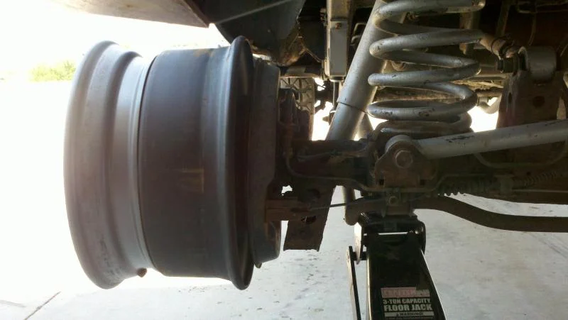

37" military OZ tires
Hay NAY how heavy is your wheel and tire?
About 100 lbs. I'm just giving you crap, but honestly I think you're lucky if you get a used tire like this to really balance perfectly.

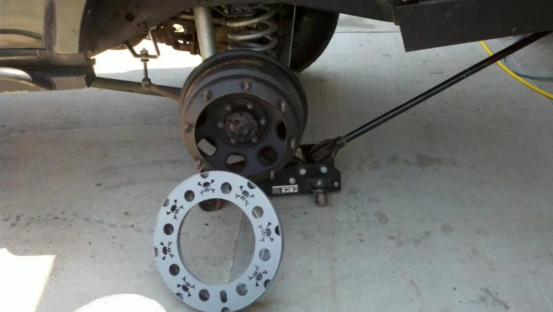

well bean on the telly withe cdan.This truck has 167k miles on and was all stock and sat for about a year or so.
So I opted to do a front end refresh.I have trunnion,/ wheel bearings and all the seals on order.I also figured that wile I am in there I might as well do rosters and pads so I oped for I think cdan said Tacoma pads are a good choice.I need to order a steering stabilizer soon and then get the tires a balance job.
We will go from there.
Also working on my A.R.B. FRONT BUMPER mocking up a tow bar and a multi mount winch slot and a lower front skid plate.:wrench::wrench:
I would think the heaver the tire and wheel the more the chance of braking something?
Generally ya'. Not sure what the hummer tires weigh on their own. I'm guessing that 140 is alot of weight in the bead lock rims. More unsprung weight also does bad things for your suspension performance, but if you want big tires, you just have to deal with it (a good set of shocks will work wonders at this size).
I guess I've been lucky. I've had 7 mounted and balanced ( 1 punchtured sidewall w/ a tree, 1 sidewall puncture w/ nail, 1 damaged from bumper hitting, 1 I just didn't trust the looks of it :) ) - and they've all balanced out. They've all taken a fair amount of weight, but most 37's do. At this size, unless your running 18 or 20" rims, the rubber is getting pretty far out from where the balancing weights are. In theory that's the advantage of the balancing beads / BB's, the weight is out at the outer circumfrence of the tire.
so after my lift I have not had a alinement. the new tires & wheels are not balanced and the steering stabilizer lost all it's oil and the wheel bearings keep backing off;p ....
:hhmm:Do you think this might have something to do with the wobble:doh:
I will be doing some:wrench::wrench: and spending more $$ but I think it will all work out just fine after I do all this s h i - but it will be worth it in the end.
I will post after I start working on it just waiting for some new parts.:grinpimp: and my back to get better after lifting that damn 140 lb tire & wheel on to the spare tire carrier

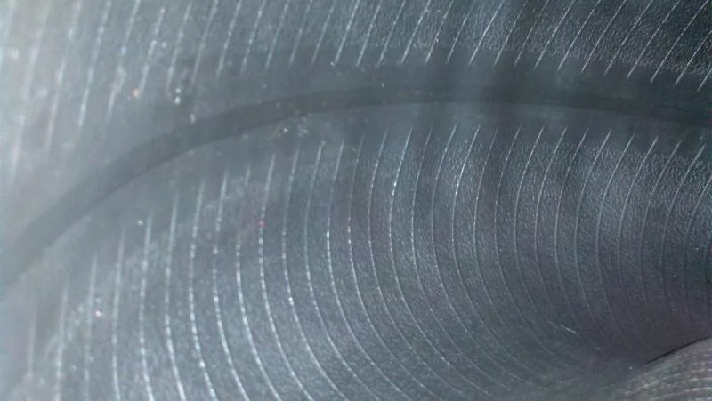

I think this tire has some bad belts.What do you think?
Man, I've got to get me a set of those wheels.
Having never seen the inside of this particular tire, I cannot speak to how it's supposed to look, but it does seem a bit lumpy to me.
