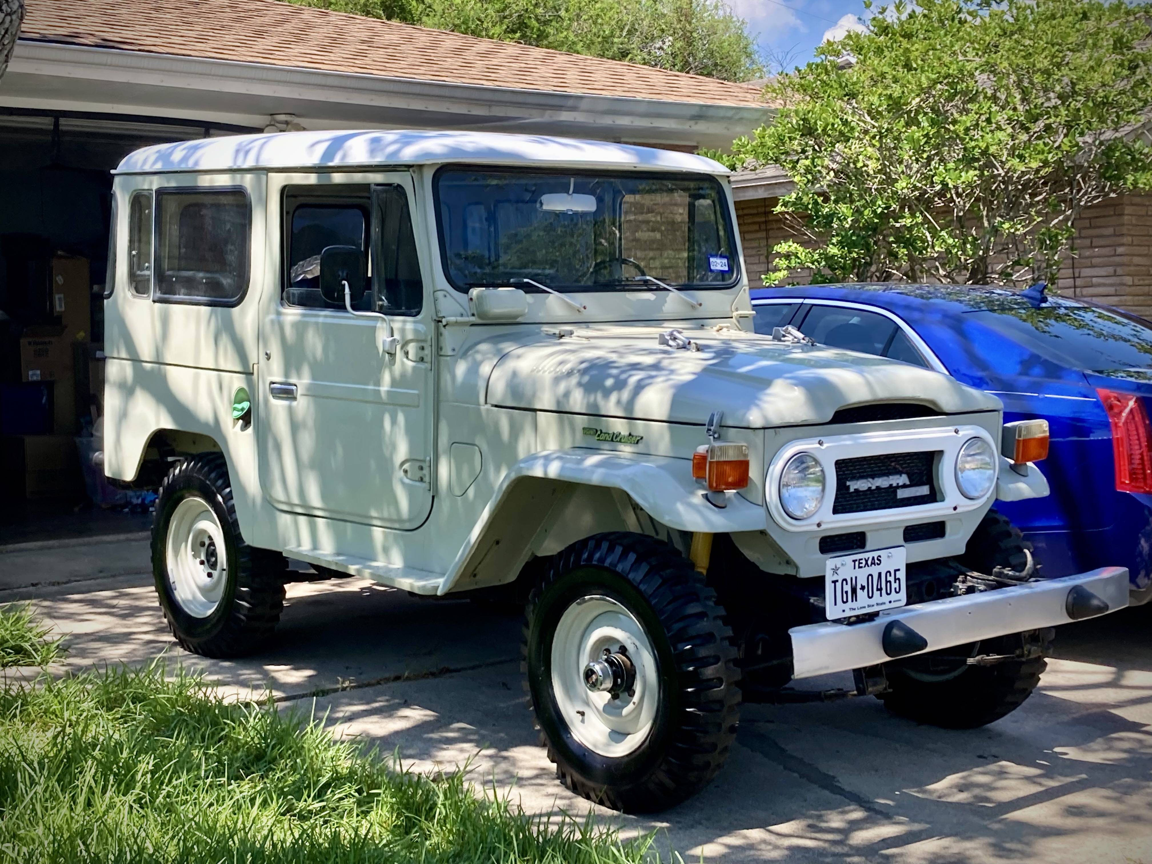

I plan to install a set of BFG K02s in the near future and I know the tires will be larger than the military set my BJ40 is currently sporting. I'd like to buy a Hi-Lift jack but I wanted to mount it inside the 40, under the jump seat. The only size jack that will fit is a 36" . The 48" is too long. South Texas is pretty flat country and I don't see the 40 making a trip up to the hill country. Basically, mine will be an asphalt queen.
Question: Will the 36" jack raise the 40 enough to safely install the spare tire?

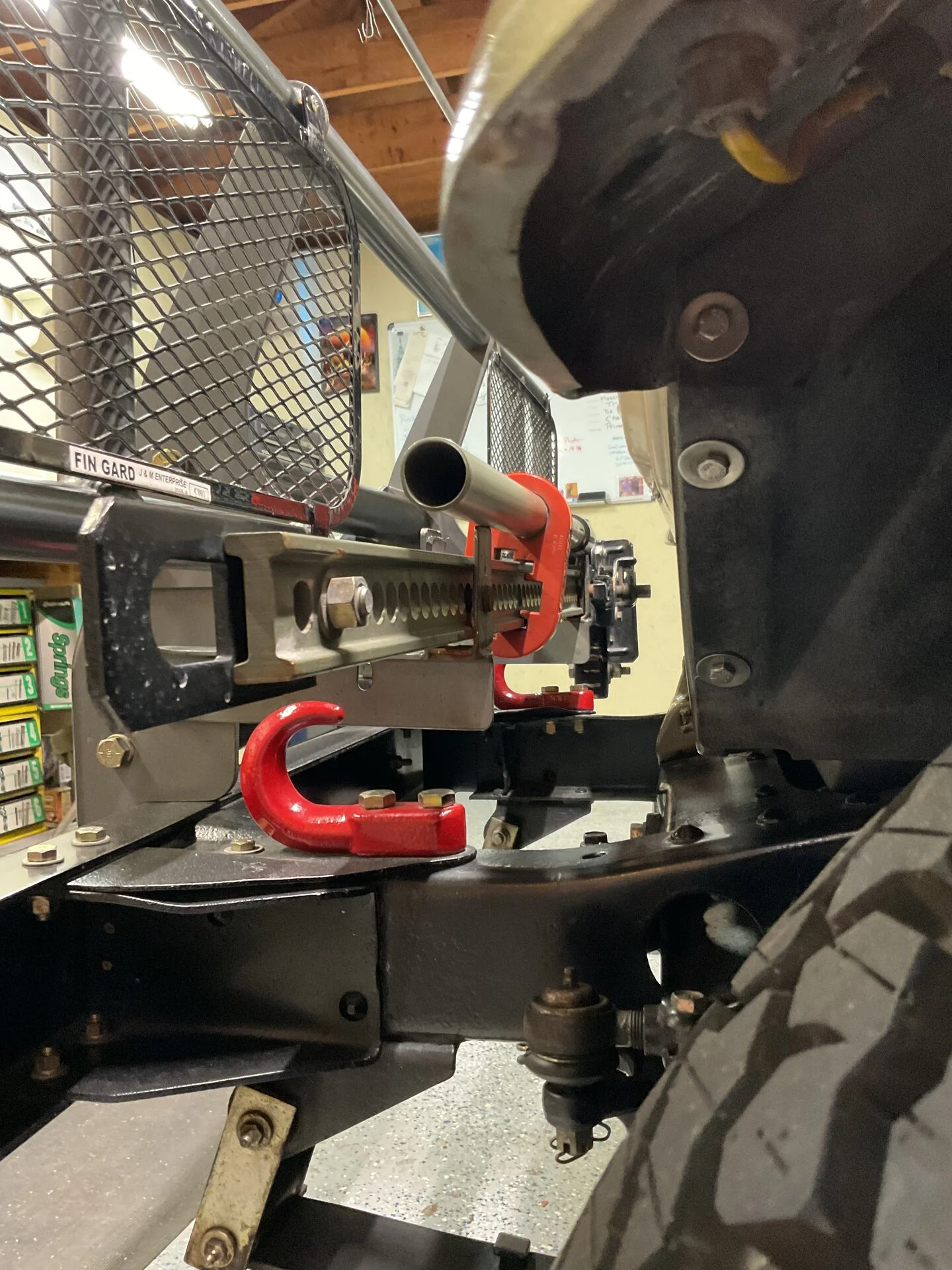

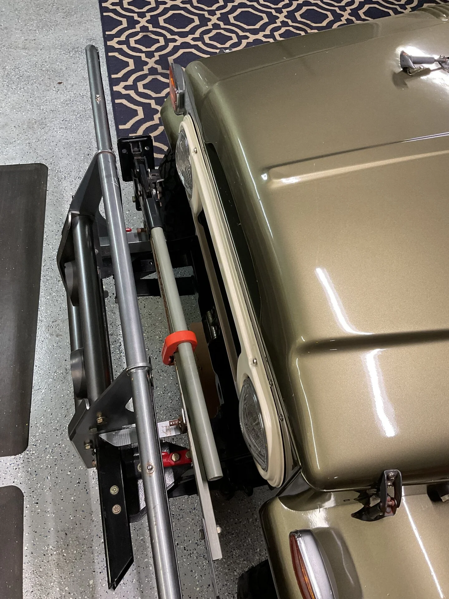

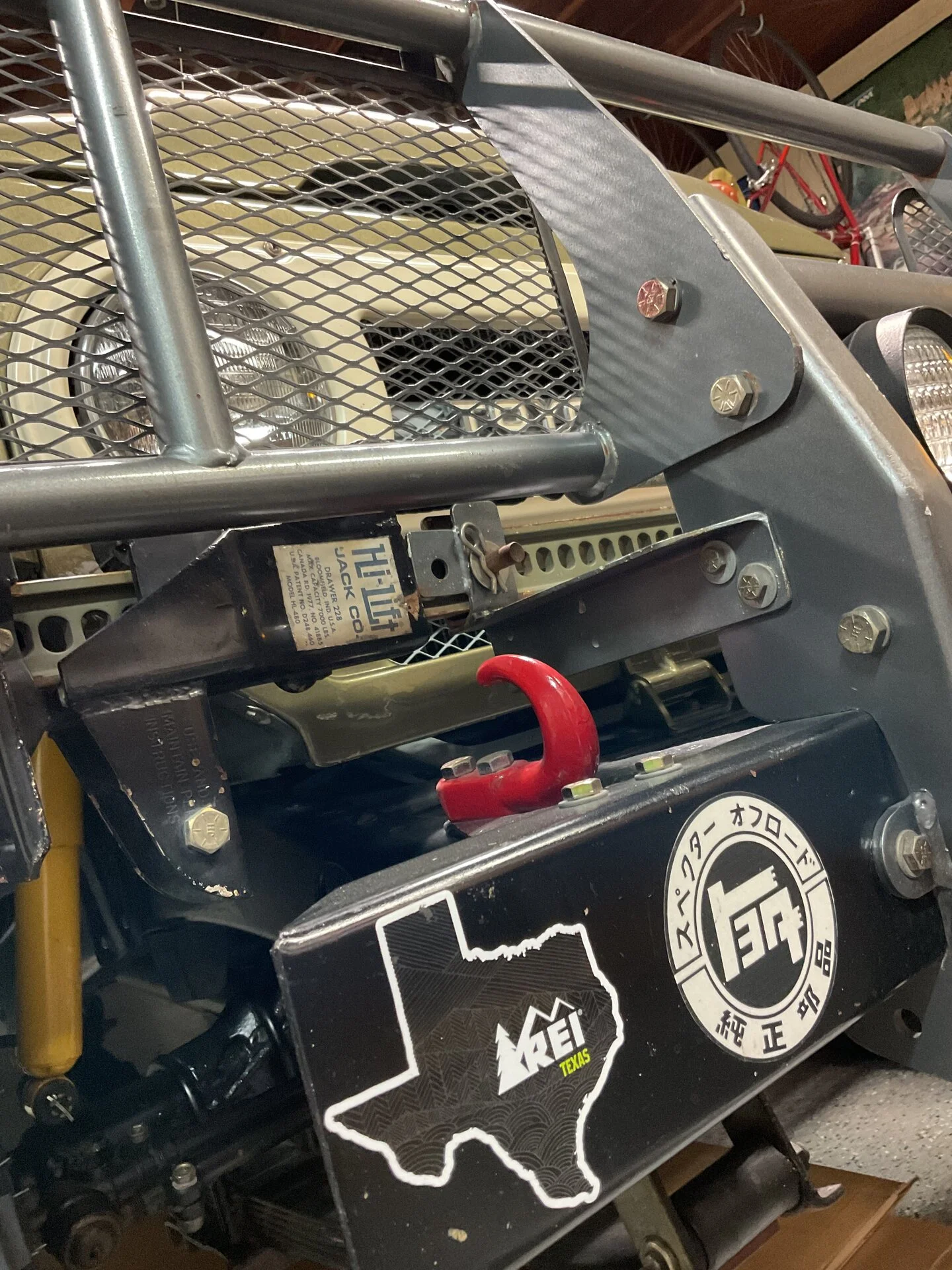

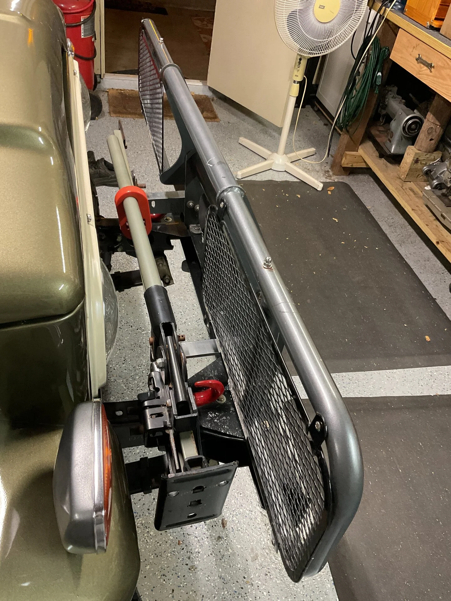

Here’s how I mounted my 48” to the front
