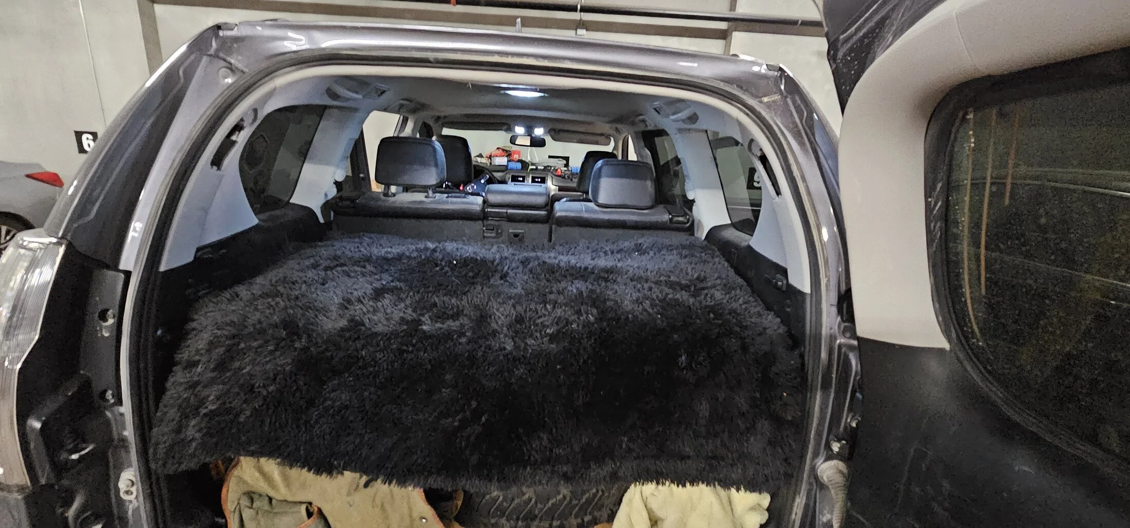

Yup. With seats in the back and without. Just be careful ratcheting it down - you'll want it pushed as far forward as you can.
  • Like
Reactions: r2m
Thank you so much for the reply and pics! With the seats still in, how do you secure it?
I used a ratchet strap on the stock tie downs. I figured as an interim solution it was fine - it can't move fore/aft because it's basically the entire space between the seat and the door.

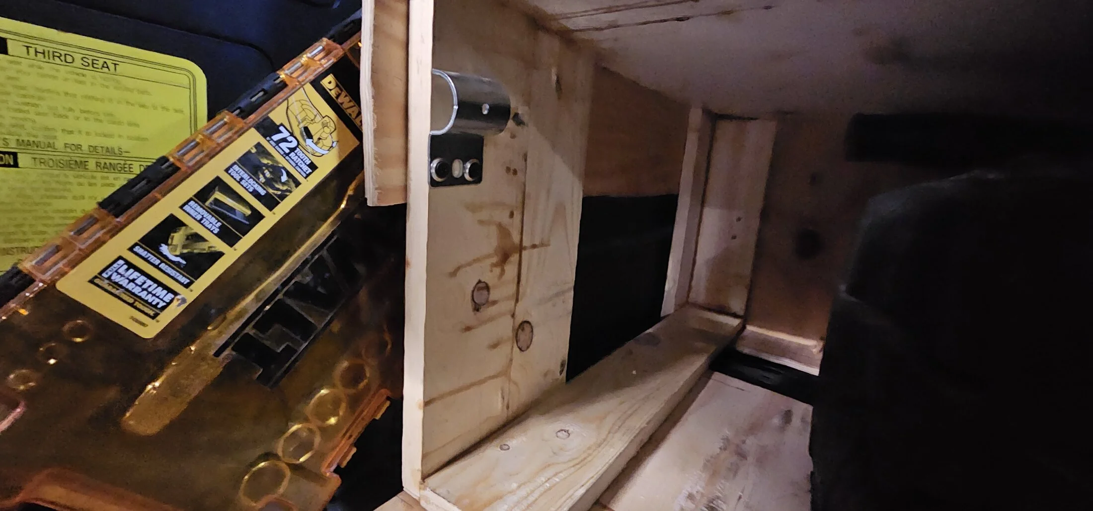

Here is my setup. I find this works better for me in maximizing usable space. I use turnbuckles to tie it into the existing tie downs. View attachment 3776718
You could twist the turnbuckles till they bear down on the spare tire to hold it in place and not need the side boards. Being a round surface, if you don't torque the turnbuckles too much you should still have a flat surface and the spare tire would be secure since it'd be sandwiched between the board and floor bed.

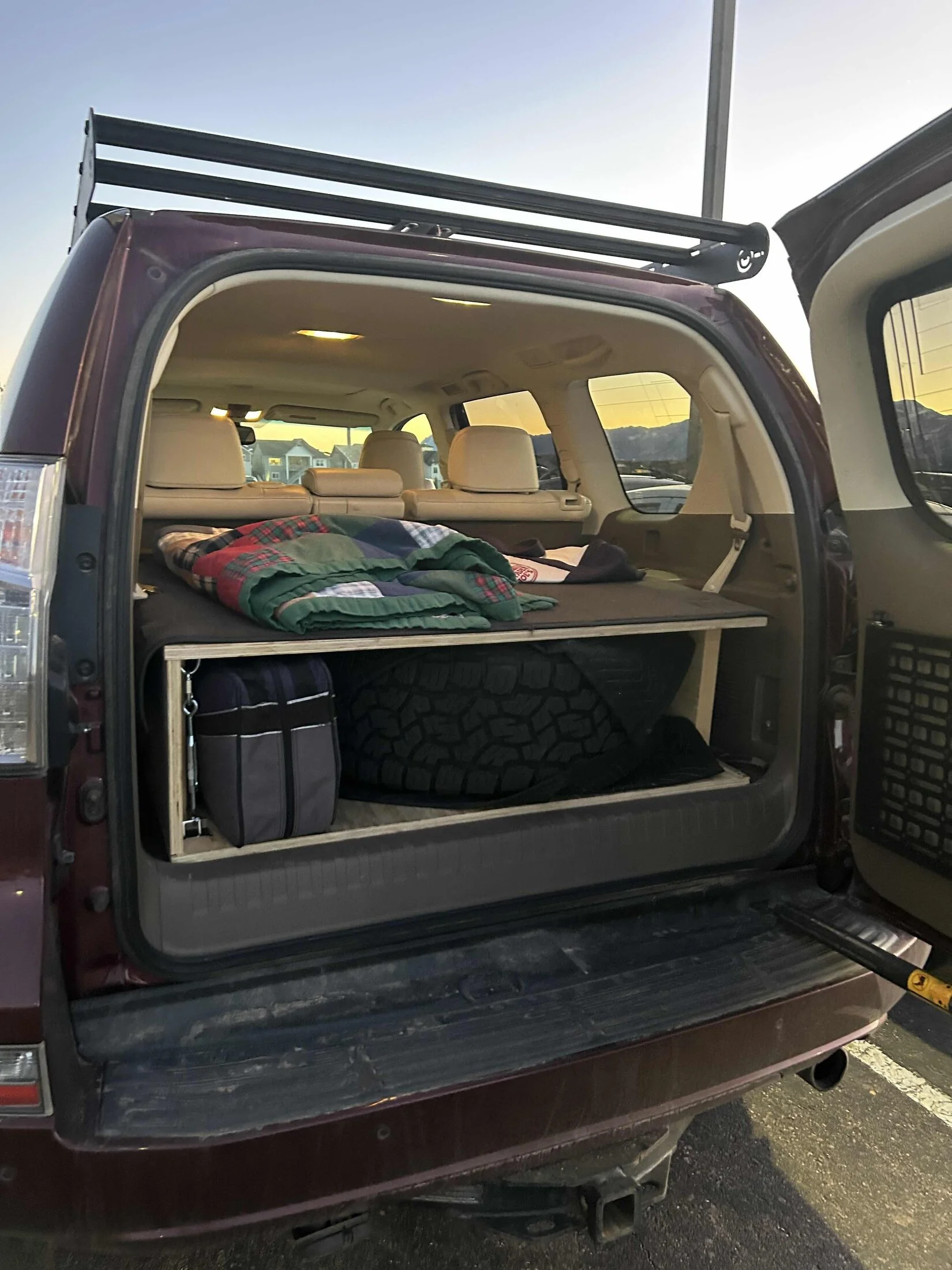

Good idea! I landed on this setup because it allows for the tire to be removed with out taking anything else out of the cargo area. The tire also slides in and out easily on the wood when I do my 5 tire rotation...which i just did this weekend! I also keep my tool kit and emergency bag in the space around the tire. Access to the tool kit is from the middle with the seat folded down.

@RadoTracks this is such a good idea! Did you just make it squared off or did you actually contour it to the back? I appreciate you sharing all this info!
Edit: Now that I'm thinking about this, it would almost have to be squared off if you want to be able to pull it out!

You can have a contoured board/shelf. To remove it, lift up one side and it'll come out. As long as you can dip the low side, lower than the tire, it should come out easily. Regarding the the turnbuckles, dropping the middle seats will give access to the forward tie-downs.

Turnbuckles:
For the bottom/floorboard in the back, there are already chrome plated rectangle "tie-downs".
For your plywood board sitting on top of your tire, use eye-bolts going through the plywood with fender washers on top of the plywood. The fender washers will distribute some of the load and keep the eye-bolts from pulling through your plywood.
I suggest using a pretty thick sheet of plywood, 3/4" to 1" for the 'shelf' so when you tighten down the turnbuckles (not TOO much) you are not pulling down the corners of the plywood shelf.
