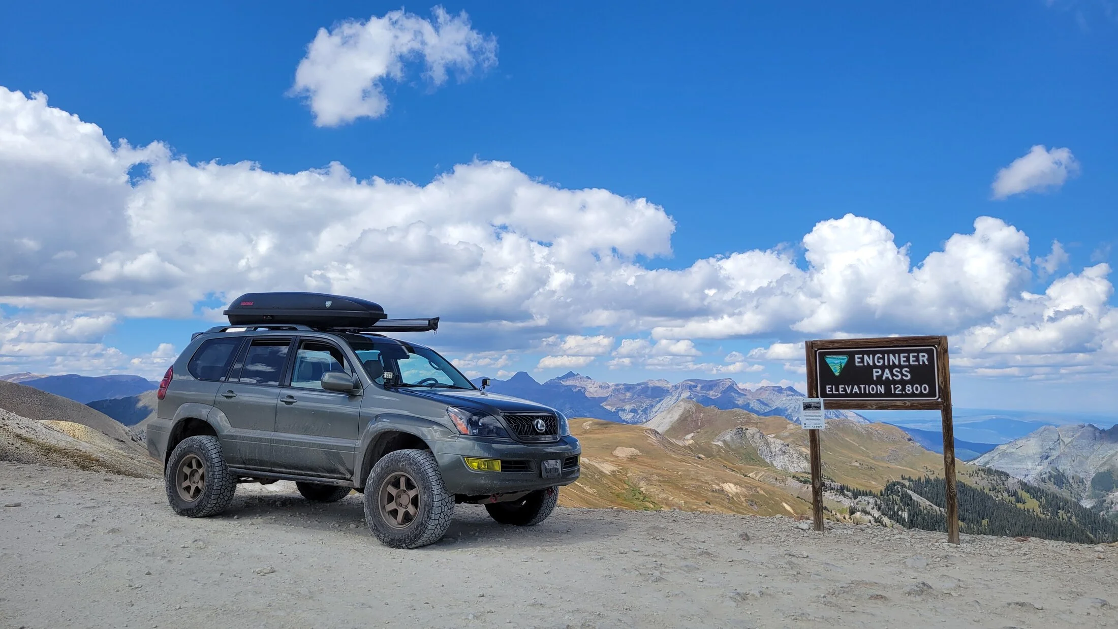

I use a Thule 614 Pulse on my Gamiviti rack. That model has lots of adjustment available for bar position and style. Mostly quiet under 70mph.

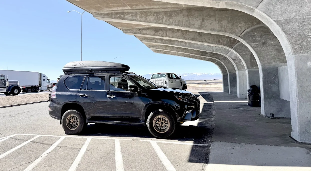

I've had an older Yakima Rocket Box for at least a decade or so. I think it was around $450 at REI when we got it. It's been down to the Gulf several times and I had it on the rig to CO and back last summer, including doing some heavy wheeling with it. It's a nice box overall and it was super-handy to use, as my buddy who rode with me put all of his stuff in the box, instead of it mixing with mine. We've never really noticed a significant MPG reduction or wind noise from it either.
Once nice thing about it is that since it's basically a half-width box, the other side of the rig is still open for a bike rack, awning, etc.
The Yakima stuff seems to be cheaper than Thule but, IMO, holds up just fine for occasional use like ours.

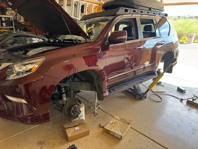

I've modified an older Thule box for use with my Victory 4x4 rack. I bolted aluminum 2x2 angle to the box, then bolt the angles to the rack cross bars. That way all the hardware is easily accessed and there is no concern of the cargo box feet making contact with the roof if you are loaded heavy.
