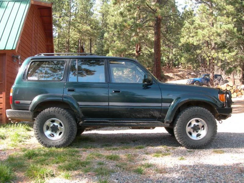

Here is a driveway pic of the 315's. Have not wheeled it since removing the 295's in November
Power button is always on both my 80's. It never felt right even w/ stock tires w/ the power button off. I haven't felt the need to regear yet but will when I jump up to 37's.:) For speedo correction I use a Scangauge in each rig. You'll want to get one of these anyway because it provides engine info like water temp. and engine fault codes. A cheaper alternative is an Ultragauge. I would've bought that brand but they weren't out yet when I got the Scangauge's.
