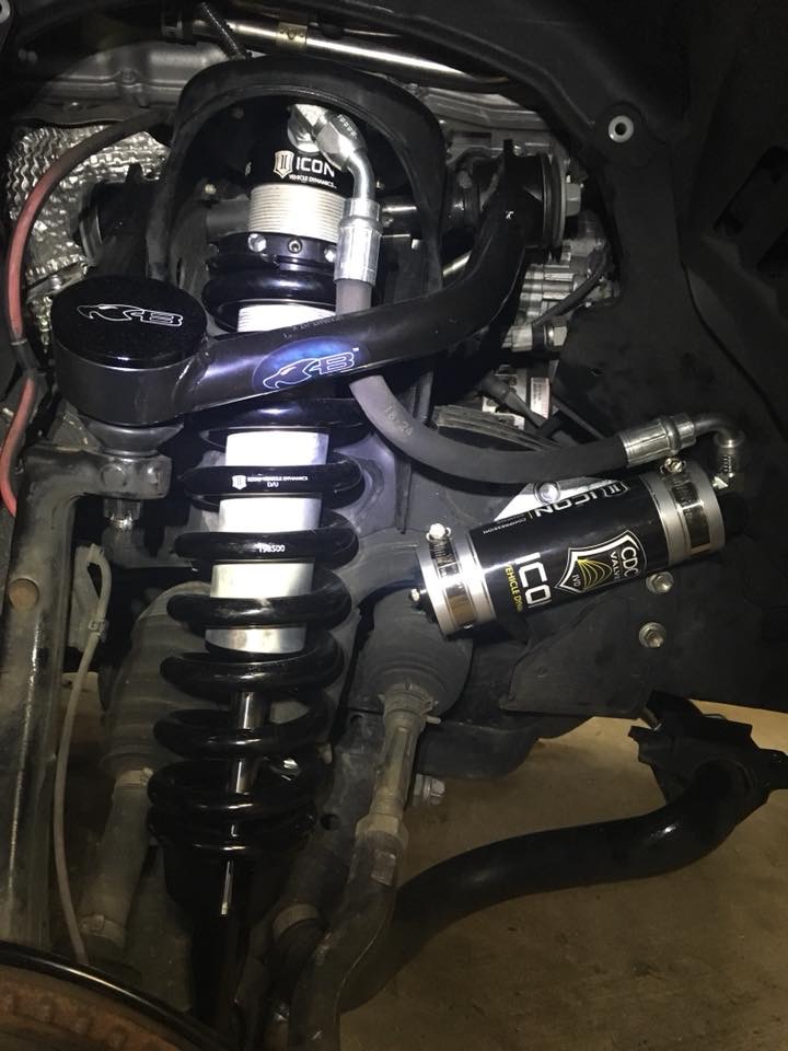

SUSPENSION:
FRONT ICON COILOVERS / REMOTE RESERVIORS / ADJUSTABLE CDC
REAR ICON SHOCKS / PIGGYBACK RESERVOIRS / ADJUSTABLE CDC
REAR SLINKY LONG TRAVEL COILS
ICON BILLET UCAS W/ DELTA JOINTS (recently replaced the Blackhawk UCAs)

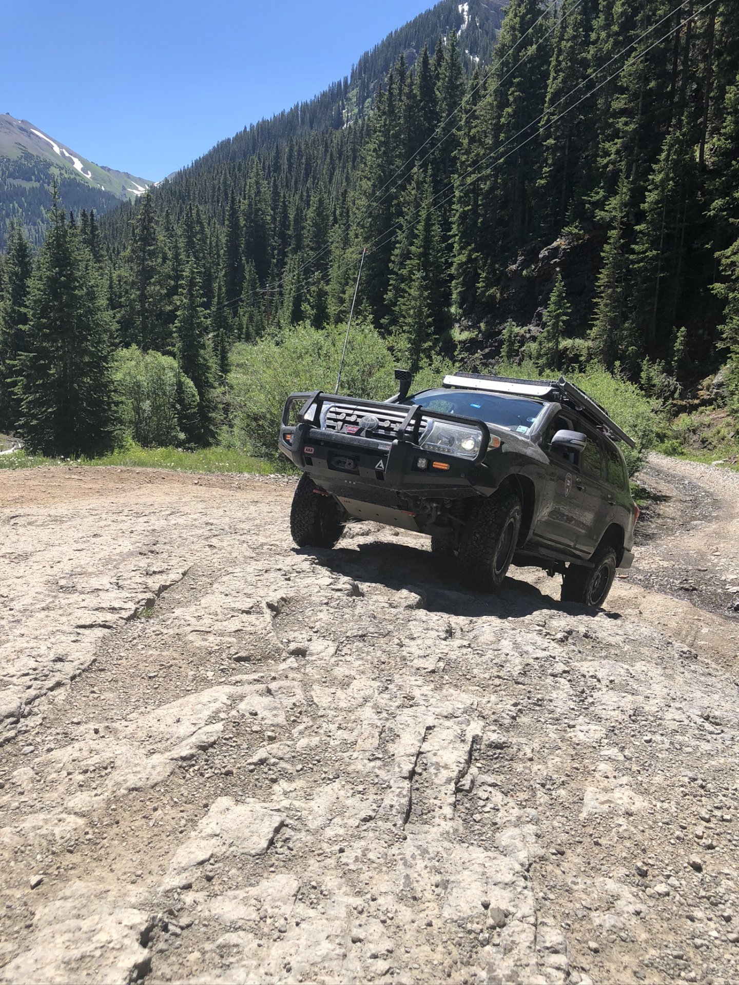

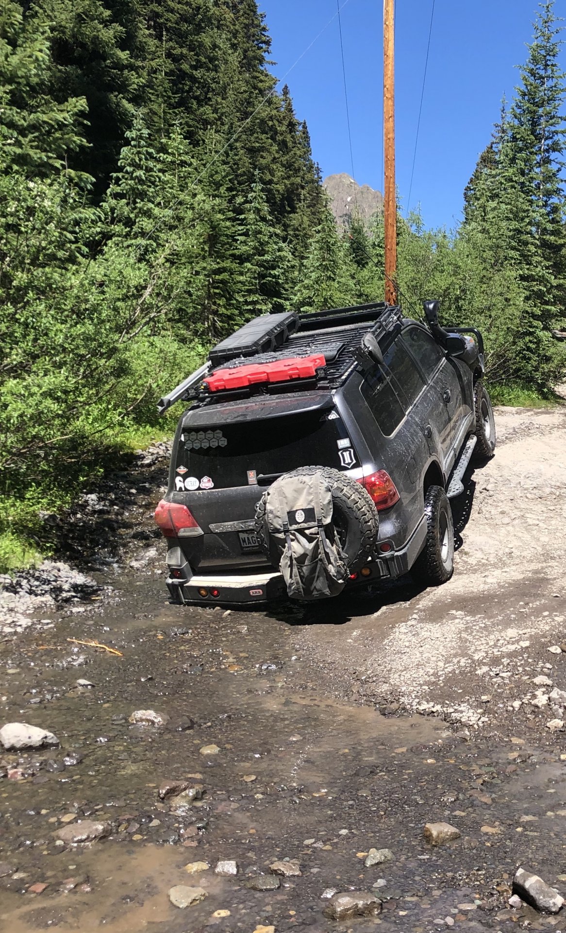

View attachment 2758752View attachment 2758753View attachment 2758794

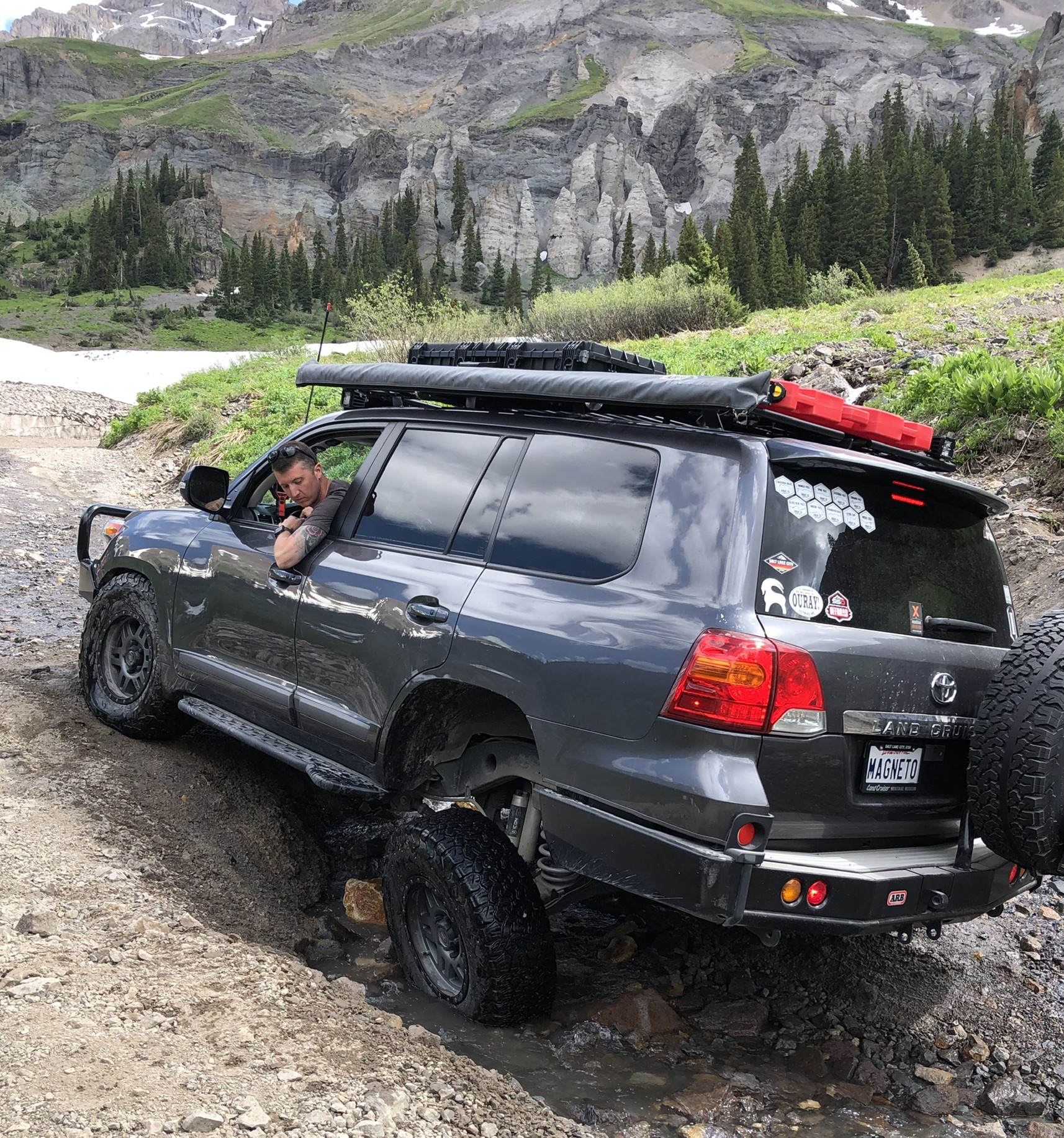

That is flexing!

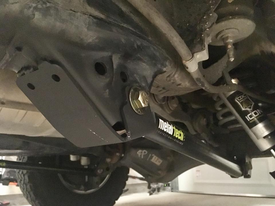

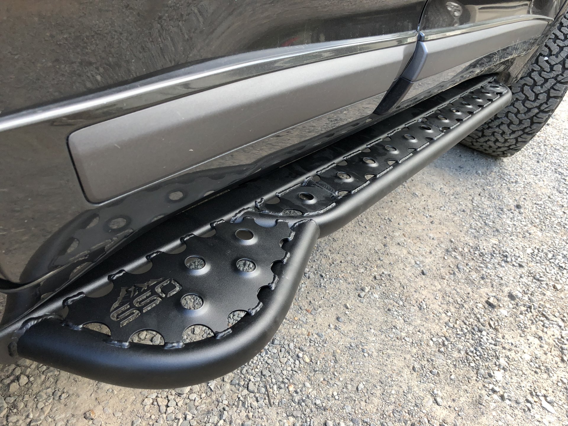

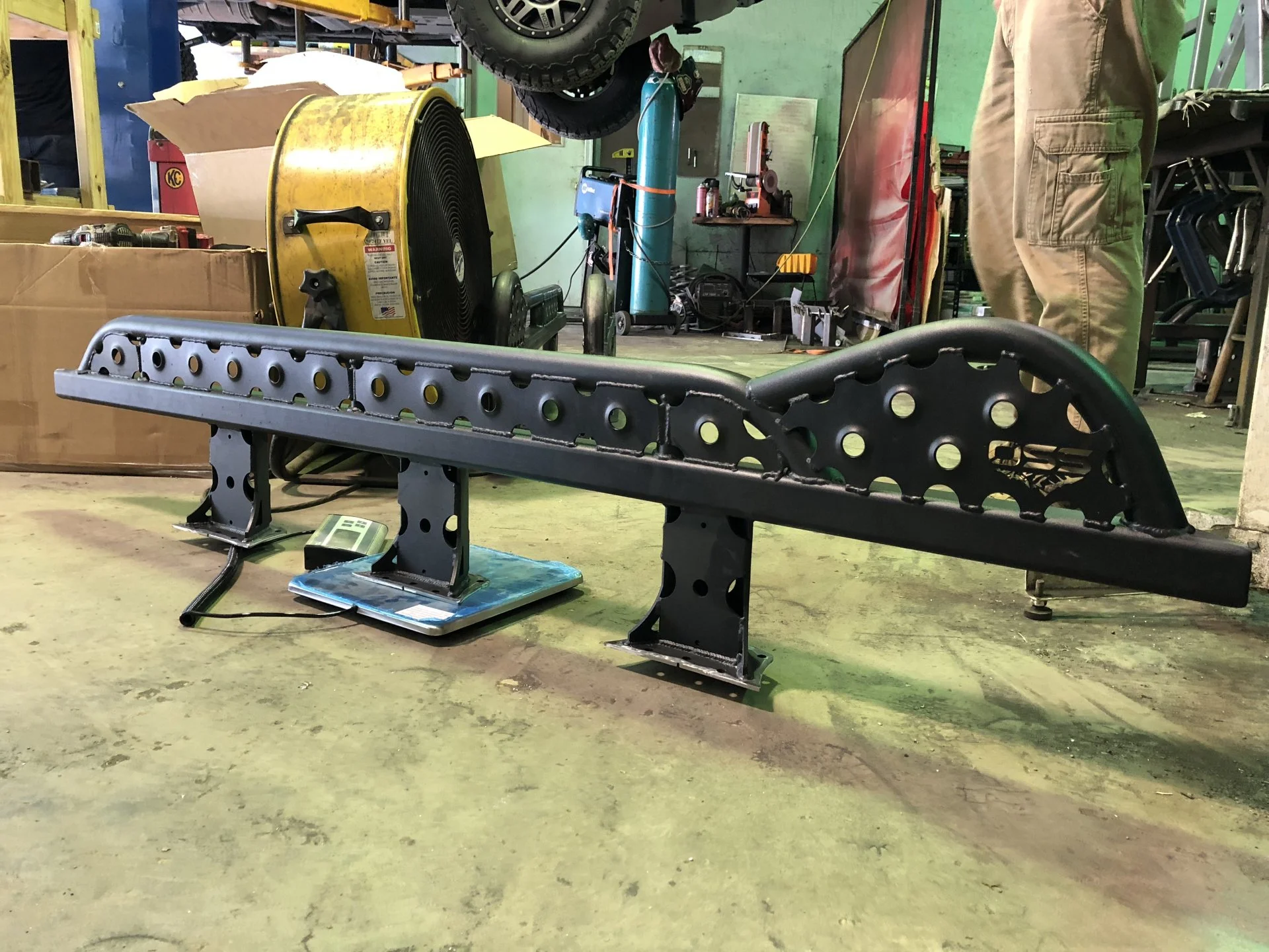

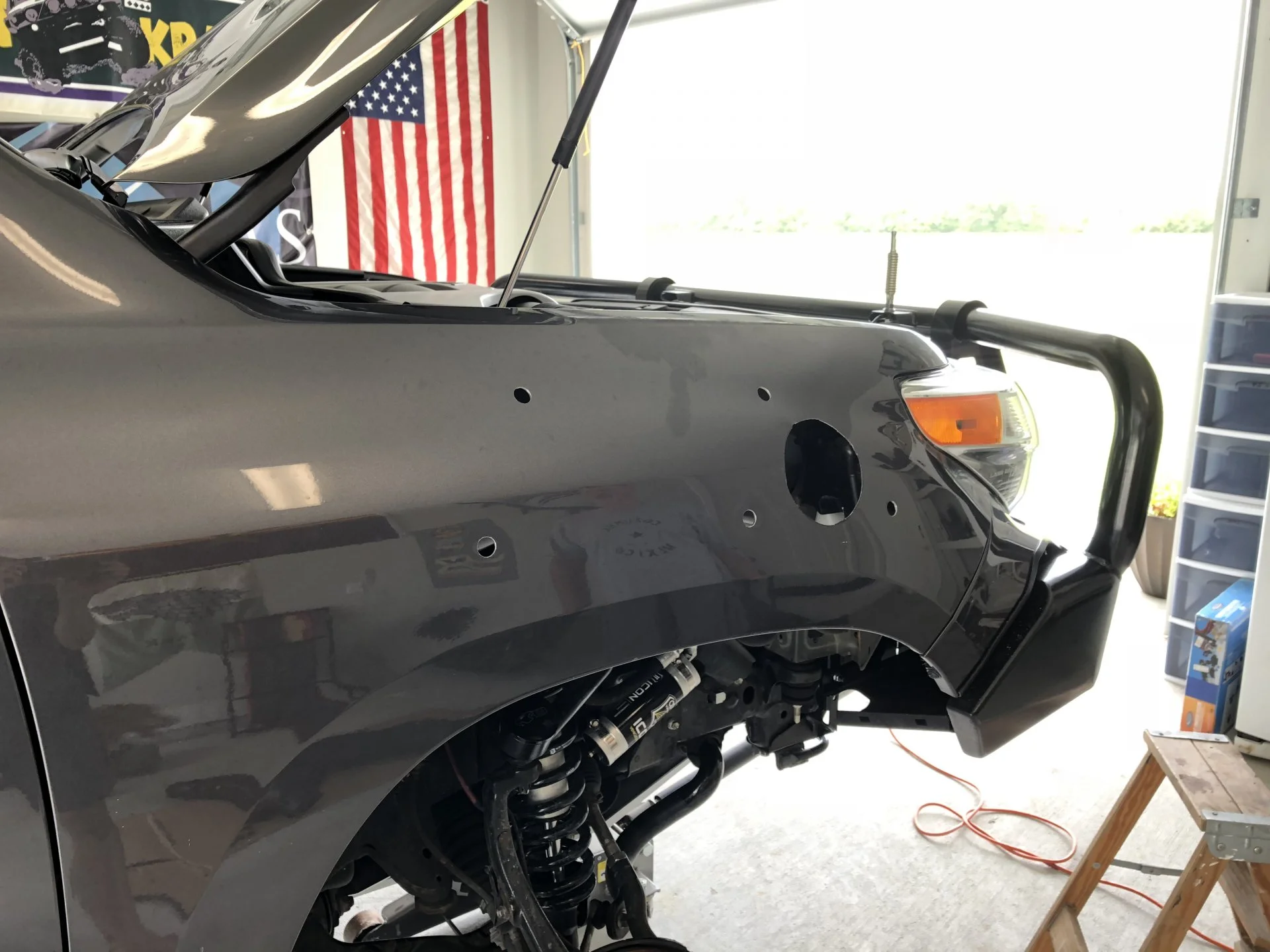

Did you drill those 2 holes and put the bolts in and just posted this pic before hand? If not you should go back and do that. My first set got mangled up because I thought I could get away without having that, and boy was I wrong
Didn’t put the bolts in. Welded it in place instead
