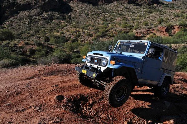

In the first pic, I am running everything you stated above - J's + 30mm Spacers rear, MetalTech 2" Front + 1" BL and I still had serious rubbing issues with the 37x13.5x17 Toyo MTs. Switched from 1.5" wheel spacers to 1" with no improvement

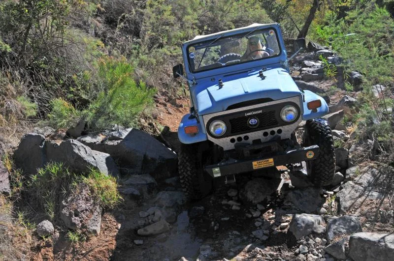

2nd pic, I have switched to FOR Gen II springs, removed 30mm spacers from rear, trimmed fenders 1" F&R, 1.25" wheel spacers and now have ZERO rubbing for the first time since 33s. :)

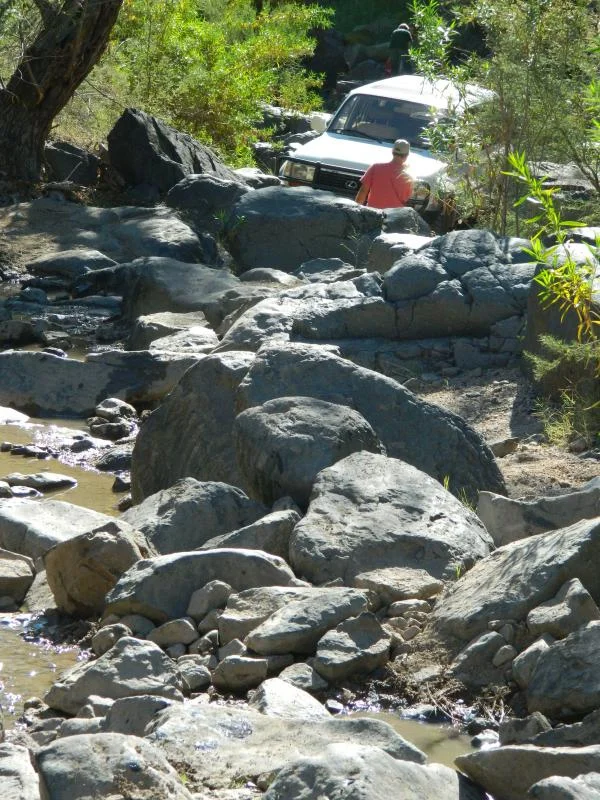

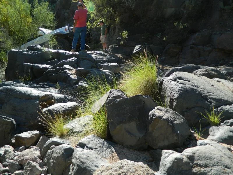

For example a run from a couple of weeks ago. Had a rig with 33"s, she made it, but line selection was limited, had to be precise and struggled the most of all of the rigs. She has the advantage of size, can sneak between things that we cant.
attachment.php
attachment.php
Bigger tire rigs are more capable, so have more choices for lines. You are not going to run this type of stuff with 33"s, once the axle, etc, is on the rock you are done. When the rock or ledge is under cut, a 33" will stuff under it, you are done. A larger tire will roll right over it.
