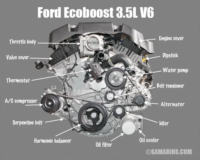

Height should be attainable with a mild body lift (if needed) and a 4" suspension lift. It is a rear sump engine just like the 3FE.
Width should be fine. "The F150's 3.5L Ecoboost engine is just 28-1/2" wide across the turbos, and just 22" wide across the cylinder heads".
Discard the A/C compressor and use the mount for a power steering unit.

Take a look at what year engines to use. Here's a tip. Also look at the ford transit vans. Oil filter location is diffrent and the steering also. Cant remember off the top of my head but I believe the f-150 have electric steering. The transits still use the previous gen unlike the f-series trucks that are on gen 2.
They do have electric steering, I think the A/C compressor could be removed and a power steering pump put in. Good call on transit vans. Mustang motors will bolt up to the 4x4 transmission as well.
