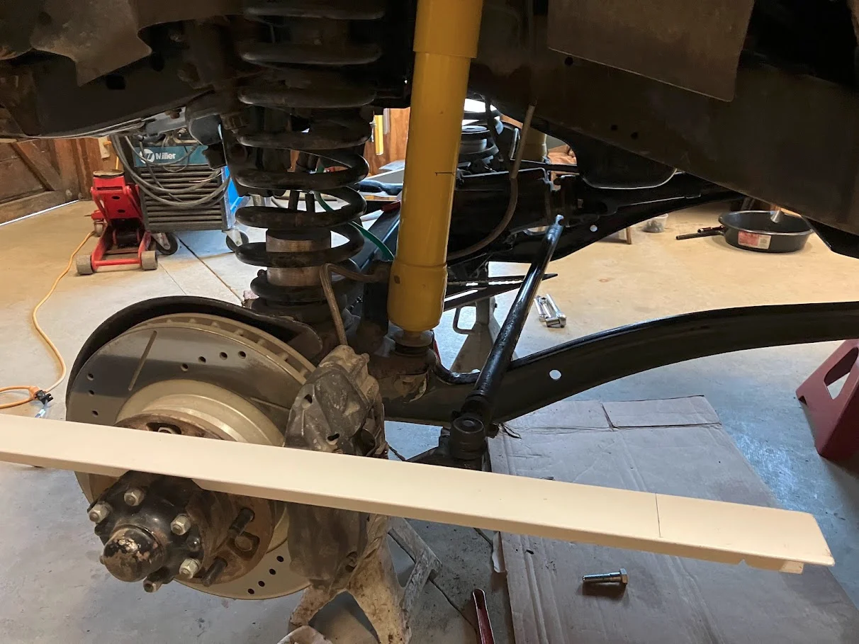

insert toe plates
Or super easy to make your own, good for tires up to 40"
