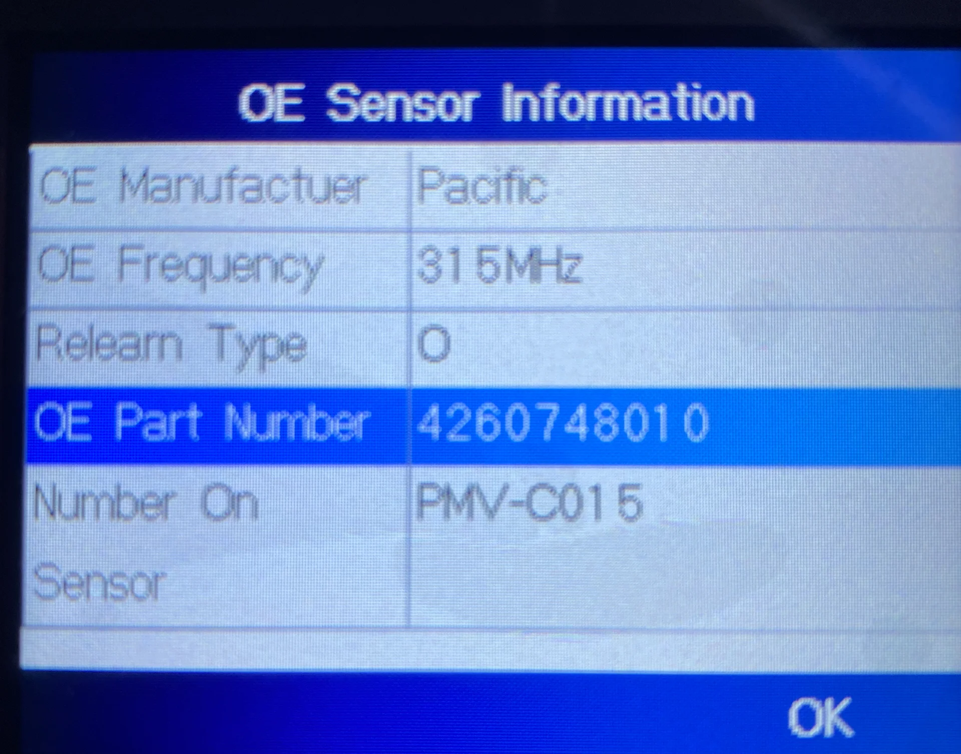

IMO the smart play is buy one of the official Toyota sensors to get the PI number off of it, then buy the rest boxed as Denso/PI.

My Autel says for a 2015+ LX this is the sensor to use.

The instructions on the tool didn't say anything special about programming it, use the trigger to read all 4 and write it, which fairly generic.
If trigger doesn't work or program does not work (it would fail without giving much meaningful reasons) then maybe you can combine the air-down to wake/activate them with any information comes with your sensors.
The reason programming can fail, I'm guessing it needs to check for the sensors are online and transmitting in each wheel well and is the ID you are telling it to write, perhaps also expected to have with correct pressure.
