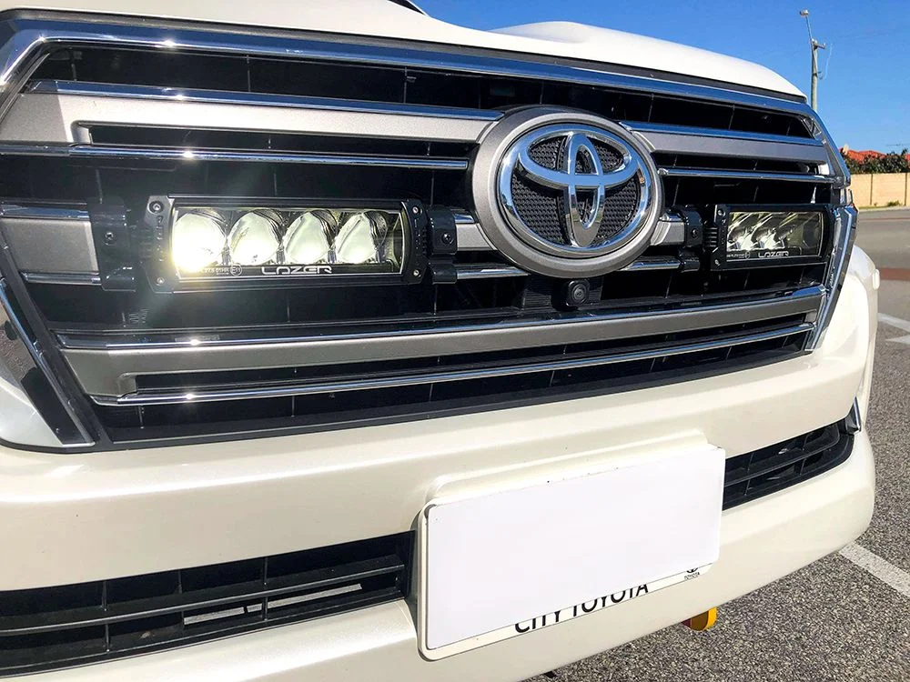

LazerLamps UK has produced a set of high quality driving lights which can be integrated into the J200 grill thus eliminating exposure to damage caused by accessory lights that extend beyond the body. The kit is not currently stocked in the USA because the distributor Triple R did not think there was a market for them. I spoke with Mac at Triple R and explained to him that J200 owners could really use a product like this and encouraged him to bring some over the pond. I'd encourage interested J200 ownvers to contact Mac.
The Kit will fit 2015-2021 J200 Toyota Land Cruisers and can be seen on LazerLamps website here: LazerLamp Toyota J200 Driving Light Kit

If I'm looking at those brackets correctly, you need to cut sections out of the stock grille to fit these?
Installation
Most definitely have to cut out some big sections of the grill. Then self tapping screws into the remaining slat to hold on the mount.
With that in mind...seems like you could mount just about any light in there if you are willing to cut out grill sections and then screw metal tabs to what's left, you just don't get the pretty brackets that match the curve of the grill slats and cover the cut ends.

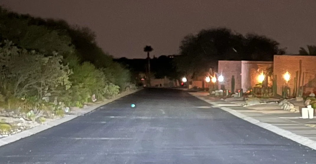

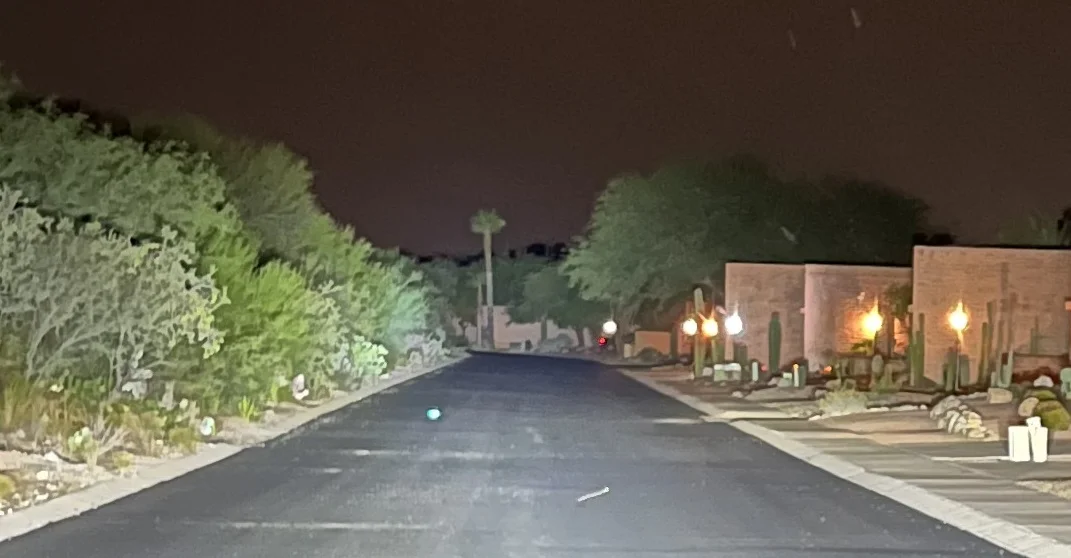

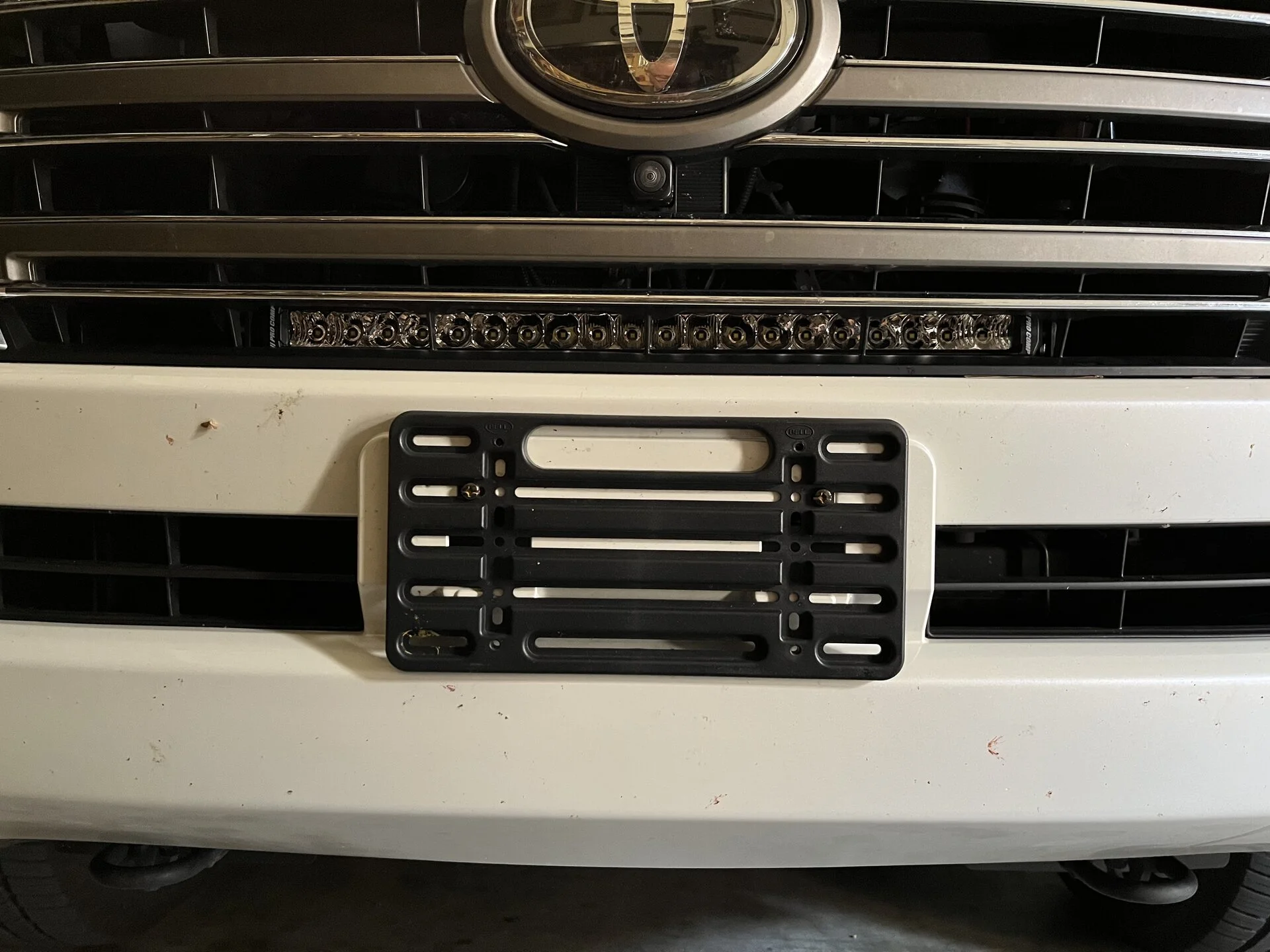

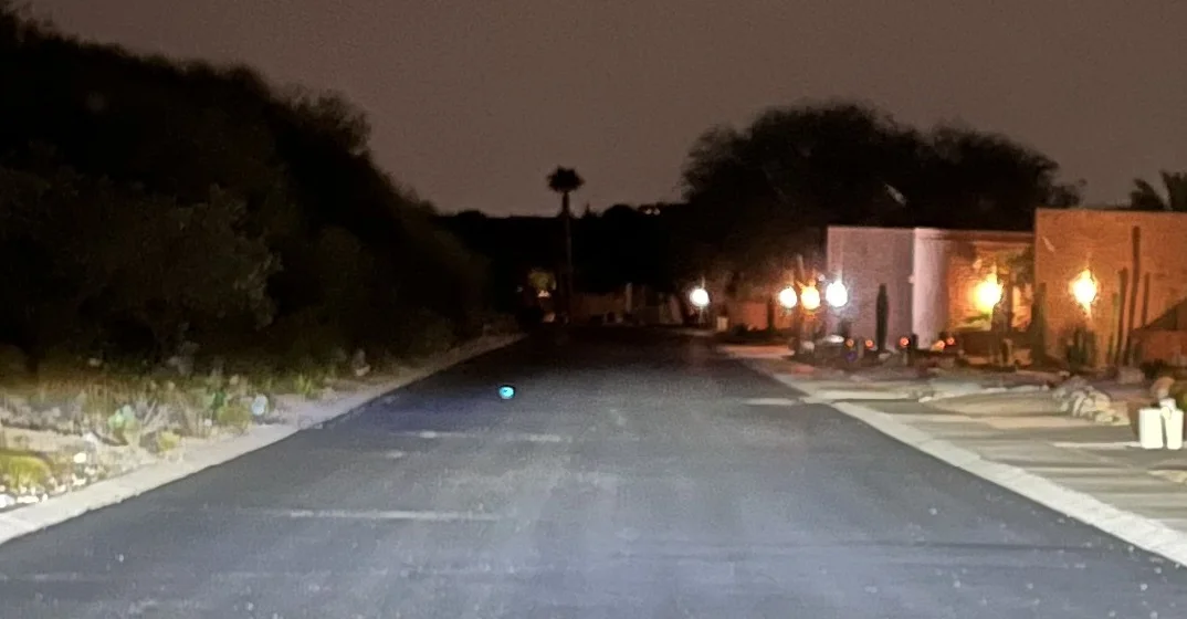

Perseverance has led to an alternate solution for the expensive grill altering LazerLamp option I described above. Here in the US an off road specialty chain called 4 Wheel Parts carries a light bar line called ProComp which has a limited lifetime warranty. Their 20" single row light bar uses Osram LEDs. It is a combination of flood, 4 on each end and 4 dead center which spread the light well, and spot, 4 on each side of the center floods that provide the distance. The lightbar is as perfect a fit as one could ask for in the LC. And at $119.95 very affordable. The only alteration necessary was to create a slot in the mounting bracket instead of the round hole which allows lightbar vertical adjustment so that maximal advantage can be taken of the 1 3/8 inch opening in the bottom of the grill. The results are a vast improvement in the poor high beams of the recent vintage LC sealed LED high beam headlights.
LOW BEAM HEADLIGHTS ALONE
HIGH BEAM HEADLIGHTS
HIGH BEAM HEADLIGHTS PLUS PROCOMP 20" LIGHTBAR
This may be a noobie question as I am no lighting expert, but is there any risk of melting the grill plastic with fitting lights that closely?
It’s a good question. Time will tell. I expect air moving past the grill and light bar will keep temperatures below the melting point. Currently with the truck parked and the light bar on the front of the light bar is cool enough to place fingers on without any significant heat detected. Most of the heat is generated at the base of the LEDs hence the reason for having heat dispersal fins on the rear of the housing.
And with an 8 amp draw one wouldn’t want to leave the lights on for too long without the engine running or battery drain will become an issue. With the engine running cool air will be drawn in over the light bar before hitting the radiator.
Were you able to install without removing the grille or did it all have to come off? Still pleased a few months later?
The only part necessary to remove is the radiator cover. There is plenty of room to install the light bar. And I’m very happy with the results using the ProComp brand lightbar with Osram LEDs.
