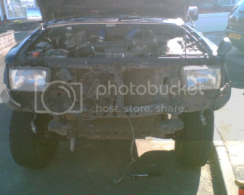

To fit tranny cooler
Remove front of truck

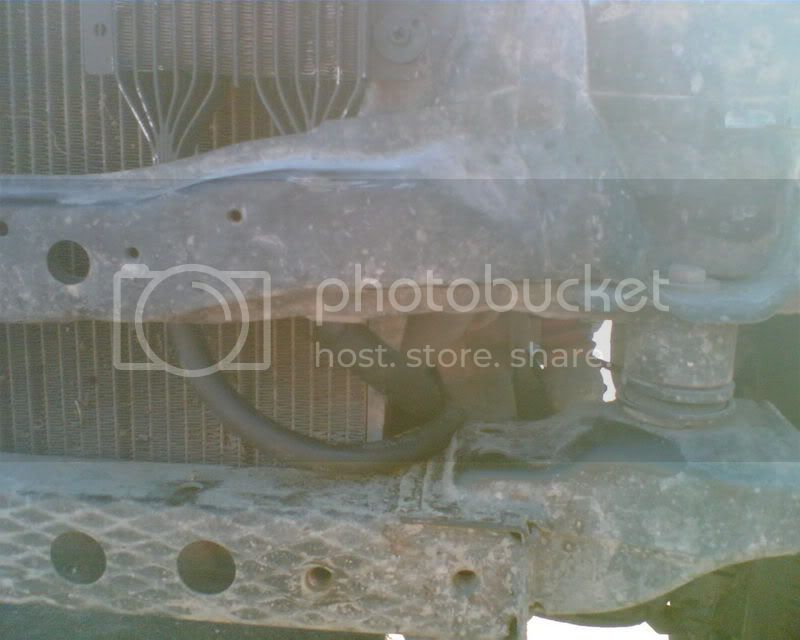

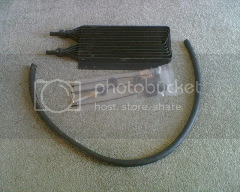

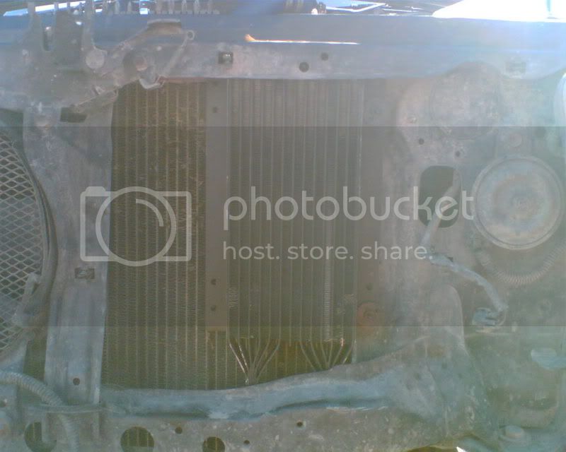

Fit into RHS (or anywhere coolish), and rig the ines so that the feed FROM the tranny goes through the cooler first.
Here's the pipes
Put truck back together and terrorise minis everywhere;)
