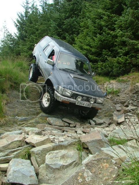

When I bought my JDM Surf 8 years ago - 2.4 LTE - it had a cracked head.
I replaced it with a 3L head and drove for the next 6 years and 200,000 kms and had no issues with it again.
Regular maintenance of course, but that truck used to get a hammering - lots of off roading and lots of towing a couple of ponies and daughters to many, many competitions (kids, eh?).
HOWEVER - I also .................
Fitted an intercooler (easy to do and cheap)
Blocked off the EGR (ditto)
Removed the engine bay skirts (ditto)
1.5'' body lift - massive improvement in air flow around the tranny
Auto tranny cooler - easily the best cooling mod you will ever fit (if you have an auto that is;))
And I used to run 33'' tyres most of the time too - it was my daily driver.
I agree that the 2LTE can be 'fragile', but after a while I stopped checking the water level, such was my confidence in the truck. I actually miss the old girl........nah, only joking lol
