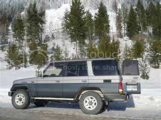

I'm really liking the image of having our Prado with a turbo'd 3B engine.
My truck only had 100k on it when we bought it and now its at 115k. Very little rust, all the electricals are in good condition. I think with a 3B turbo, it would be the ultimate because there may be a chance that the body would live as long as the engine for once (lol). Pics
