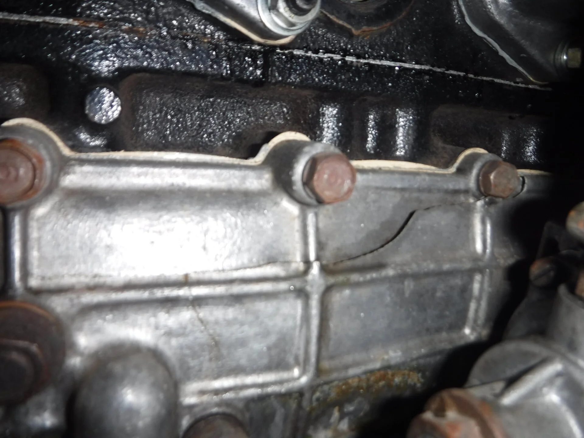

cracked oil cooler cover plate

yikes! that's a crack. Did it happen out of the blue? got really hot? Any lead up signs to the crack happening?

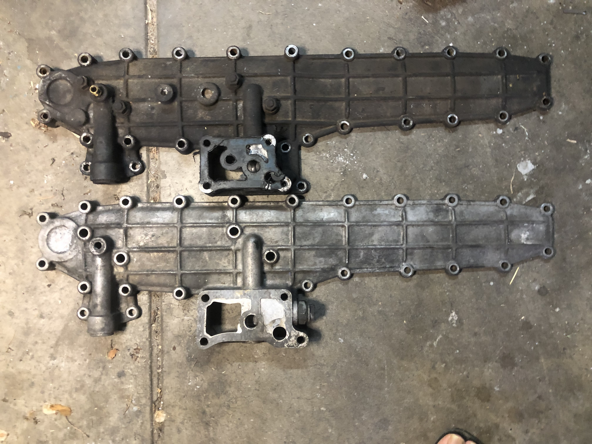

old and new cover..
Kilkenny make new aftermarket castings, not great reviews about them. I do know they make early and later oil cooler housings, not cheap at around $1000 aud for what it they are. Secondhand in good nic is a better bet.

No idea on how it cracked, I picked it up last week. It was gone thru 3-4 years ago. The guy I bought it from didn't put many KM's on it since he bought it after the refresh. Engine runs good, just puking antiboil right now with the crack. No leaks otherwise, but can't be certain until this is fixed to check for other issues.

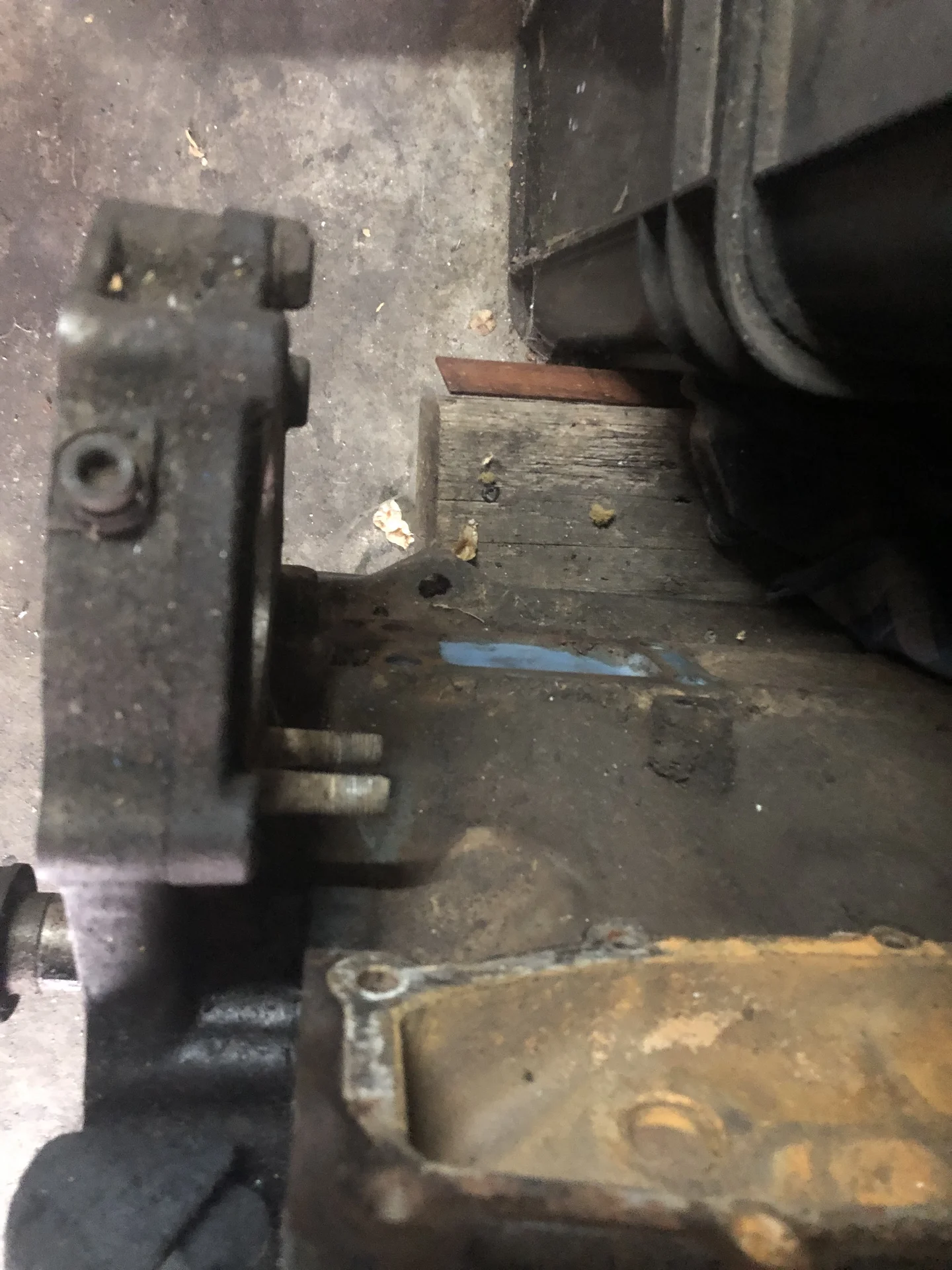

I guess so, the 4 nuts are for adjusting timing. Haven't done it that way myself but should be possible, very tight fit. There is a large o ring which goes in between there from memory which is worth replacing, I put a viton o ring for future veg oil. Here is a pic on the later 2h with the mount which holds the ip. Have to remove all fuel lines and brackets goes without saying.

I like the earlier 2h as it has a beefier oil cooling cover, also some had the centrifuge oil cleaner. I don't like your chances of tig welding the repair as once aluminium is dirty and already porous nature it does not repair well.

old and new cover..View attachment 3550452

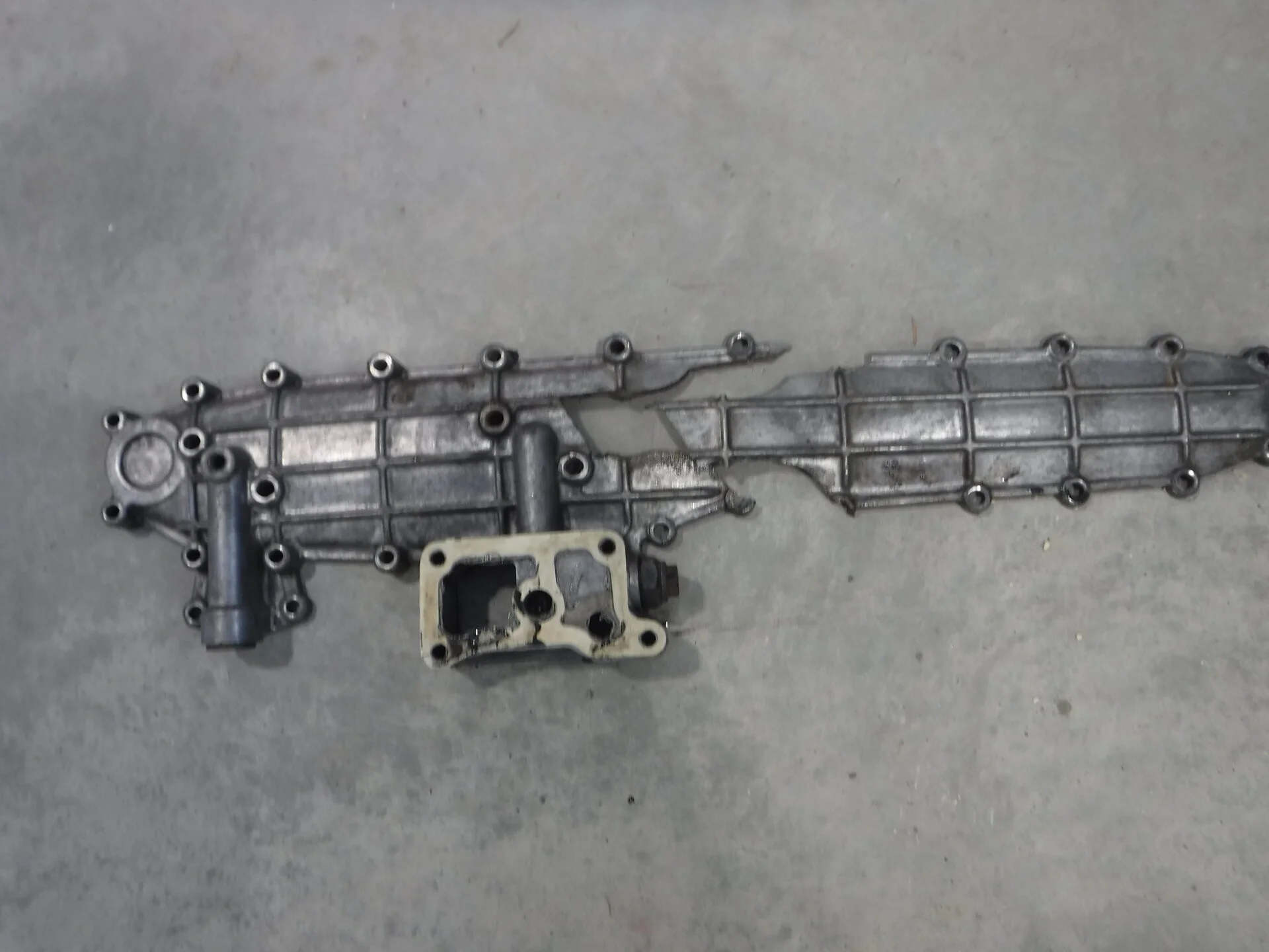

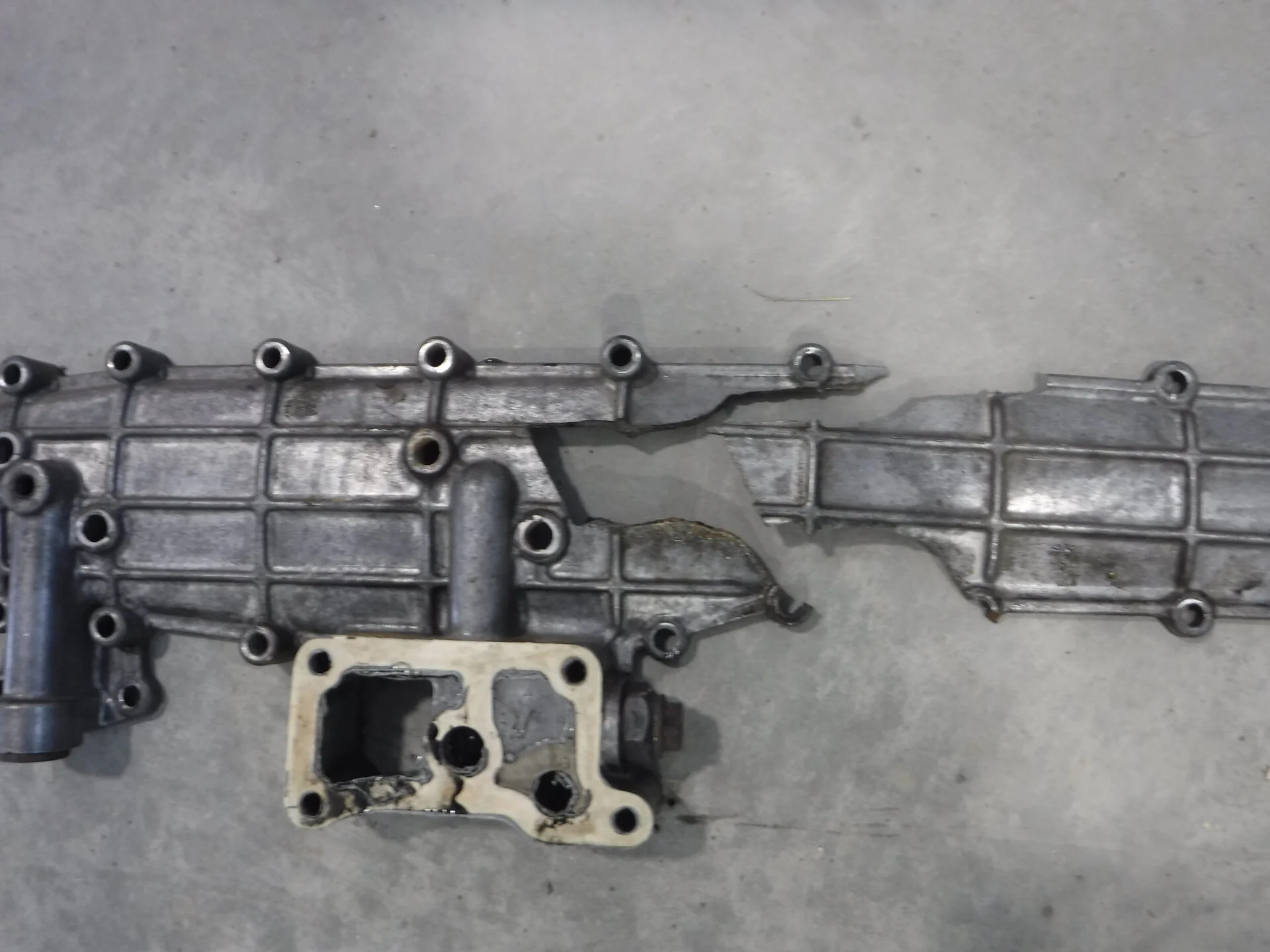

That cover is probably not repairable.
It would be fun to try.
update
I'm thinking you are correct, I finally got time to get it off today. It is a modular 2 piece design.

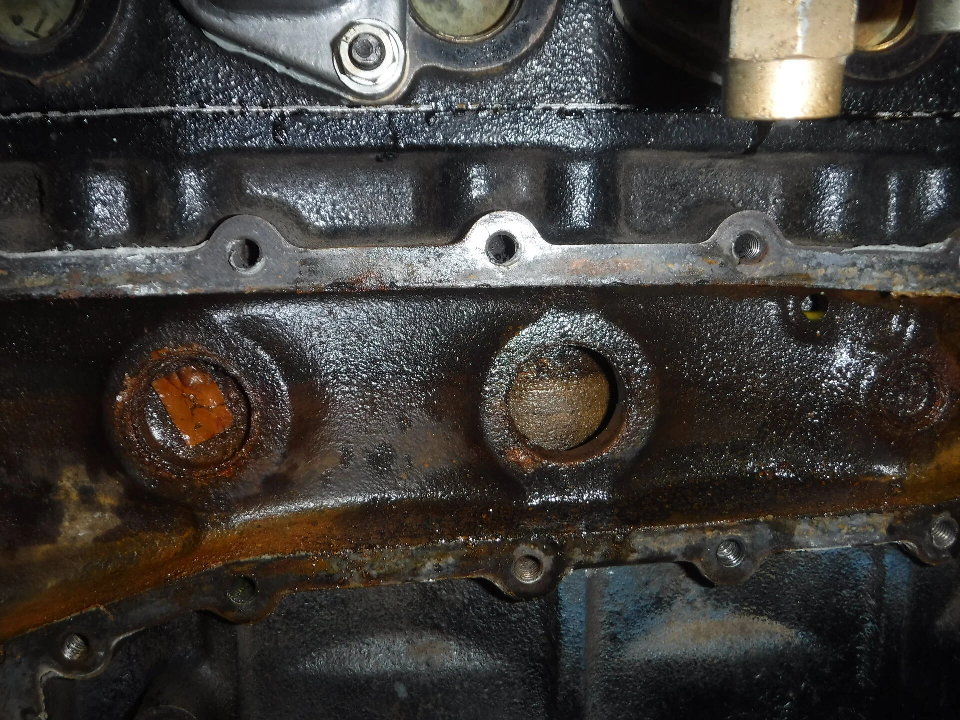

my guess as to what happened, is the coolant wasn't good for a cold climate and froze, found a freeze plug out behind the cover, and then broke the cover.
