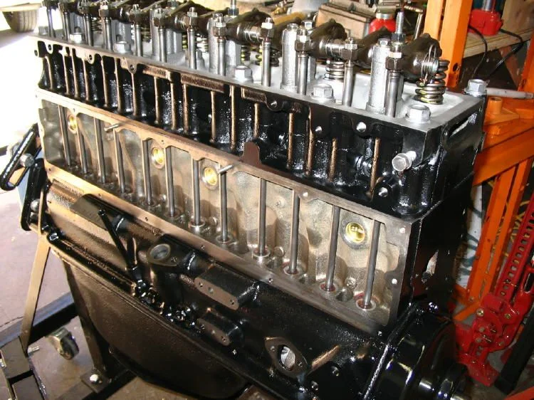

Well, finally got the motor back.. A little over $3K :ban: :doh:
Now to start assembling the rest of 'er.
.40 over Federal pistons (flat) with Deves Rings. Melling MC803 Cam w/ new Toyo lifters. Chevy valve springs and Mag-Bronze valve guides. Everything else new OEM and stock. Crank .10 under, I think ACL rod and main bearings.
'dat's all. I wanted a nice stout basically stock motor.
Also balanced all rotating parts + clutch.
Looks Great! Who did your rebuild?

Martin Davidson Automotive Machine
Reseda, CA 818-705-2441
Great Guy. Great shop. He'll do whatever level of rebuild you want: Short block. Long Block. Or just machining and Hot tank. Or just head rebuilt.
He does all the motors for MAF (Hi-Po and stock). He's very very patient, as are the two young guys working for him. And He knows these motors cold and has a stock room full of parts just for 2Fs and 3FEs... He doesn't like the F motors, but will work on 'em if asked nicely.
Martin really really pays attention to the details, that's why I let him do the assembly. He builds 'em like it was going into his own truck. Well worth the extra $400.
Tell him Alf sent you.

So $3,400 is what you get in the picture?
Dan, the actual bill from the machine shop was $2204.79, but I bought the Cam and lifters ($400) and the gasket set ($100) and the oil pump (160 $), and some other miscellaneous items which comes to just under $3k for what you see..

really nice. I paid about 2600 for all the parts, all OEM though, including a new clutch, oil pump, water pump, and all the hoses and belts. Still needed a new CCOT radiator, Downey cam and springs, and MAF headers. On top of that is machine shop work

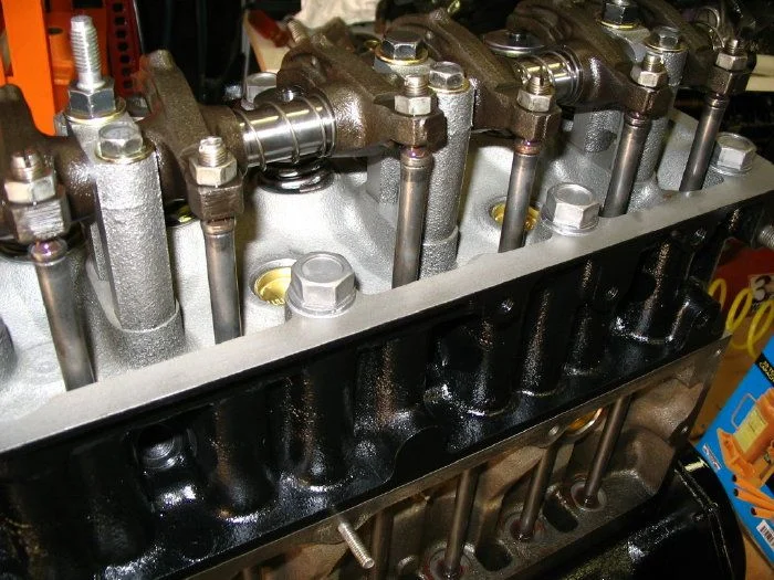

What type of valve stem seals are those??:confused: from here looks like those mickey mouse umbrella style :eek:
Whats the advantage of the chevy valve springs?:confused:
