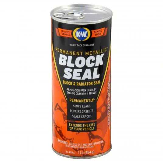

I hate the stuff as it can cause other issues, but I'd at least put a bottle of Bar's Leaks or equivalent Head Gasket sealer in before the trip, if your only option is to try and drive home. There are different ones, not sure what is the best as I only recommend in an emergency. I suppose this qualifies as one.
Go as slow as is safe. Keep an eye on the temp gauge. Bring as much extra coolant as you can carry. Stop and let the engine cool if it gets hot. Then replenish the coolant. ... This is going to be a long drive for you.
And check the oil before you go to make sure it's not a milky milkshake color. If it is, change it after you put in the Head Gasket sealer.

I do plan to add a head gasket sealer and will buy extra coolant. The engine does not seem to be consuming much coolant but I will be checking it often.

Skip headgasket sealer, you're adding junk to cooling chambers, you just spent a bunch on a rebuilt motor, don't throw crap into it.

Just know that head gasket in a can stuff is going to be running through your front and rear heater cores, as well as radiator. Will it clog them shut, probably not, but it’s likely going to reduce their efficiency. As said, a uhaul and trailer or dolly may be a lot cheaper option than all the other parts that could end up toasted by chancing driving it.
