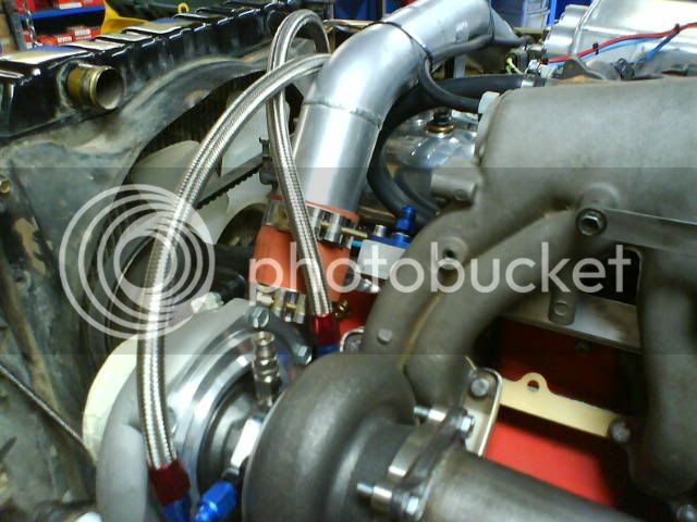

Ok water lines to the Turbo are in, this steel braided hose is a nightmare to get into the fittings if you don't cut absolutely clean :mad: Just the oil feed to do, that S/braided hose I had to order.
Matt's tip of the day clamp steel braided hose in a hose clamp and tighten over the point you wish to cut. Clamp the tightening screw in the vice on the hose clamp leaving the hose and clamp completely exposed and then with the angle grinder and a slitting disc cut through the hose clamp in the center and the steel braided hose all in one. Perfect cut oh yes you will need a hose clamp for each cut :hillbilly:

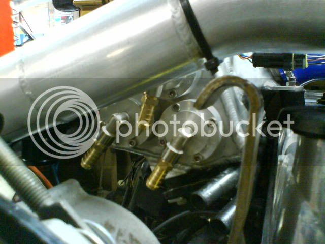

Well after a good study of the cooling system and where to return the turbo's water line too I elected to go to the top housing of the thermostat rather than attempt to T into one of the hoses.
So drilled and tapped and ready to be re fitted.
The thermostat is back on an connected to the turbo, the heater lines are all done including the oil cooler. All that's left now is the top and bottom radiator hoses and fast becoming the baine of my life the water pump by pass hose :mad: got a nice new one from Toyota and it did not fit due to using the 3FE thermostat bottom part of the housing by about 25mm/1".

Trying to picture this on my head but have you got both the water cooler lines for the turbo in the thermostat housing? One above the thermostat and one below it? Will that work as when the thermostat is open, wont both lines be getting simlar pressure from the water pump so might not circulate as little pressure difference? Cant you take it like the LPG conversion with in and out of the heater core for instance?

The turbo only needs water really to cool it when it's just been shut down and it's heat soak is at it greatest with no oil flowing. You can run these with out the water lines connected. Oil however is essential. It's not an ideal way of connecting it but the water in the lines act to dissipate the heat away from the turbo once shut down and the water pump is off then anyway. So really its hot water rises replaced by cooler water. Turbo timers allow the turbo to cool off before you shut the engine down but this is more to do with time than extra water flowing through it. Turbo timers are great as long as you are not upside down at comp, I have seen a couple of engines destroy themselves after the ignition has been turned off after a roll only for the turbo timer to keep it running, OOOOPPPPPS and most you can't override once the turbo timer has taken over.

You have the expertise around you, I'm sure for someone to build a loop of metal hard line. Off of that make one end to fit the thermostat and the other to fit the water pump. I think there would be room. Just come up off the waterpump fairly straight up, then make a loop up and around towards the alt. and then come back in level to the thermostat. Then you will have little chunks of hose connecting it.
Might be funky looking, but it would work, and would probably be easier than sourcing the molded hose.

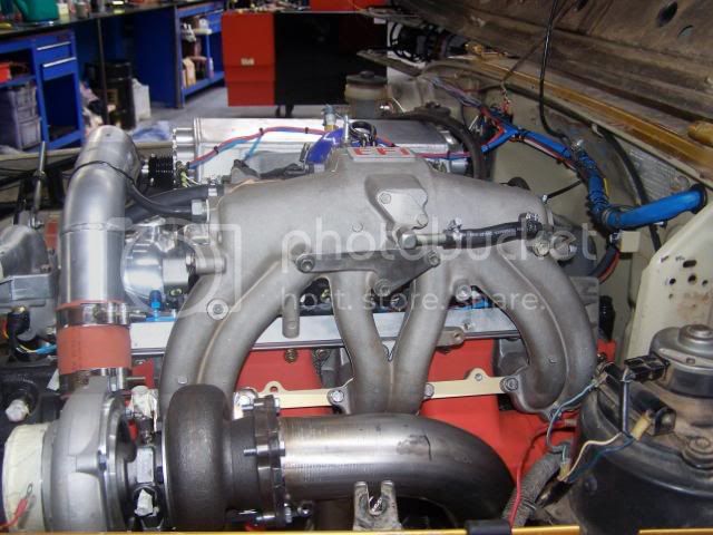

Looking good though, intercooler mount is pretty neat. You had mentioned earlier that the hood may have to be modified, but it looks like you got everything tucked in very nicely.

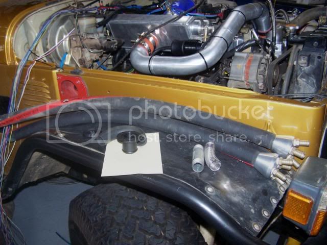

I'm starting to hate plumbing :mad:
The Mazda 121 radiator and thermo fan have an inlet and out let of odd sizes but that was ok we machined the intercooler splitters to suit. The Craig David water pump had an assortment of couplings and sizes, not one matches the radiator or the inter cooler pipe:mad:
So I will machine a few couplings to suit changing from one hose size to another and a custom coupling for the pump :mad:

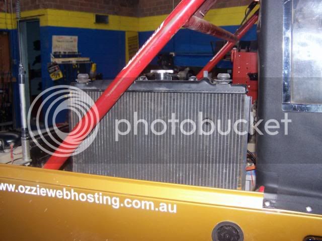

Radiator in just the top mounts to make to secure it.
Will re route one of the lines to the oil cooler outlet this should suit better.

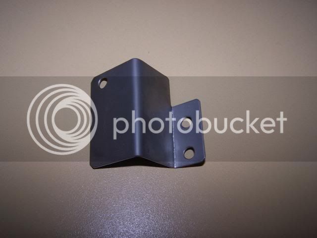

Also made up the new bracket for holding the throttle cable. Stainless :D

What a busy day a Troopy and a 45 are USA bound along with a 45 cab or at least the bottom half. With that out of the way and my 2 day course over it's back into mine, fitted the new bracket to hold the throttle cable before piping up all the in's and out's of the intercooler to the 4 way splitters, just got to finish the main pipes of to the Craig David pump and rear radiator. Hopefully tomorrow.
