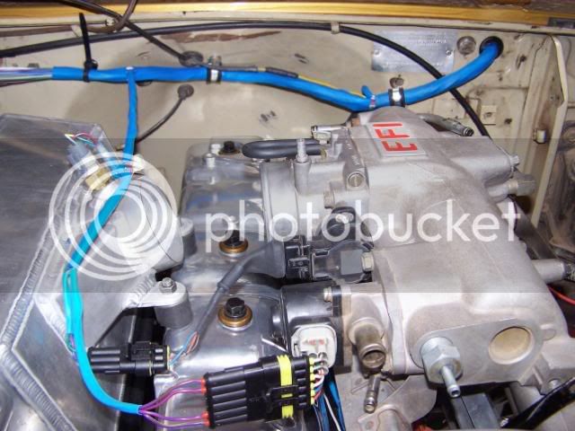

Well I started the wiring all good so far, having more of a problem with the water proof connectors and how they assemble :confused: But that's sorted and were on a roll.
Bought a heat gun and a good pair of snips. The rest is from my mech's Worth collection
TPS connected
Air temp sensor connected
Idle speed control connected just awaiting 12V
Injectors wires run awaiting connectors and 12V
Water temp sensor wires run ready to connect.
All good so far Tomorrow we will start on the ignition and coil pack.
Fuel pump relay and a few other bits.
