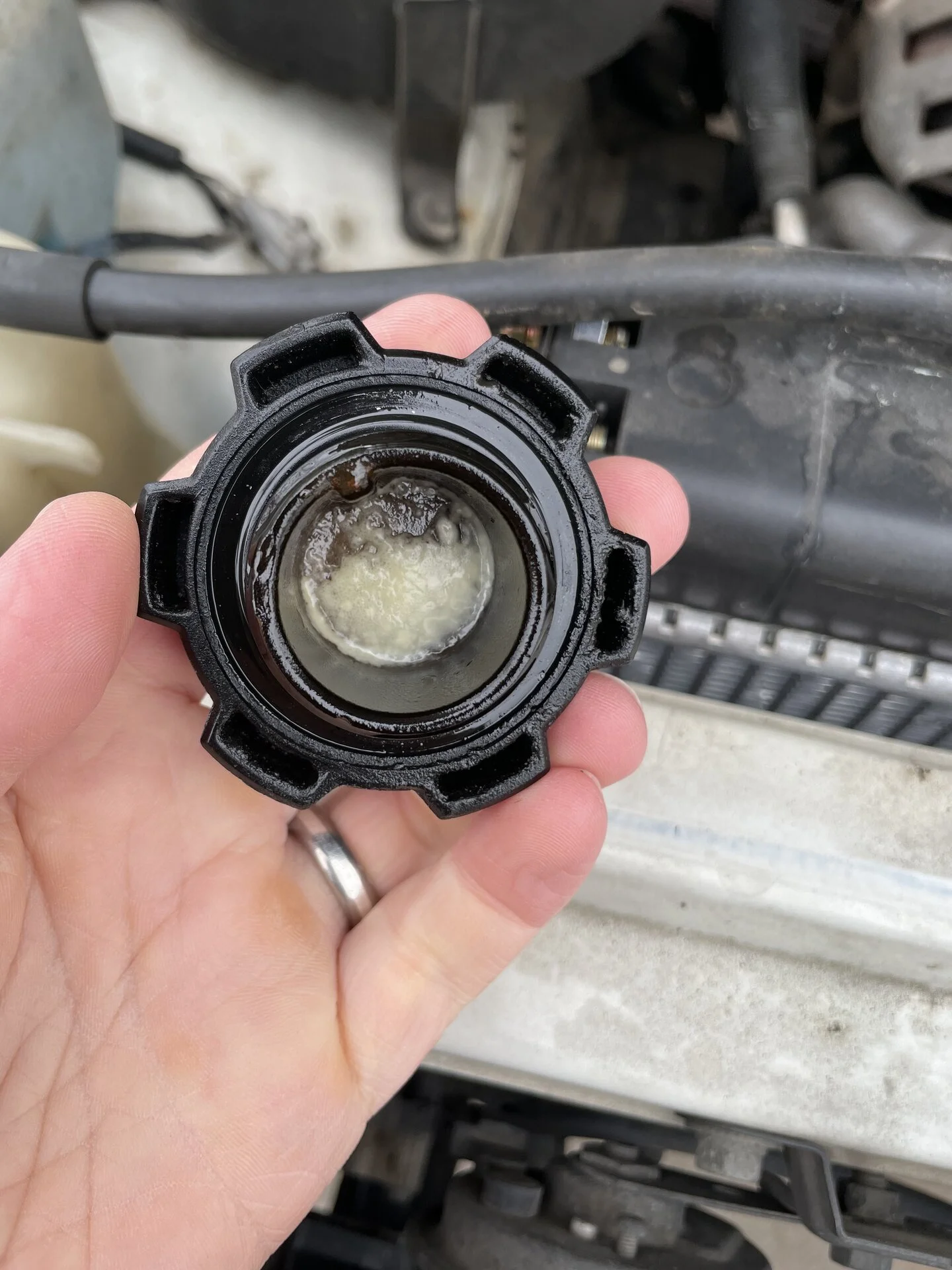

Well it finally happened - Stopped for gas, checked the oil (like I do every fill up) and there's a little foam on the dipstick, foam on the oil cap, and a little wisp of steam escaping the oil fill hole. I think 282K is a pretty good run but its not done and I'm going to fix it and get it back on the road. 4,000 miles ago I did a complete oil seal job and tune up and it wasn't leaking a drop. I ran a scope down the cylinders when I did spark plugs and the pictures are a bit fuzzy, but the cylinders look pretty good. It never overheated.

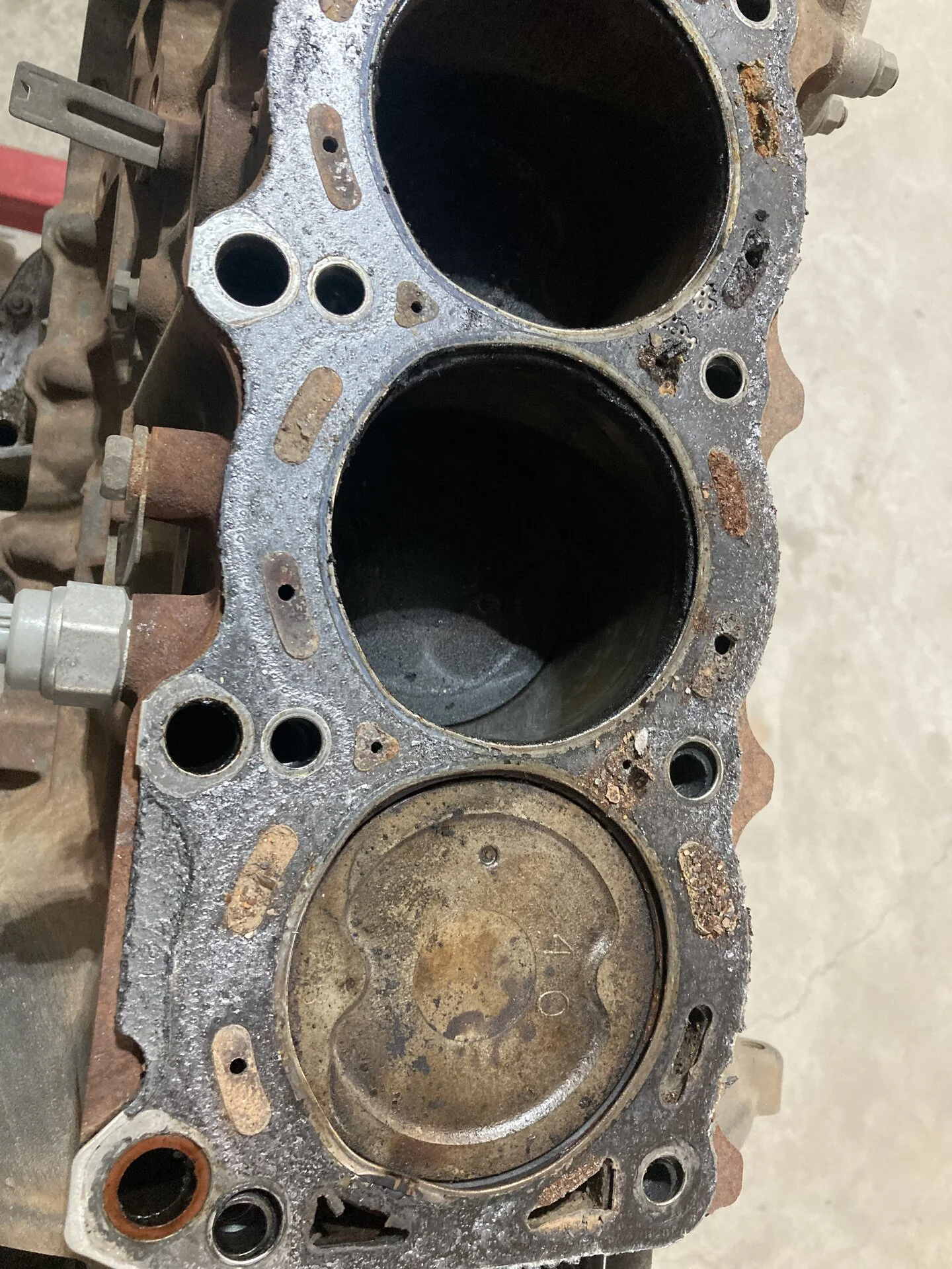

This is what the inside of the cylinder looked like 4,000 miles ago. This cylinder had the brown hue. The rest were silver with similar cross hatching. I don't know if the brown was from the camera or actually reflected the condition in there. I guess we'll see!

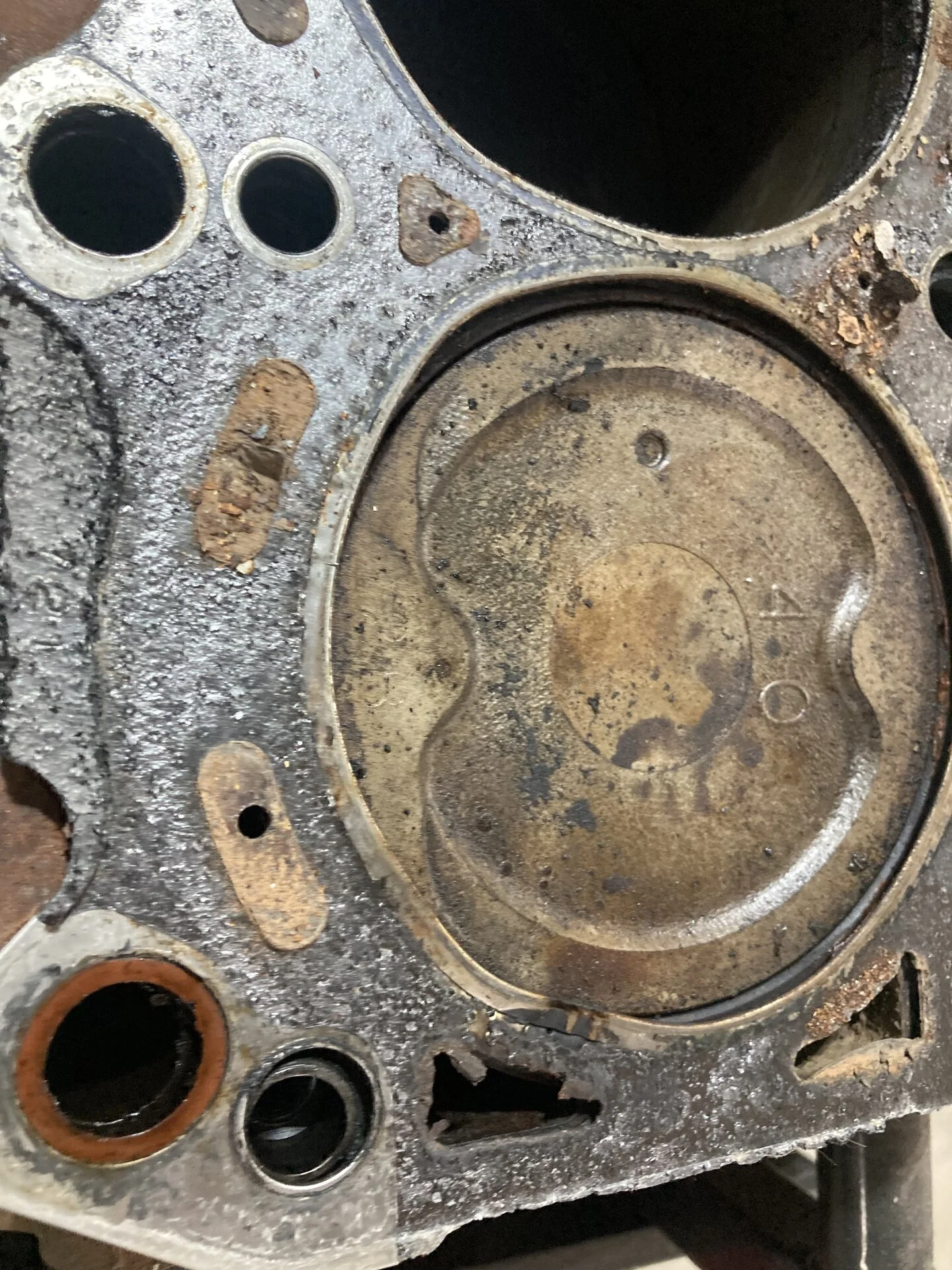

Top of the piston. Not bad. I suspected some hot spots for poor burn. It needed new spark plugs when I took this picture. I think this was the #6 cylinder.
Edit: This picture is from 6 months ago.
Any chance you are just seeing condensation and it isn't a head gasket? Might be worth a couple more diagnostics before pulling it apart in 0 degree weather?
Might get away with just a head gasket and valve seals (and a few other things like throttle body, plenum, valve cover and manifold gaskets) and fluids? Should be possible to do it economically as long as the head and block don't need machine work. We did my son's disco v8 head gaskets recently for well under $1k.

Oil cap can get milky from condensation when driving a lot of short distances (engine not getting up to temp). What you're saying doesn't really scream blown HG. Losing any coolant? Easiest is to just change the oil and check that for now.

Yeah, you might be fine. It's easy to get the "head gasket fear" around here. Mine has some fairly incomplete records, so for all I know it's been done, but I'm right in the same ballpark for mileage. If I were you, I'd definitely want to confirm suspicions before I tore into it.
I keep a close eye on the oil and its pretty fresh, however, I've never seen foam on the dip stick or cap. I think I filled up this tank of gas over the Thanksgiving weekend and trips have been of varying length, from 10 to 30 minutes and all in the cold. I'd think that a 30 minute drive would cook all the water out of the oil.
Yeah those short trips will definitely cause condensation in the engine. Can't speak for 80s but on my GSF (with an oil temp gauge) the last time I drove it in the cold (mid 40s) it didn't fully get up to temp on a 20 min drive. South Texas so no idea how colder places are with short stuff. Also depends if you're solely doing short trips around town or take it on longer stuff in-between.
