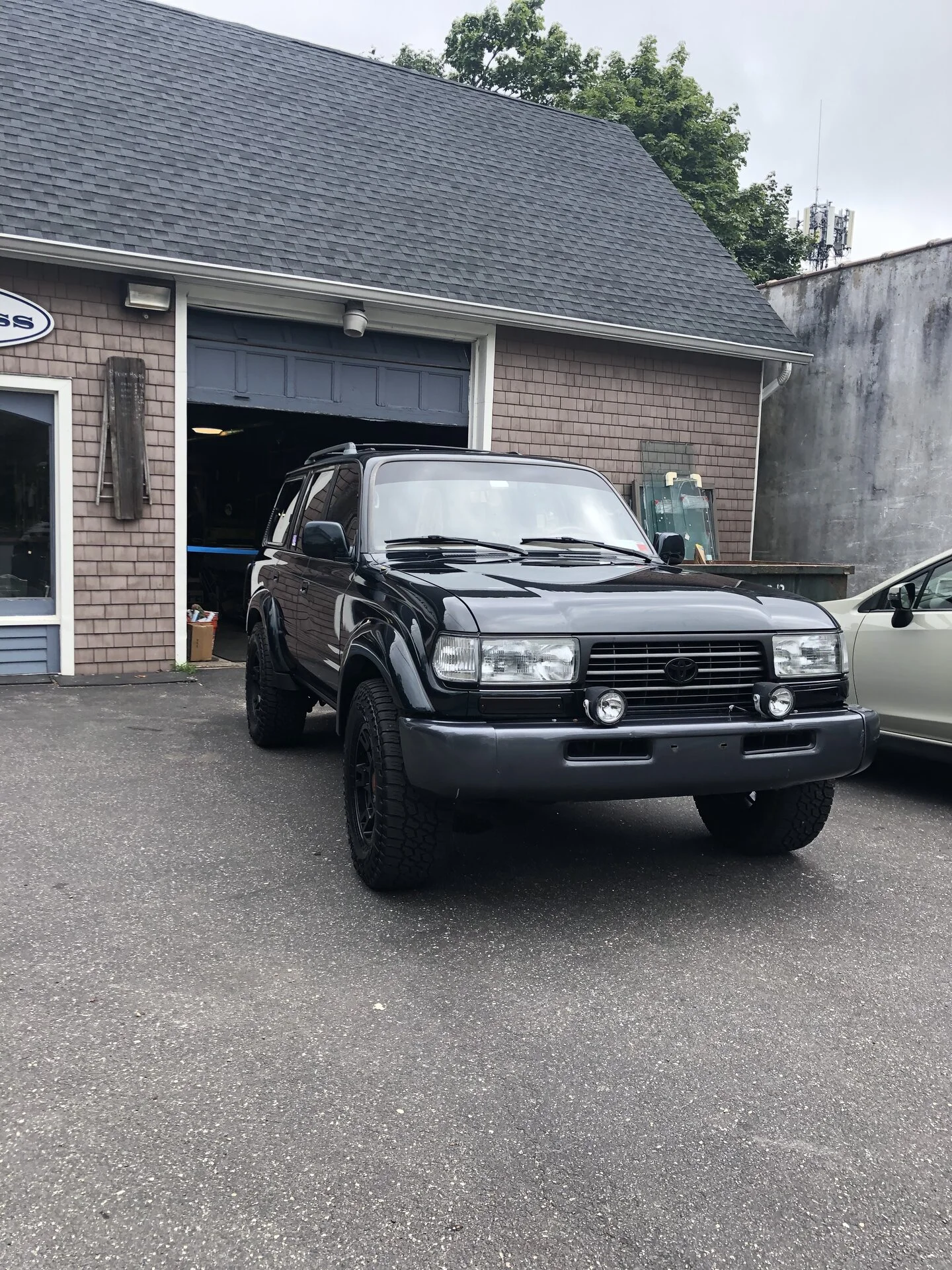

hey guys i’m 24 years old got this baby when I was 16 and had 30k miles on it. 1996 dark green fj80 that was immaculate. it’s been my everything for years and i’ve always taken care of it finally got an entire new exhaust have never had any major problems. kept flushing the ac system to get the best to work and never replaced heater core. minor is about 3 years ago driving on the beach my radiator blew up, got it towed home and luckily didn’t blow a gasket or anything. fast forward and I get a Camshaft position sensor error code, was planning to fix within a week and took a 3 hour trip to boston that weekend, checked oil before and was all good. almost in boston engines shaking at low rpm almost at a stop but temp didn’t shoot up. kept going as I was 20 min away and get the dreaded white smoke immediately pull over turn car off open hood see exploded radiator again. i’ve always gotten only toyota parts but get it towed and end up towing it home to my mechanic saying they took it off the truck and boom felt something engine shot not just the gaskets full rod or something not even sure if there’s a hole in the side of the block or what. wondering if that could be because I never fixed heater core? or some negligence on my end because this car doesn’t get driven too hard and it’s at 108k miles, i’m freaking out as I wanted to get a new daily and keep this forever but now dont know where to look as this may be a 10k problem and I dont know anyone local to trust with an engine rebuild if this one’s salvageable or where to find the best donor. i’m sure there’s so many forums i’m new to this site but to see an engine blow at 108k miles is scary as hell and i’m destroyed

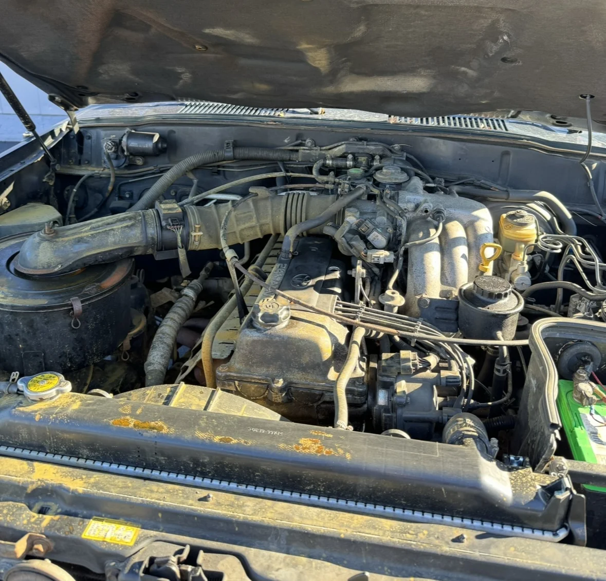

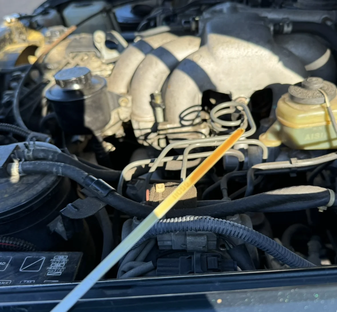

follow up with mechanic, will attach pic and video of trying to turn over. milky dip stick hundred percent coolant in engine in screwed, at least a thrown rod not sure if worth taking engine appart and seeing if the block is cracked or not
Take a breath, get it back to your house and start looking into what your options are.
The cruiser looks super clean and is definitely worth fixing, it just might take some time and money to get it done correctly.

Sounds like the HG blew and pressurized the coolant system. Sorry to hear that's a nice one. I'd check around for a new OEM short block and someone to handle the rebuild and getting your cylinder head decked and rebuilt. It's not worth attempting a rebuild of your current bottom end unless you can DIY.

It could also be hydro locked. Easily checked by pulling the plugs. Sounds like you need to find other help.
