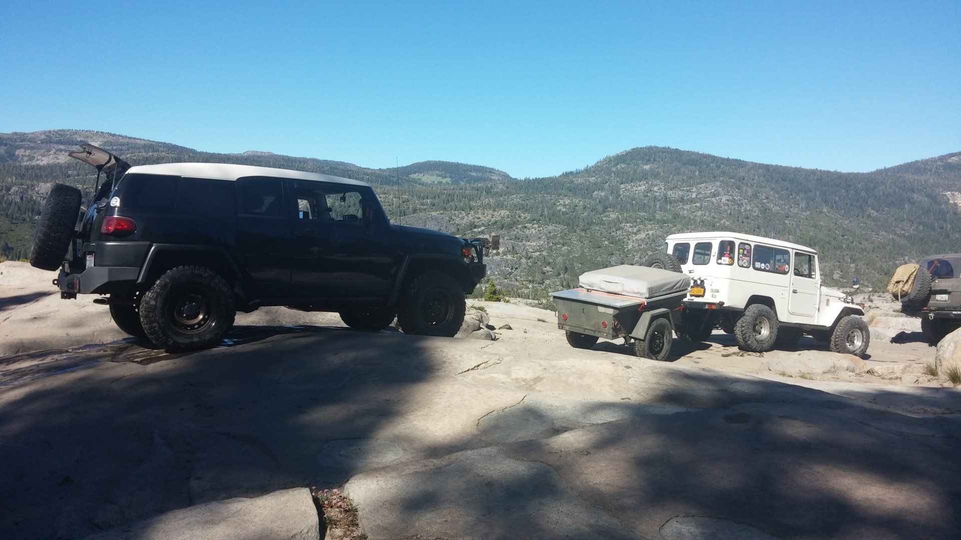

That was Brian who received the "Iron Butt Award". He drove his BJ46 and trailer from NY.
