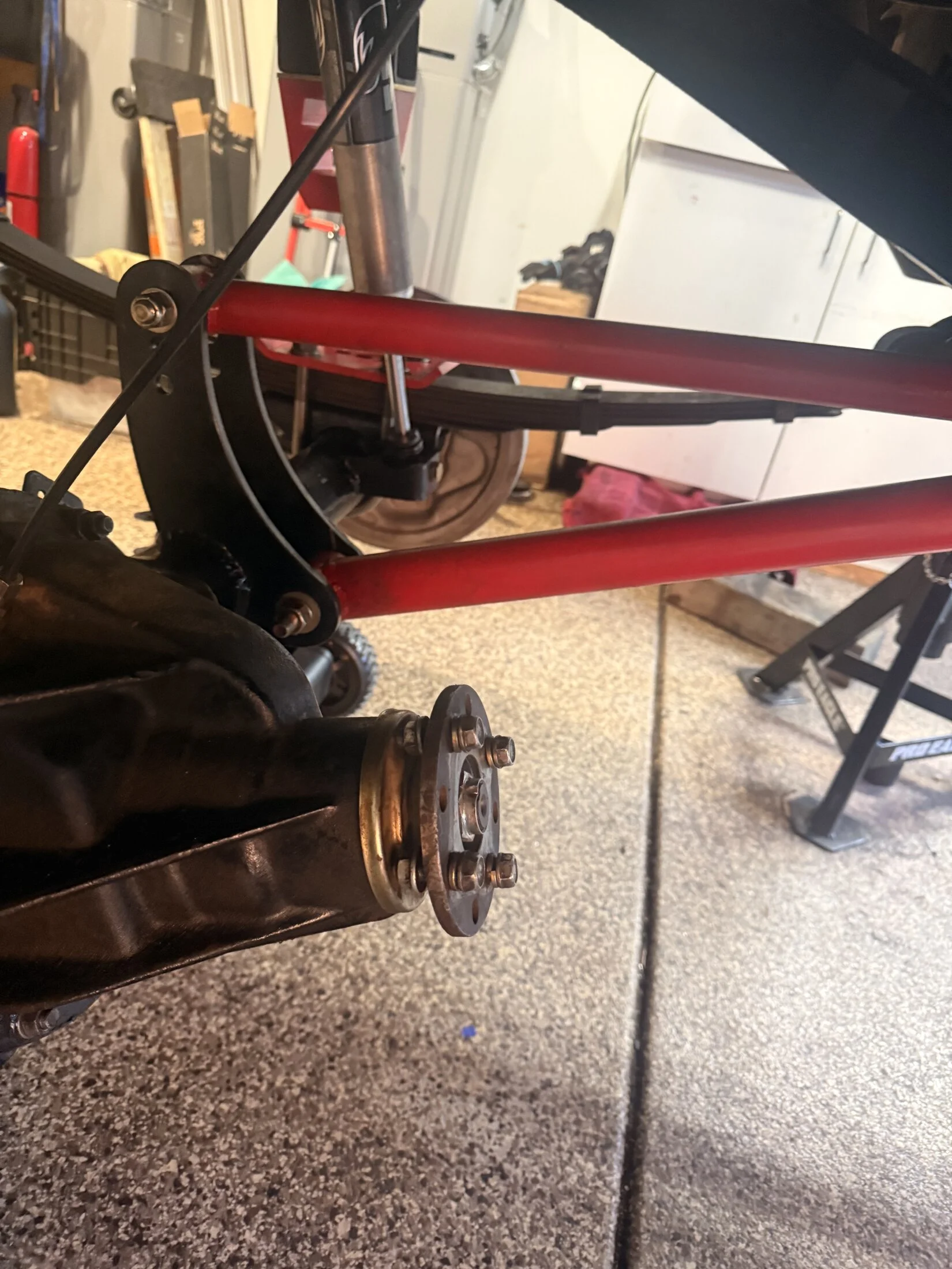

I cant tell but i highly suggest a rear antiwrap bar . Ruffstuff has a good one .

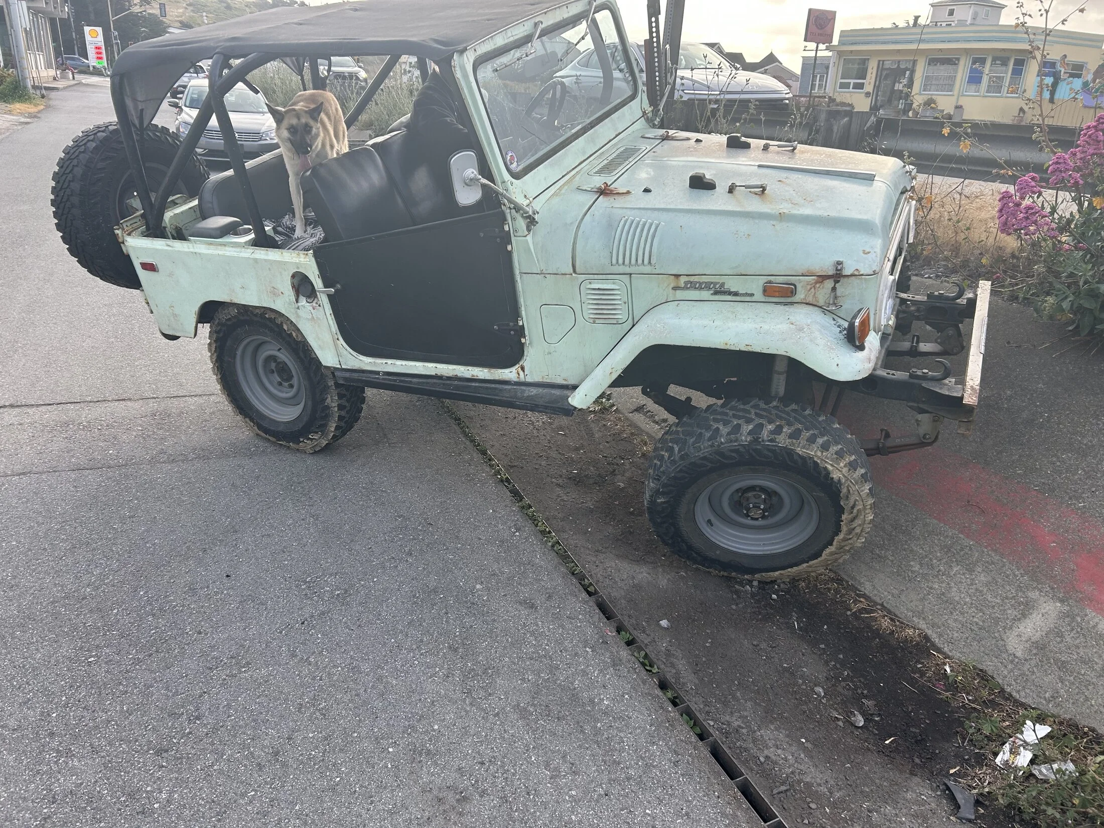

Ok quick intro since I’m 99% sure I’ll be there.
I’m Michael. I live in Tahoe not too far from the exit of the trail. This will be my 5th run on the Rubicon. 3rd time with Doug. Normally I go with my younger son but after months of working on the truck with me, he got an opportunity to go to a week long camp he can’t pass up so I’ll be with my older, less truck enthusiastic, son Logan. It will be his 2nd run.
Over the last 6 months I’ve take a fairly stock FJ and turned it into a monster I’m not sure behaves properly yet. It got a SOA on 60 springs and axles. It’s on 38s. Powered by LS 5.3 with an NV4500 and 4:1 Orion Tcase with 4.10 diffs and ARB lockers. This was all done by my son and I with very little experience. Lost of advice from Valley Hybrids. I hope it holds up!
Today it ran for the first time! We pulled it out and around the block. Once we figured out that it works we put the cage back on and took it for a little spin on a local trail and promptly overheated. After my wife rescued us I figured out that I had the fan on blow and not suck. Quick wire swap. Now that it sucks it’s running cooler. I already found a fuel leak, lost a bead lock bolt and found a loose shackle.
Many more test drives required!
Wow! That thing is sweet! Hope you get the bugs worked out and we get to see it in person.
You'll be fine. Alot of those shake down, double checks is a great idea, run down to south lake, when you get to the hair pin at end of ridge out of emerald bay come at it a little fast in 3rd and let off, if that orion is gonna pop, thats one spot where they like to do it. check steering arms, and dline bolts, if its a first run it wouldnt hurt to put some run around time and before trip, drain tcase fluid, 2 reasons, the orion on break in will have some silver dust which is good to get out and I like to check the interior case bolts. You are gonna love the 5.3, 4500, 4:1, 4.10 combo IMO.

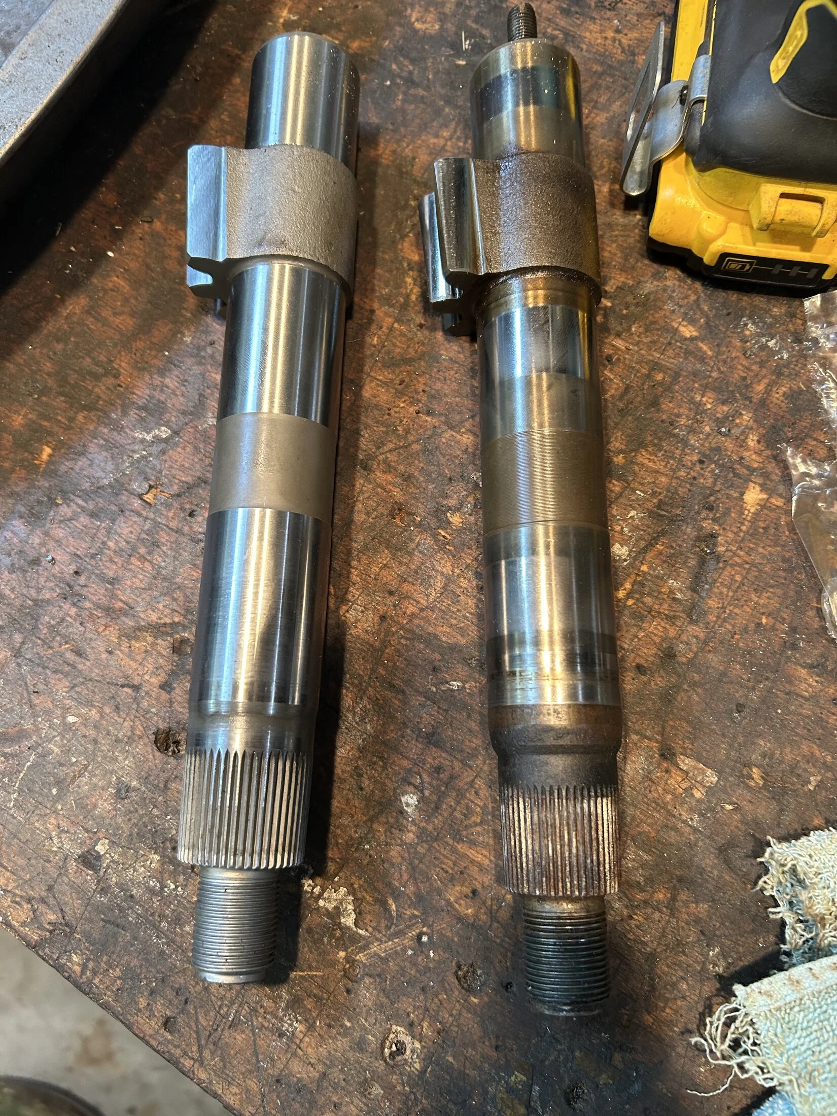

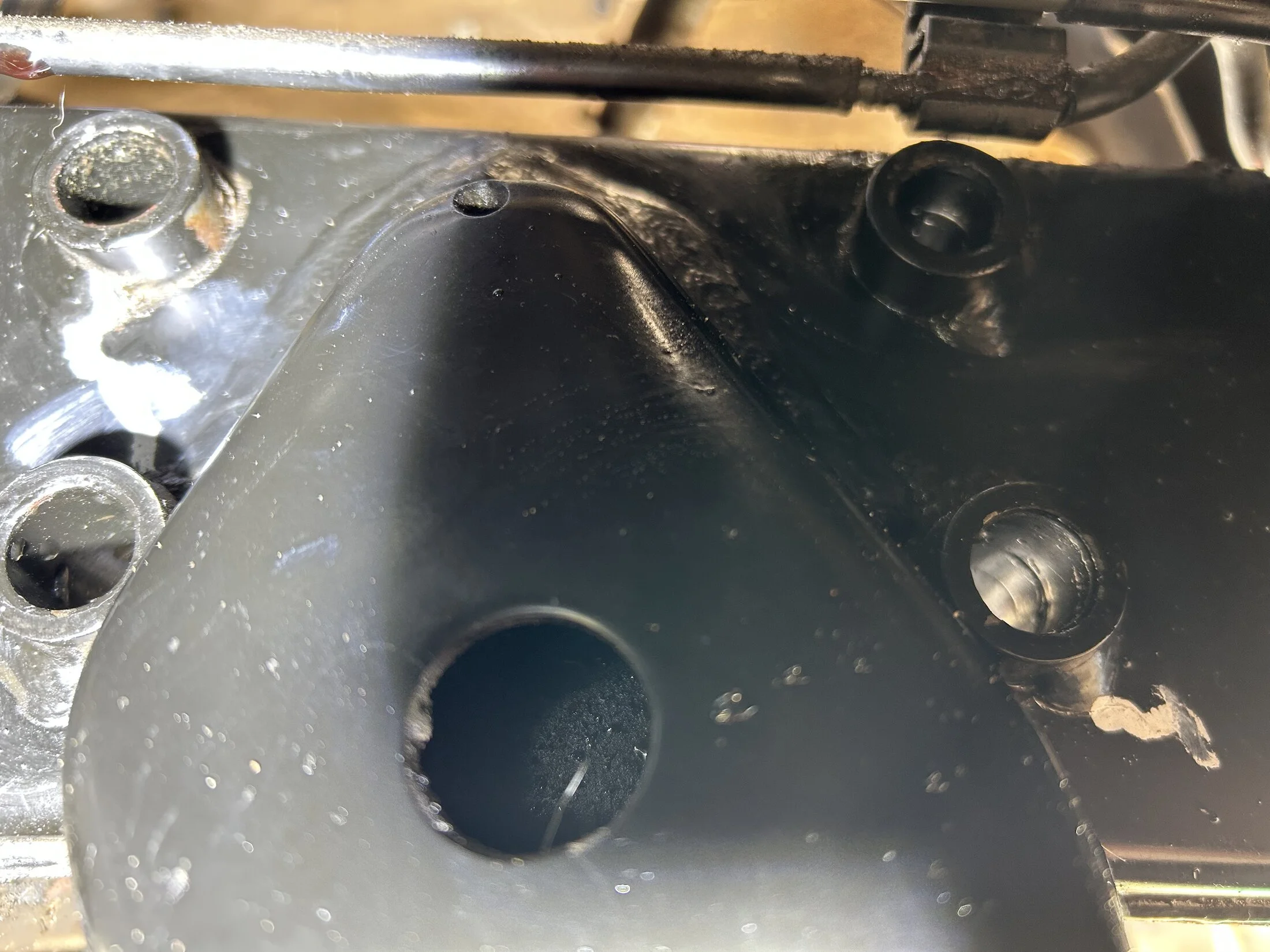

Getting Down to the wire with the 80! Finally looked hard enough to find the source of the creaking/ticking when turning hard. Drilling and welding and plating the frame cracks on the back side of the steering box. Installing a 105 shaft while it’s all apart.

I just did that before Cruise Moab as a preventative upgrade. I picked up a spare box, rebuilt it with a 105 shaft, and drilled/tapped for future hydro assist. Then I welded on the frame supports (kit from Rampt Customs) and installed box with new pump, hp and lp hoses, added an inline cooler and magnetic filter, and added a larger reservoir. :cool: :steer: Welding the plate on the backside of frame was tough to reach. I didn't get as many welds as I wanted around the crush tubes, but should be fine.

Delta kit, not looking forward to burning in that back plate.
