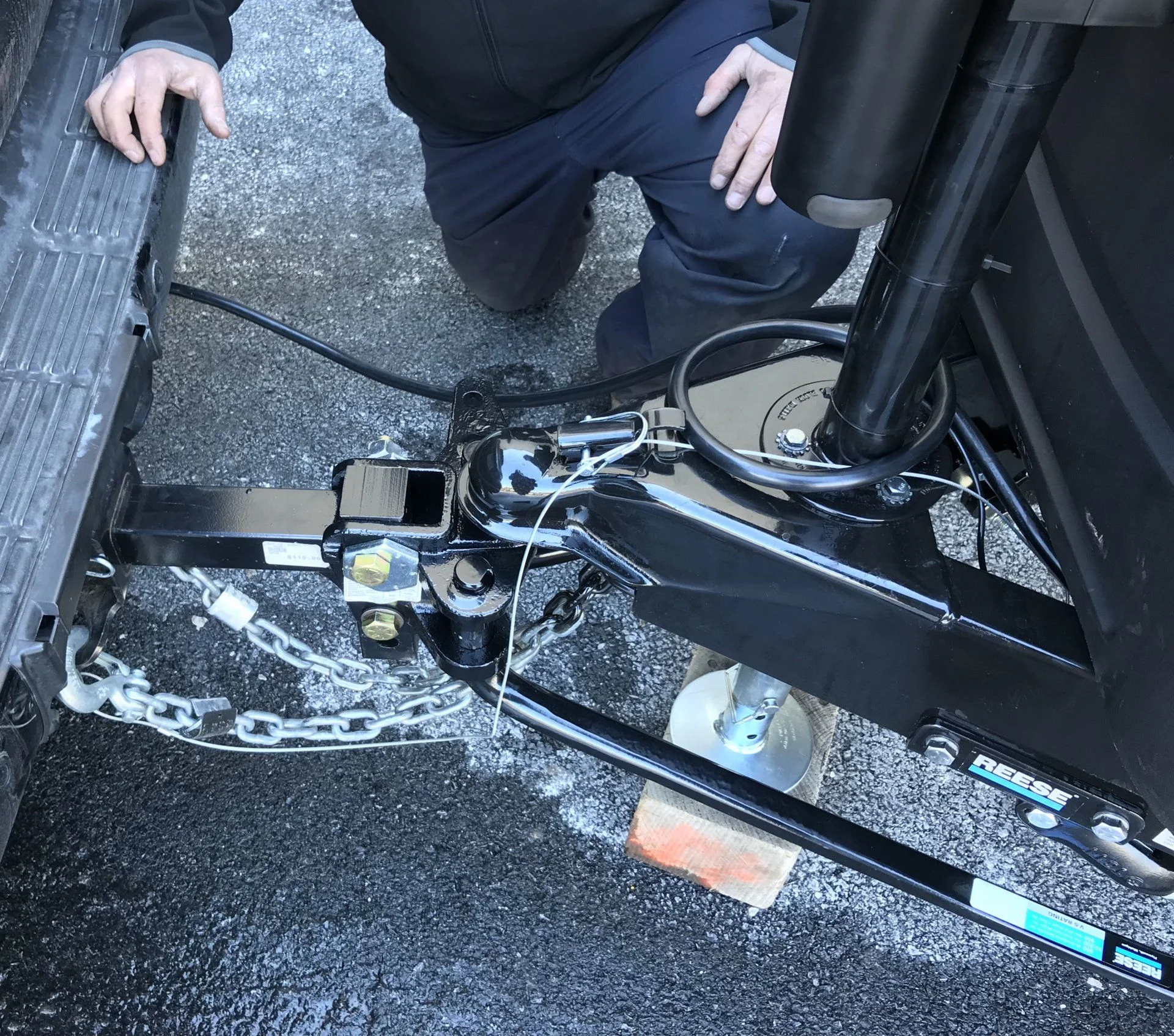

The tongue on mine is 690. I negotiated the best hitch / swaybar / distribution mount with the dealer. It’s a Reese V-5 rating from Michigan. While I never towed this without this hitch, the sway bars feel like it keeps the trailer in place, but I still noticed some sway as it was windy with a travel trailer. The weight distribution arms do seem to put some more weight on the front tires as it has a J shape when you install them.
@basis, if I may...
One thing that can help dramatically is to keep the hitch ball as close to the rear bumper as possible. In the pic, the stinger seems to put the hitch ball at least 5" farther out than it needs to be. Every inch gives the trailer more leverage to induce sway.
It actually comes back to wheelbase. The critical dimension is actually the ratio between wheelbase vs rear overhang (rear axle to ball). With our relatively shorter wheelbase (112.2"), it's important to keep rear overhang as short as possible. Every inch shortened is about equivalent to increasing the wheelbase 2" (as our wheelbase is about 2x the rear overhang length). So shortening the stinger 5" would be like riding on a wheelbase that is 10" longer!
The principle of the pivot point projecting hitches is to virtually reduce the rear overhang length. So it's a good thing to optimize if you're looking for better towing performance.

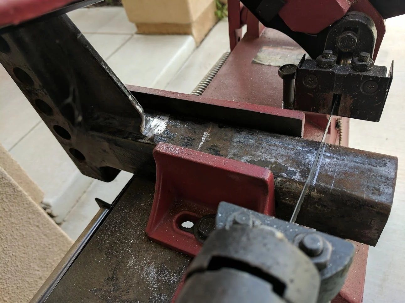

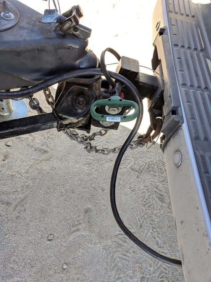

I have the standard stinger that came with my Equilizer hitch. I lifted my trailer rather than opt for a stinger with more drop. Stingers are all typically longer than necessary for hitch compatibility. So generally requires aftermarket modification to optimize. Most any machine shop should be able to handle this. I fortunately have some tools, but my band saw took ~1hr with a worn blade to do the deed. A chop saw or angle grinder and some time could probably do it too. A fresh 5/8" titanium bit and drill press makes quick work of the hole. Just absolutely need to make sure the hole is straight and square.
