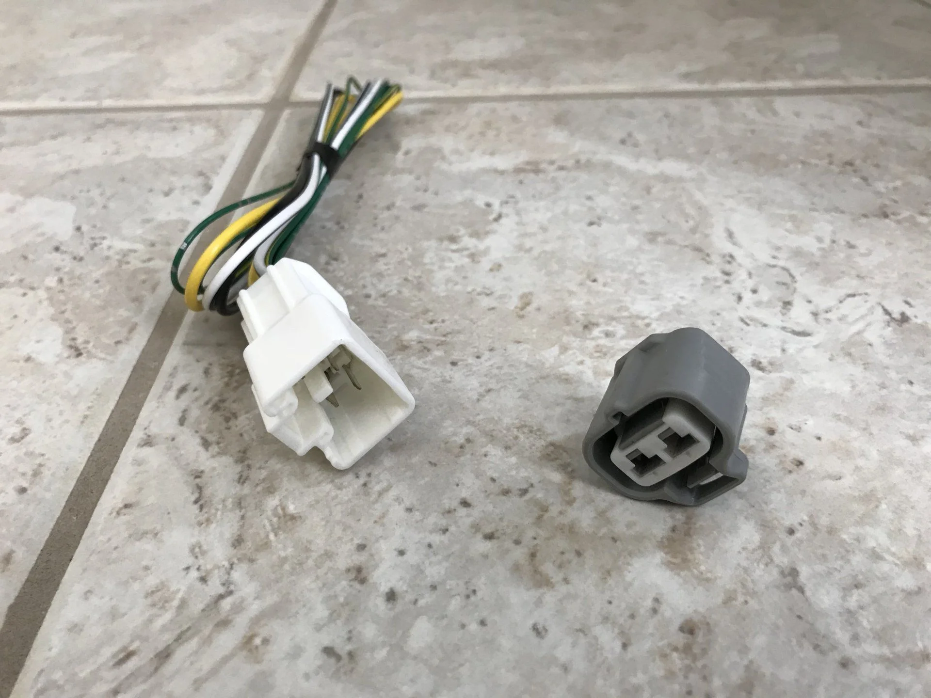

I have the trailer brake jumper harness that came with the vehicle (white with 5 prongs - pic attached).
Anything I should alert them to / pictures? The trailer dealer says they sell 150 a month and has been around for 40 years. I did speak to the guy who puts in the brake controllers and he hadn’t put in one of these in the past. The alternative is I could take it to a local stereo shop I’ve used in the past who I know does good work.

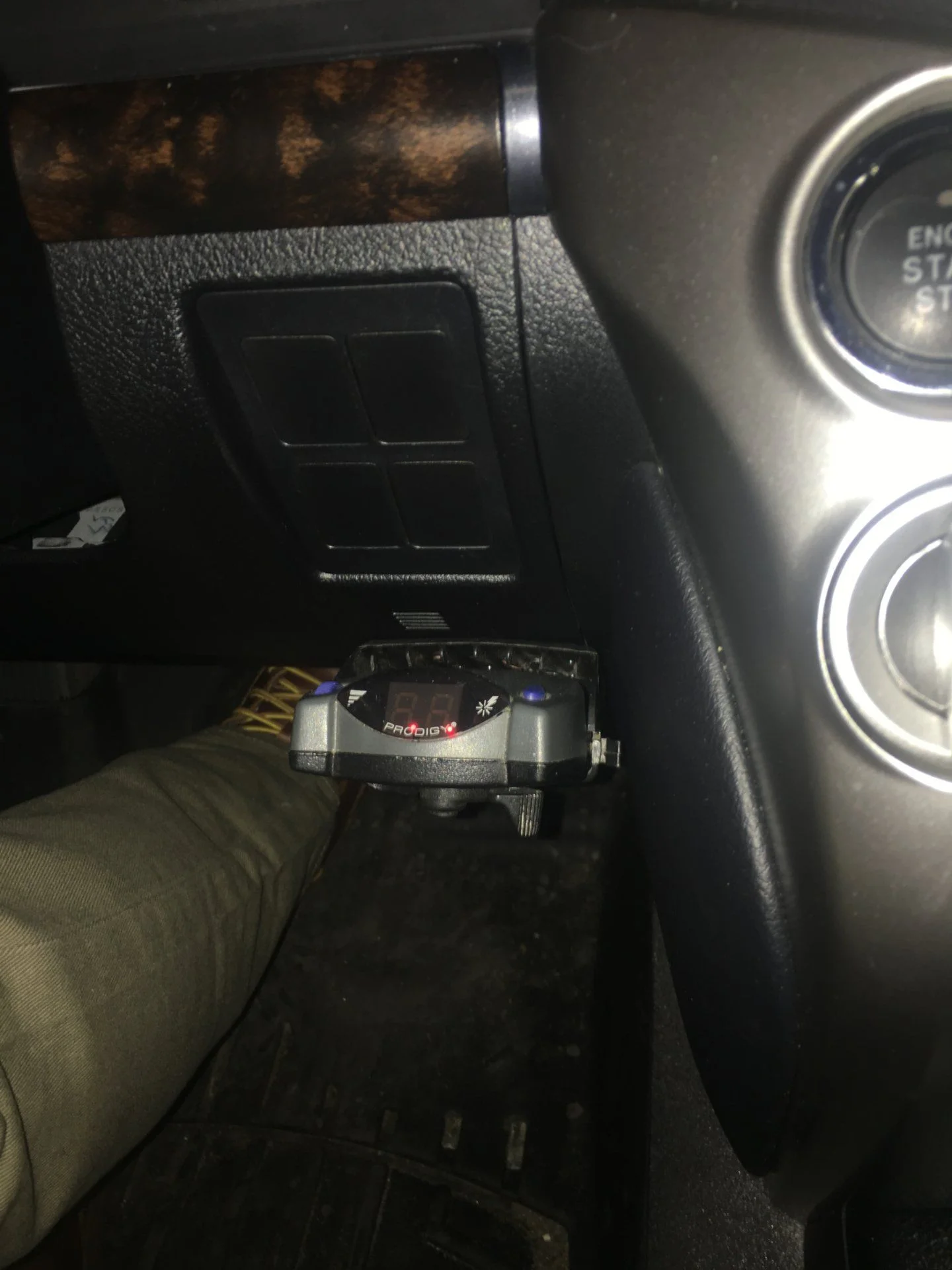

Just had local trailer shop install my brake controller. I watched him and it was a piece of cake. No issues at all and it works great.
Share a pic of the install please
Here’s a pic of location. I used 2 small screws to attach using factory drilled holes.
Thats were mine is as well
The plug is right there under the dash, you don't have to do anything to get to it. Where are they going to place the controller?
Regarding the controller plug, can you just reach up and plug into it with whatever toyota adapter is needed and your good to go? Anything to take apart to actually get to it or is it a reach up and snap it in, 5 minute plug and play and then mount it and you're set? I've never looked as my trailer is fairly light.
Install was easy. Took my trailer place all of 15 mins. If your trailer place seemed confused then maybe you need to find a new trailer place. ;-)
