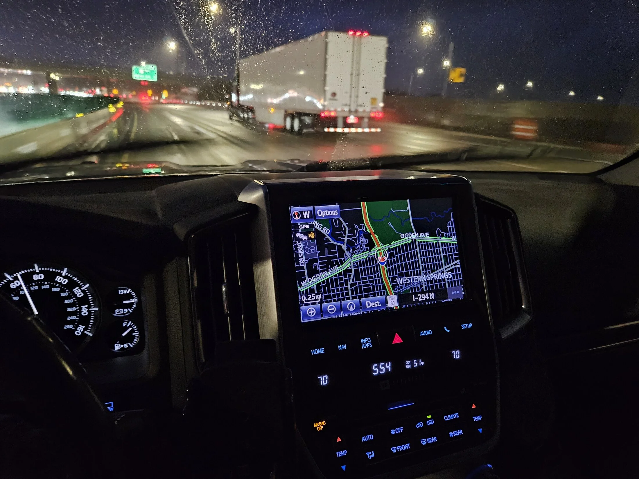

I just had my screen lock up near the end of a three hour drive in rain. 2021, 98,000-miles. I took a video showing it not responding to dash and steering wheel controls, before shutting down. Restarted and it works normally.
Warranty is almost over, and likely it won't happen for the dealer mechanics, hopefully the video will be enough for a warranty claim.
Odd thing: I tried tapping the nav display, and turning down the radio volume while driving. Several minutes later the screen responded to the tap, and volume went down. But no further responses.
And the phone video didn't work. I'll get this complaint in the system anyway, so if it continues hopefully it will be under warranty
