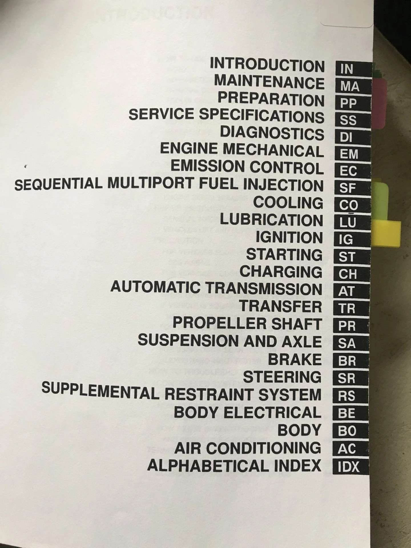

Here is the official maintenance schedule. Obviously you have to do some math. My guess is that after 200k most items are out of sequence so some fetteling might be required. In any case its a good list to work from.
See post 7
