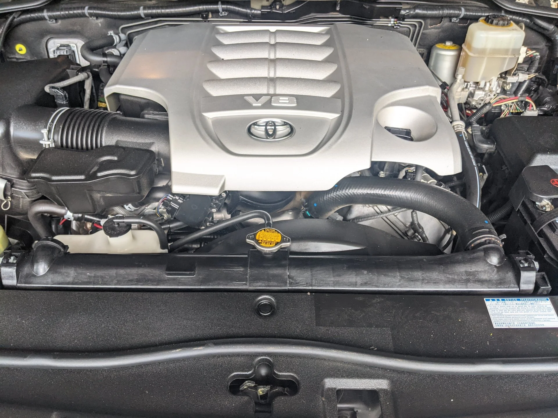

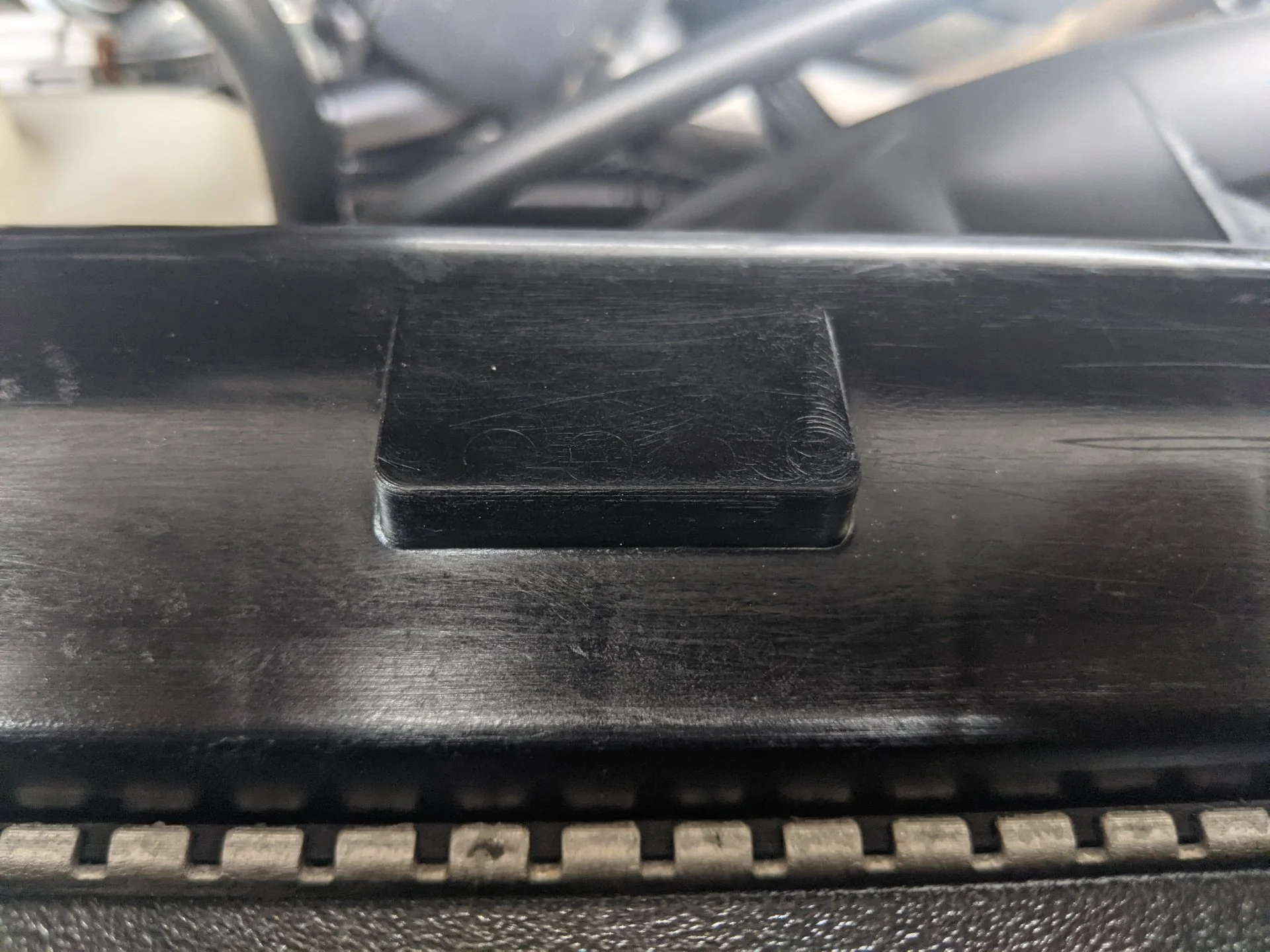

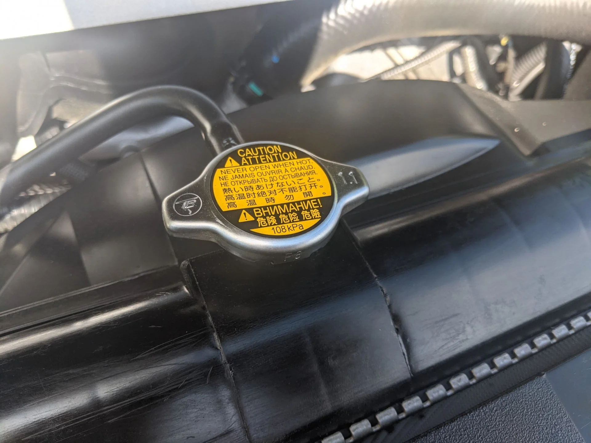

Can you post a pic. Is the rad cap oem?
The cap looks OEM. As you can see the radiator itself is unmarked where there would be the sticker and no raised or embossed letters on the unit itself either.
The failure mode documented in this thread is likely unique to the original OEM unit. Unlikely yours will fail in the same way.
Which is what would concern me long term. A low quality radiator might just let go entirely, and probably isn’t built to toyota OEM standards so who knows how far it will go anyway.
For me picking a mileage number and having a new OEM unit installed before then would be my strategy.. if 50k is yours that sounds reasonable.
I think that's what I'll do. I'm not overtly concerned about it right now but I'll keep an eye on it. I'm hoping it'll last another 50k miles which would bring it right up to the big 120k mi maintenance and change it to OEM. If it's still good by then at least I'll have a spare radiator.

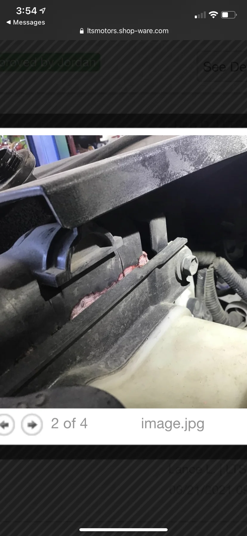

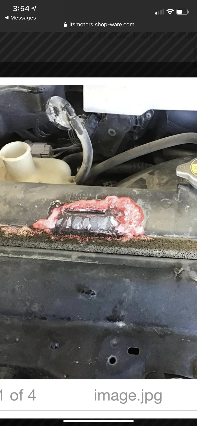

FWIW, I had a dealer replace my rad as part of an accident repair through insurance. The invoice and part number was OEM but the actual rad was not. Kind pissed about that but didn’t notice until I was doing some hose replacements. The aftermarket rad was leaking at the bottom after only 25k miles. The leak is in the AL core, not the plastic. I have just replaced it with OEM.
Given the mild PITA it is to replace (tranny cooler being the part that is a little painful if you loose tranny fluid), I’d keep the non OEM in there until it leaks and just keep an eye on it with an OEM one on the shelf ready to go.

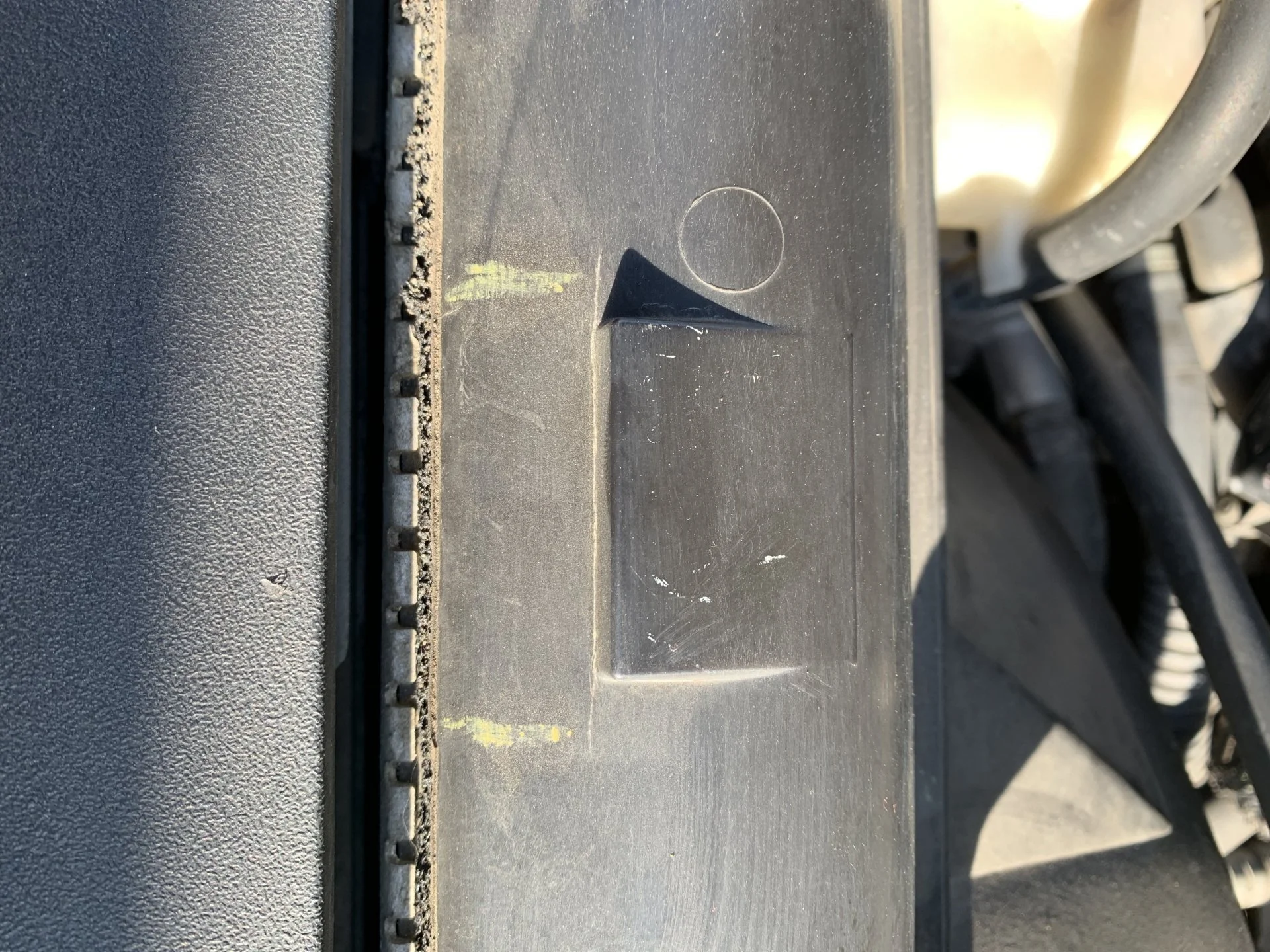

How long do I have? Yellow marks are from last summer. Crack is definitely spreading. This is on my ‘10. Original radiator. 167k miles. Thanks!
That’s what mine looked like when I glued it. Hasn’t exploded yet. . .
Hard to say. Could be a ticking time bomb, esp since it's still the original. Mine exploded around 110k IIRC.
At 167k miles, if you are intending on keeping the truck for a long time, I would shop around and replace it for peace of mind. And also gives you a chance to compare prices without having to worry about replacing it last minute.
