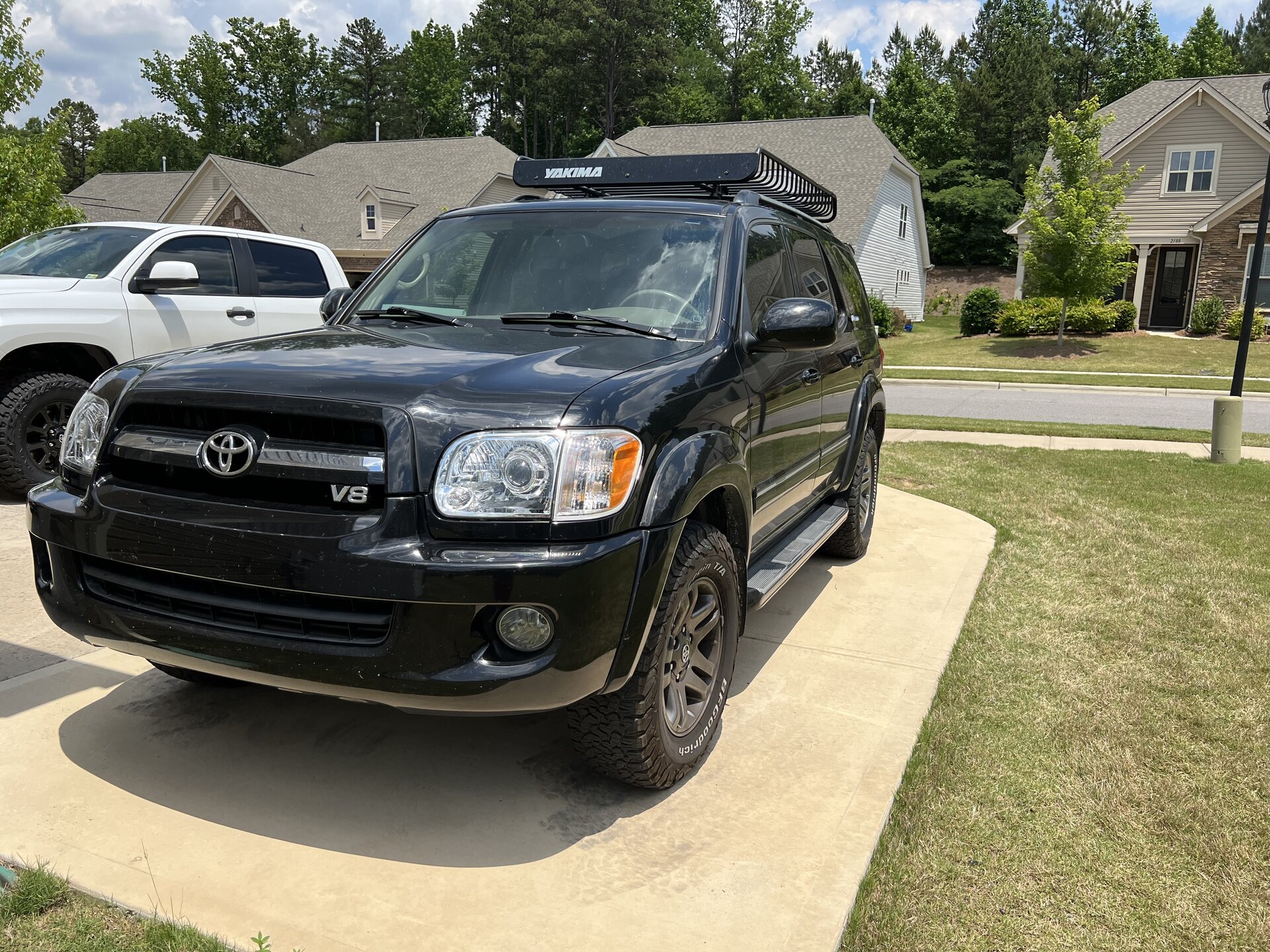

I attached a picture of what she looked like when purchased, and was super pumped to start building her out

As this vehicle was going to be used for road trips, I wanted a basket-style roof rack for extra storage. I decided to get the Yakima Megawarrior with the extension. Install was easy and Yakima products really are great quality. Yes, there are much cheaper roof racks that look similar but I was worried about rust and did not want to bother with frequently taking the rack on and off.

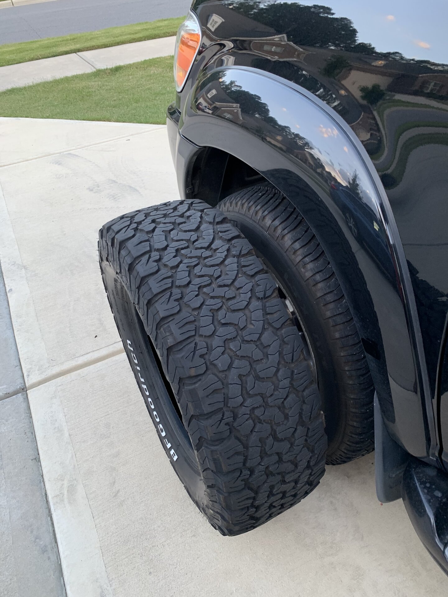

Wanted to get some beefier tires on as well, so found a great deal on some 265/70/17 BFG KO2s and slapped them on without any modifications.
